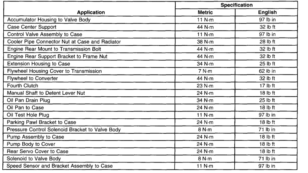

Just curious what you guys thought about using the Transgo separator plate???
I got a nice shiny new one sitting in the box if you want it.

Originally Posted by smokeshow
Welp, I got it all put together. Took a couple days to get parts. I hope you guys didn't make any typos, because I followed your instructions exactly!
Man, I hope this one holds up for you this time around. How much power were you puting down? Nitrous? No 1st gear burnouts, or letting off in second. Let off in 3rd. If this one fails, and you give up on the trannies, I got 2 backups
I got one too haha. I also did what Corey did with Corey's, Vince and Smokeshows favorite; Jakes Performance's Help.
It's 18 in/lbs that is sopposed to sandwich 3 zinc or galvanized steel plates together without gaskets in between. IIRC, the transgo plate seemed to have a rougher surface than the stock plate. I have heard from quite a few people that cross leaks can happen with the transgo.
Tune my truck Joe!
I give you mi best girl worker how, eh, Americanis call woman hoo wok throo allee way that give job of hand.
I wasn't putting down that much power. I've never been able to turn it up without it slipping or blowing through the converter. Also, spec said 97in/lb for the valve body...correct me if I am wrong.

Aw gay. no more turbo, no more problem? 97...hmm or was it 118 or something like it? I do recall 97. I know that was for the accumulator and seed sensor and maybe the solenoids/force motor?

So what your saying is...your good at photoshop? haha jk. So Jake confirmed only 97in/lbs are sandwiching those plates together.
