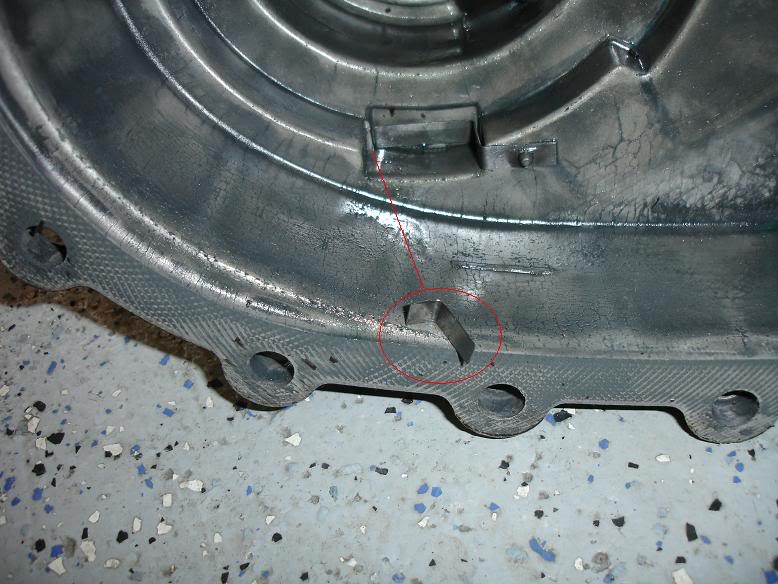

i'd like to make a change to the write-up. the new part number for the oil pump retainer/wear protector is 89059653 and is a new design. i posted pics from kysilverado of what it looks like.
The re-designed replacement.
Size:  71.4 KB[/QUOTE]
