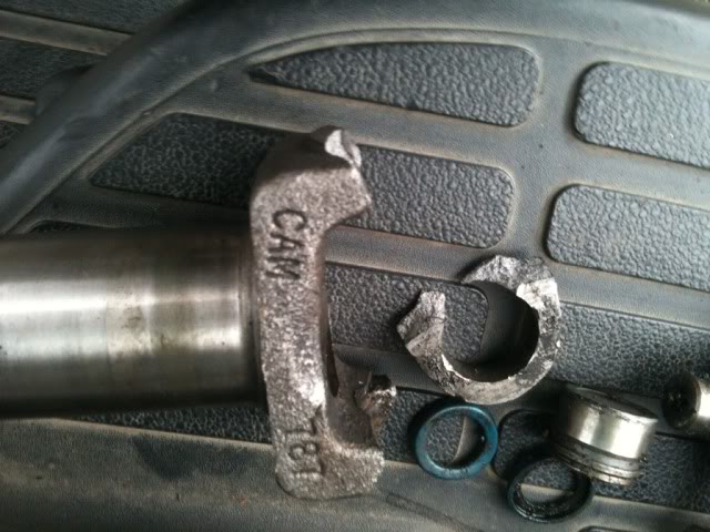

my yoke actually broke where it pins to the driveshaft, but I did not believe I saw any damage to the splines, but I ditched that tranny same time.
get a good yoke. that was a 4l80e yoke.

That right there looks like it was in a bind ha!

I didn't think I was pushin tha much power. ganna try and weld it up Friday we will se what happens
That's a bad idea buddy. New yokes are cheap compared to the damage a grenaded yoke can do. The welded yoke might not fail today, but it will fail at the worst time sometime in the future.
