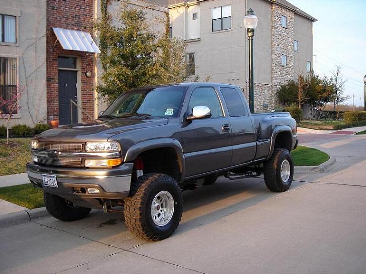

Whoa, that looks alot like mine, check it out. Same wheels, traction bars, color. Just mine is a procomp lift and Im putting 37s on it when these wear out.
Attached Thumbnails Th400 swap info/advice?-z71.jpg

lol, were almost twinkies.....nice looking rig though! Hey, are those the WARN fender flares? I been trying to find good pics of a stepside with WARN's because there the only company that makes flares for stepsides to my knowledge. I figured they only came out about an inch like those whimpy slimline bushwackers, but they actually look pretty decent on your truck. I got to do something because rock's and gravels are reaking hell on my paint, not to mention im tired of gettin freakin mud goobers on the top of my truck from just going down a wet dirt road.
BTW the 37" PJ's rock if your looking for 37's, they ride ALOT better than my 35" BFG's did and there really not all that noisey. I didn't even get them balanced and they ride better than my BFG's i had balanced. If you go to a Cooper Tire store, they can order them out of a place in South/North Carolina and you can get them a hell of alot cheaper than 4wheelparts.com has them for. I got my set of 4 for $1100.

Man I dont know what fender flares they are, they were already on the truck when I bought it. Thanks for the info on the tires.
