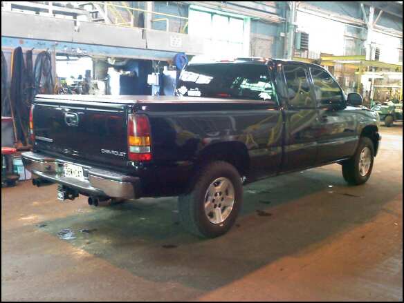

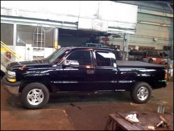

i got 1.5 from decranking the t bars and did 2 inch shakels and took the bloks off.. truck sits level all around.. i would think i got 3.5-4 from the rear.. im a ecsb 4x4

Old May 26, 2011 | 09:19 PM
05gmcsierra's Avatar
Joined: Mar 2010
Posts: 1,026
From: van nuys CA
From my phone.. quality not that great.. front is still high.. ill be doing purple keys on sunday and hangers later on ... drop it another 2 inches all around..

Cool, thanks for the pics guys! Those trucks look good where they are sitting.
Im likin what i see, i think the 2-3 rear and 1.5-2 front is be good for me.
Nice to see what my truck looks like already done with both 20's and the 17's i have ! LOL!!!
