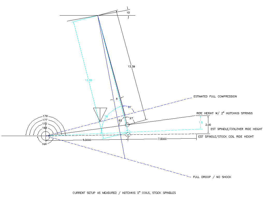

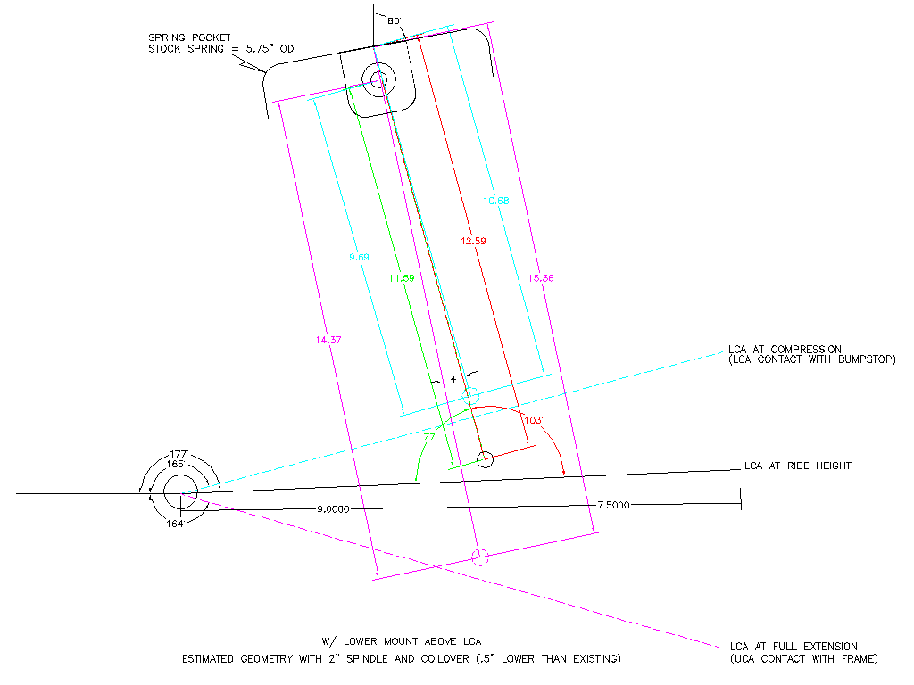

I modeled my current geometry in AutoCAD then simulated the proposed arrangement by lowering the end of the lca by 1.5" and moving the lower shock mounting position up .625" for a 12.59" shock length at ride height. That puts me at ~.53 comp/.47 ext at ride height with the additional height of the stud top. The 5.2 would be compressed ~75% at ride height based on my model. I also wanted the longest shock I could use without crashing on compression. I felt this was more important on a lowered truck vs having full extension. The uca can be mechanically limited to prevent unsprung weight from hanging on the shock when up in the air.
