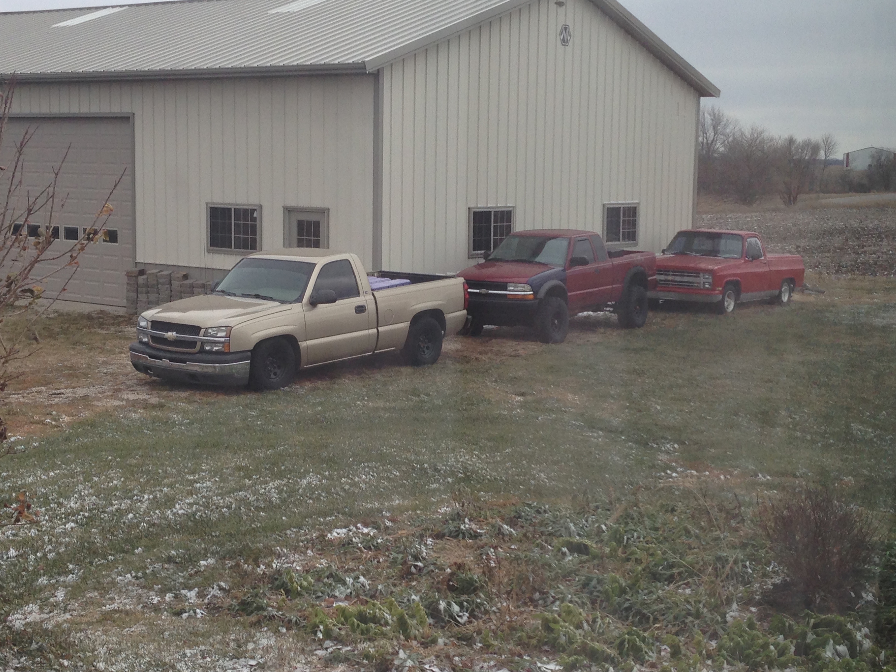

Im loving it. I have probably close to 2k miles on my setup. Just made a trip from NC to IL and back. Truck handled great! I did bottom it out on a hill back in IL. Only thing it did was spit out grease from the ball joints. I guess I put too much in. Currently I have 800# springs. I think I have the coil over set at -5 clicks from full stiff. I need to put some 900# springs on it.
Also, it does have a little bit of bump steer. But Im not worried about it now. Once I get the back finished I will take care of any small issues that might still be there.
If your ball-joint spit grease it may have reached its maximum limit (bad thing and can break it off!). Was it your upper ball-joint, or lower, or both?
If you are using stock UCA's, you may want to flip it and repress in the ball joint from the other side when flipped. This will give your ball joint a better operating range and minimize it ever hitting its limit when lowered. If left stock and lowered any more than about 3" from stock height, then the BJ sits at an acute angle. Flipping the UCA will get it close to a right angle when lowered to about 4"...
I had a thread somewhere about that when I did it on my Silvy. Easy to do and free. Also might want to add in some eccentric UCA bushings (both Belltech and Moog make some) while they are out too, and it helps give more camber adjustment back.
Just wondering what you had in mind to fix your bump-steer?
The bump-steer won't be caused by your coil-overs, more so the geometry of your suspension components (whether stock or aftermarket lowering parts) at your current lowered ride-height and how your toe/camber change through the travel.

Yea, I'm running then 4.1 shocks. In the rear I just have 2" lowering shackles. I think I went with Eibach.
Im running upper and lower strong-arms. It was the driver upper, and the passenger lower bj. I haven't had any issues since. I don't have any plans on fixing the bump steer now. I'll address it after I finish up the back.
