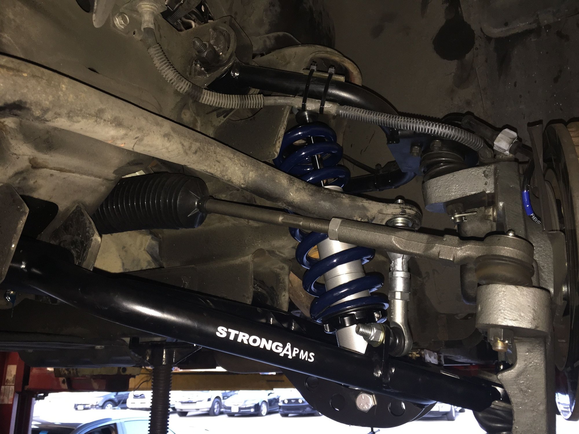

Originally Posted by TheBeeblebrox
Hard to accurately measure the difference between the two but the Strong Arms' mount is lower than stock, maybe by about 1"
Is that 1" difference to the bottom of the stock a-arm or the top where you had the other coilovers mounted? Does the strong arm also move the mount closer to the ball joint?
To the top where I have the coils mounted.
As far as I can tell the SA's do move the mount farther out than the stock arms, you can see in the first pic they mount in the smaller middle hole thats slightly raised.
I also think the SA's are a little bit shorter overall than the stock arms (balljoint is pulled in a little).
I'll try and get some better measurements when my new shocks come in.

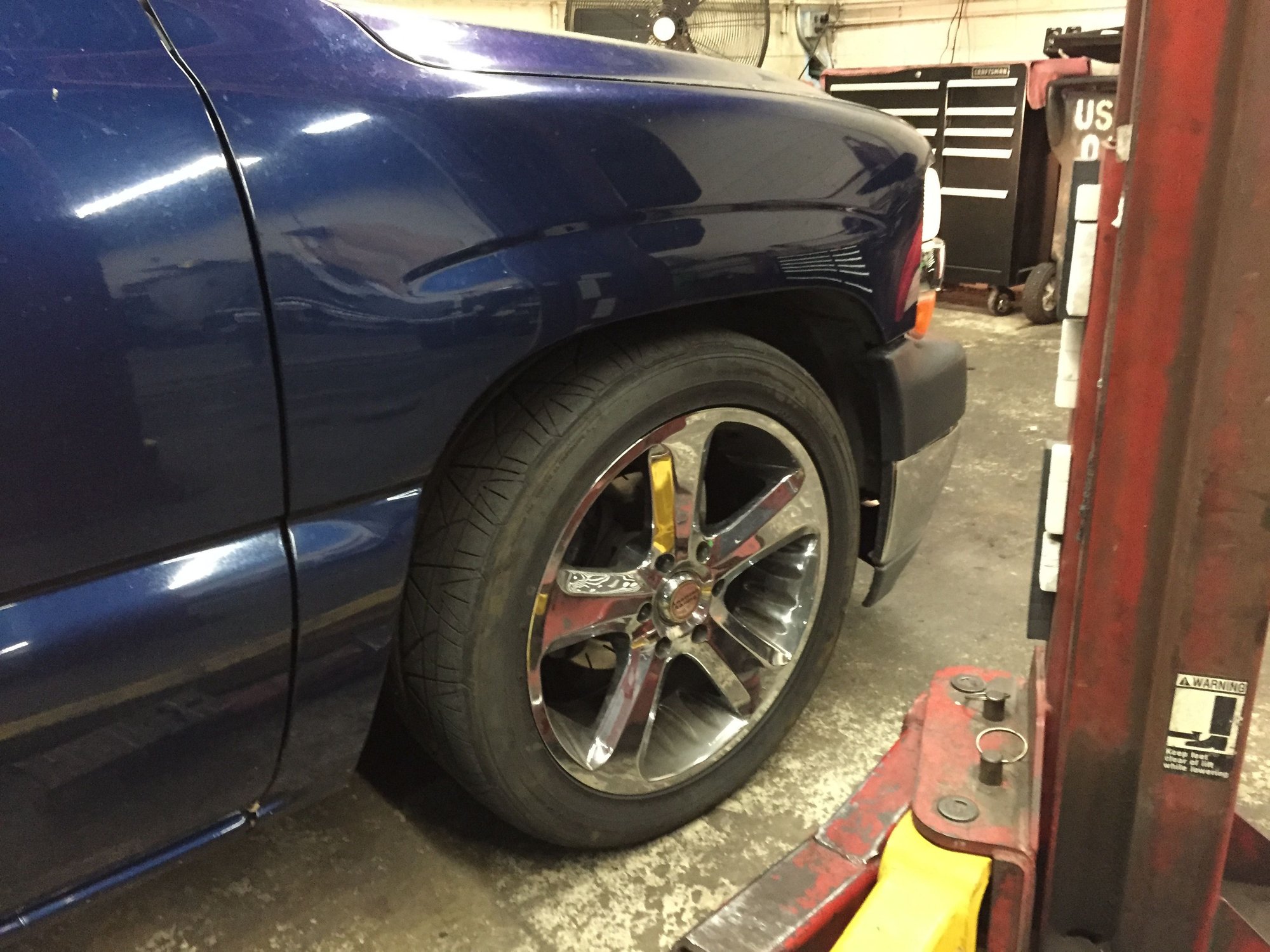

Finished up last night
No more rubbing!
So far I like it a lot better than before, I'm still using the 10"x900# springs and they are pretty stiff now, could also be due to the new sway bar end-links, regardless I would like to get longer springs because these are adjusted way up and hang free when lifted off the ground, just minor things for peace of mind.
No more rubbing!
What size shocks you running now? Might want to look into helper springs to keep the spring in the pocket
