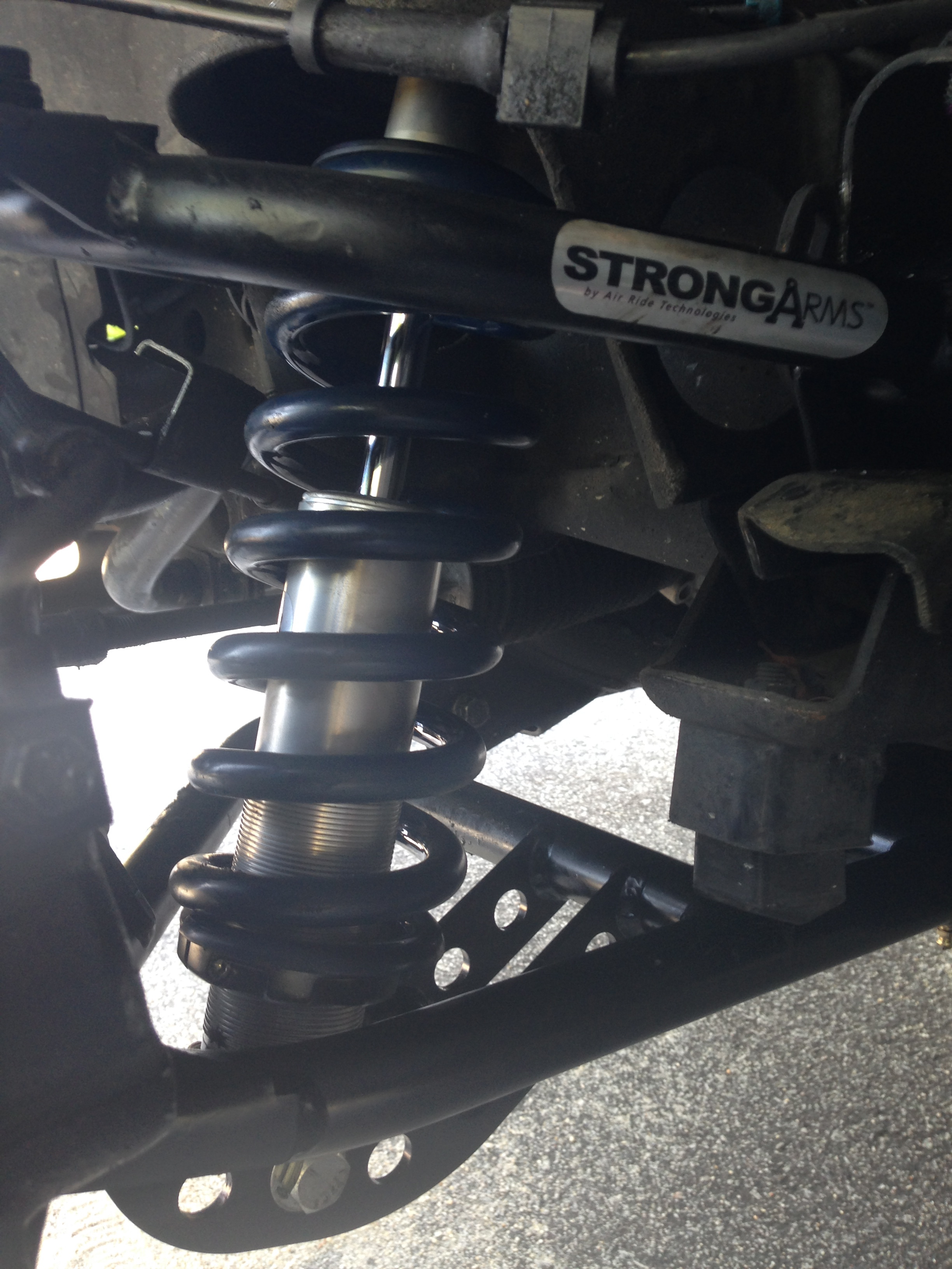

Im using ridetech upper and lower strongarms, 4.1 adjustable shocks, and 800# 10" springs. The ride is great, but it does need a stiffer spring.

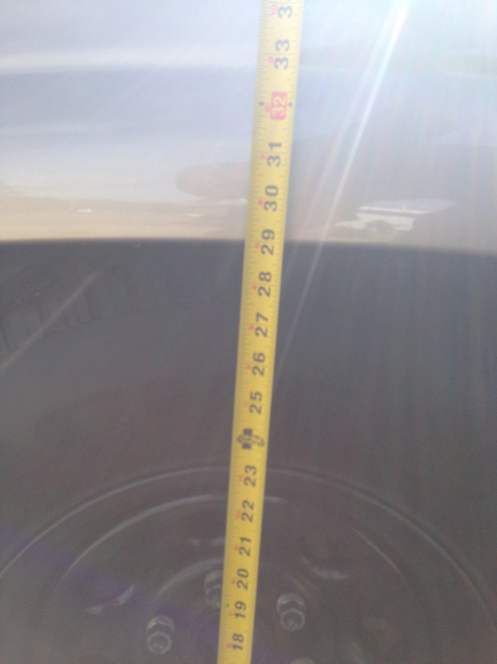

So here's where I'm at now, ran out of time and motivation to mock-up the lowers, so that will be sometime next week.
Running just the upper arms for now
Compared to stock
I don't like that they don't come with provisions for the brake line, so I'm going to have to drill and tap my brand new arms. <--**** that, zip ties ftw.
Side note, going from the McGaughy's to Belltech spindles lowered my truck a little more, I don't think the balljoints seat properly on the McGaughy's.
Old Apr 29, 2015 | 10:01 PM
  #300
TheBeeblebrox's Avatar
Joined: Jun 2012
Posts: 212
From: Southern California
Finished the mock-up today, going with the 6.3" shocks (I'm raising the truck up an inch from the current ride hight for more clearance/less rubbing).
Hard to accurately measure the difference between the two but the Strong Arms' mount is lower than stock, maybe by about 1"
