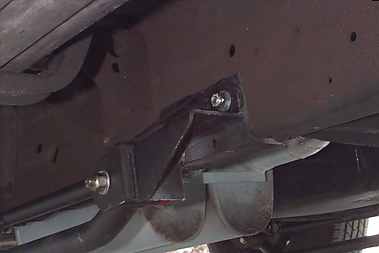

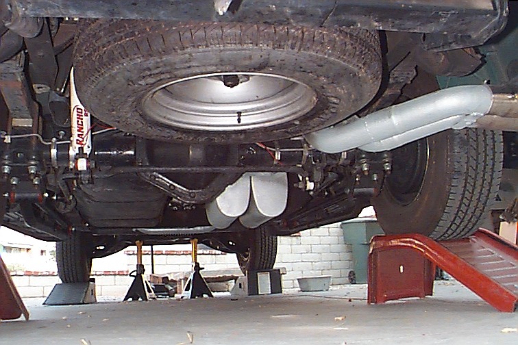

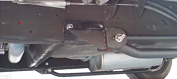

I've been running them for years on a stock-height 2WD frame. You'll have to get a little creative with the front brackets, the rear ones intended to be mounted between the axle and spring can go under the axle with longer bolts and some grade-8 washers. Better leverage that way actually.
Any lateral bars that can transfer PUSH directly to the frame without going through the leaf springs is better than anything else. The suspension cannot load up with bars.
These brackets were intended to mount under the frame, I swapped sides and put them on the outside on angle iron with a gusset at the top. These are old photos.
Very old photo...
