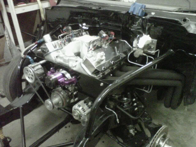

I have had 2 setups and both worked very well, The rear is the same as yours basically, ladder bars with qa1 coilovers, the front setups were as follows:
sway bar removed, Moroso trick springs for a big block chevelle and QA1 single adjustables. worked great, almost too good, stood on the bumper a few times 60ft was around consitant 1.45 to 1.50
new setup is air ride tech a-arms modified to accept coilovers in the front with aerospace brakes, doesnt have the wheel standing wow factor like the trick springs had, but is alot lighter setup and consistant. pulls the front about 1 1/2' and carries it out. have been 1.35's with this setup
I have also heard of some of the 454 guys going with the qa1 coilover conversion kit for chevelle.
here is a pic pf my current setup

Great info man i have been looking for a way to get rid of these stock upper and lower control arms and find some bushings that will free the front end up a bit..... I like you wheel standing setup, do you think if i kept the stock upper and lower control arms, replaced with polyurethane bushings(Will this give me better movement?), reused my 2" lowering spindles, got the new moroso springs and qa1 shocks......will this combination work ok or is there some reasonably priced upper and lower control arms out there? Thanks man
