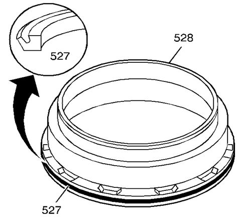

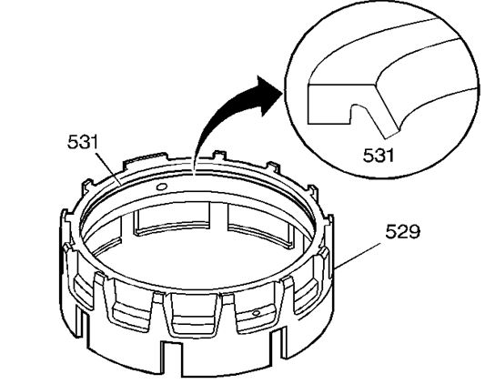

Look at page 111-112 of the manual i gave you named 4L80E overhaul

I haven't worked on this in a week or so since I started my new job. I need to find a drill bit to drill the bleed hole in the direct drum, and order parts. I'm for sure going with the brake, billet input, and billet forward hub. Jake told me not to order the trango kit as his valvebody is already set up the way he likes it.

Leaving the seal off of the center support part of doing the dual feed.
Yes I left the second center support ring off and the center seal out of the direct drum. Jakes brake feeds both sides of the center support so no plugging is needed anywhere.
