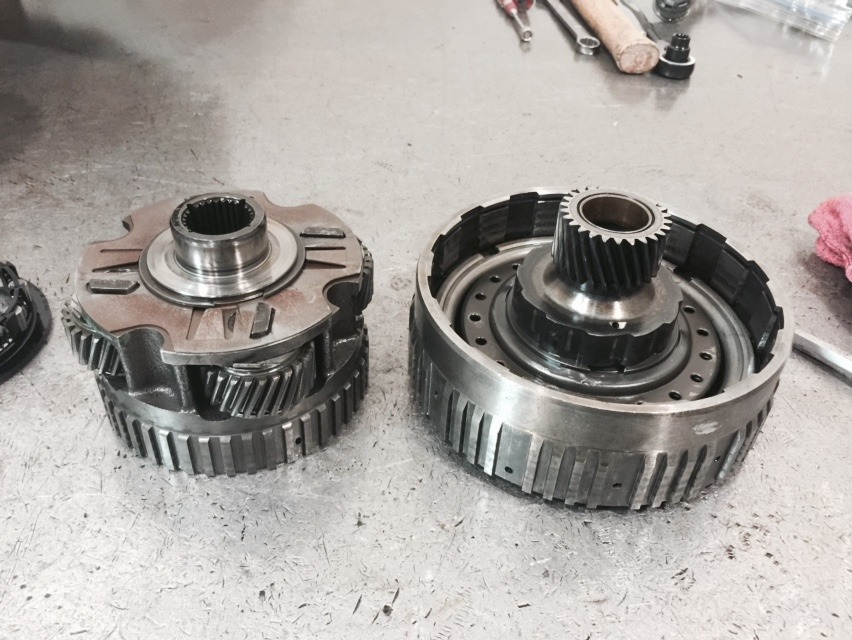

Does everyone completely disassemble the sub assemblies? Any reason to take the over run assemblies here down anymore? Or should I just soak and clean them as is?

I did.
