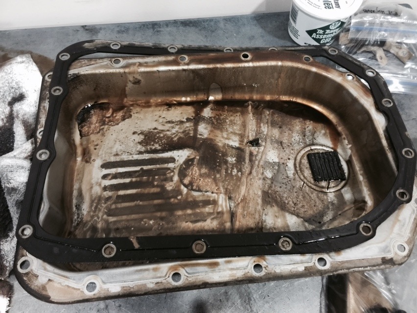

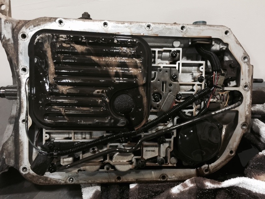

Got the pan off and it doesn't look too bad inside I don't think. It is kind of milky but doesn't look as dirty as I've seen some pictures.

Yes that is an in tact bug that was just hanging out inside the pan..

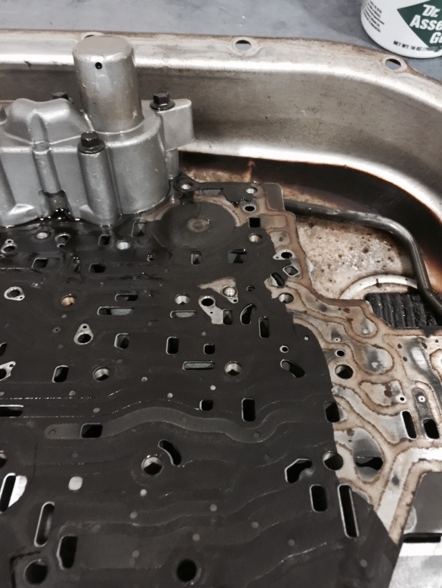

Got the valve body off and all the check ***** out. All of them came out fine except this one was pressed into the separator plate for some reason. Is that normal??

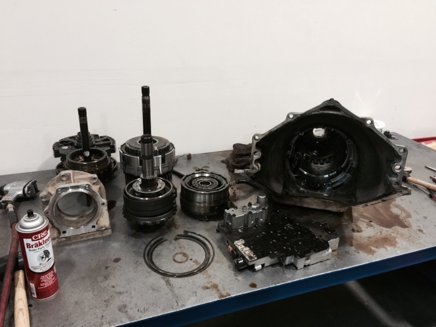

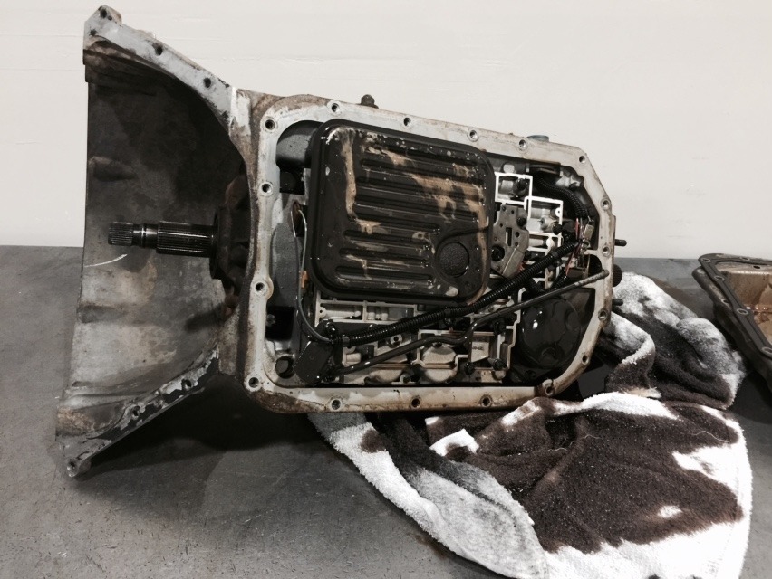

So here is where I'm at now. I keep getting distracted. I'm going to do the rest of the tear down right now.

I suggest using an old brake rotor to put the tail part in when you unstack it. It keeps everything up right.
To do the valve body stuff you can put the trans on an engine stand.

Well, that was extremely easy. Any monkey can tear a 4L80e down. Not nearly as many parts as I thought there would be on tear down. Now I will figure out a way to get everything cleaned up as I don't have a parts washer anymore. I'm sure the hard part is putting the sub assemblies back together so I'm looking forward to learning that part. I love this crap.
