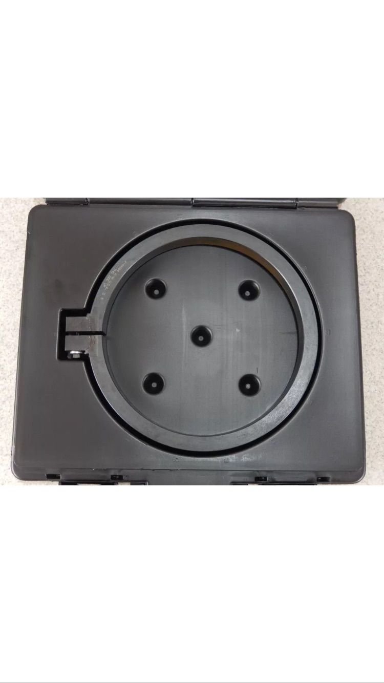

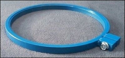

The gm version of the pump alignment tool for the 6l80 is metal ring that has a step on one side to fit over the lip of the conterter housing and center the pump, using the bolt in the side of it.... I have been able to bolt the pump down before forgetting about the alignment tool, and it was damn near centered, hardly moved when i put the alignment tool on it! if they had put another dowel in the pump it probably wouldnt have been an issue never understood the point of one locator dowel...
Old Jul 2, 2016 | 02:35 PM
  #74
Wolftrk99's Avatar
Joined: Jun 2013
Posts: 5,492
Likes: 48
From: Virginia Beach,VA
Theisbis the kent moore gm tool
This is an aftermarket version that you can see the lip if you look close enough
