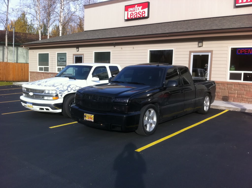

Here's an AWD SS that has keys & spindles up front, and a flip kit in the rear with a notch. We did a few extra things up front for wheel alignment.
Overload was left in place, no axle wrap problems, no traction bars.
