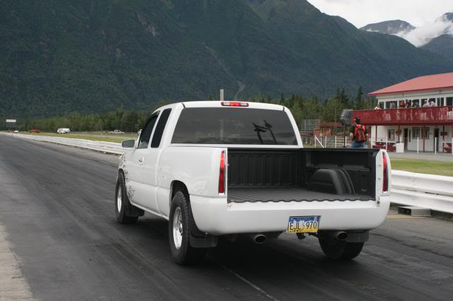

I dug up an old pic of my half ton 4x4 for reference. Front drop is keys, cranked all the way up. Don't remember the brand, but sounds like you may have the same ones. Rear drop is blocks removed, shackles, and overload leaf removed. I added Cal-Tracs for the spring wrap, and one-half turn of preload on the bars. This is the end result.
I have lots of pics from different angles. Tires in this pic are 275/70R16, which is a 31.5" tire IIRC.
