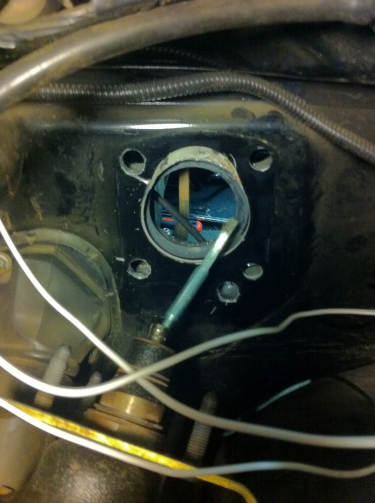

Originally Posted by banker099
anyone else have to cut the firewall to get the booster to fit flush on the firewall?
looks like im going to have to cut the top part of the hole to make mine fit
I had to trim mine.

Old May 10, 2012 | 11:08 AM
  #74
banker099's Avatar
iTrader: (20)
Joined: Mar 2008
Posts: 582
From: TX
yeah, i trimmed mine too, everything is done now just have to bleed the brakes...hopefully the ABS module wont give me too much hell...
