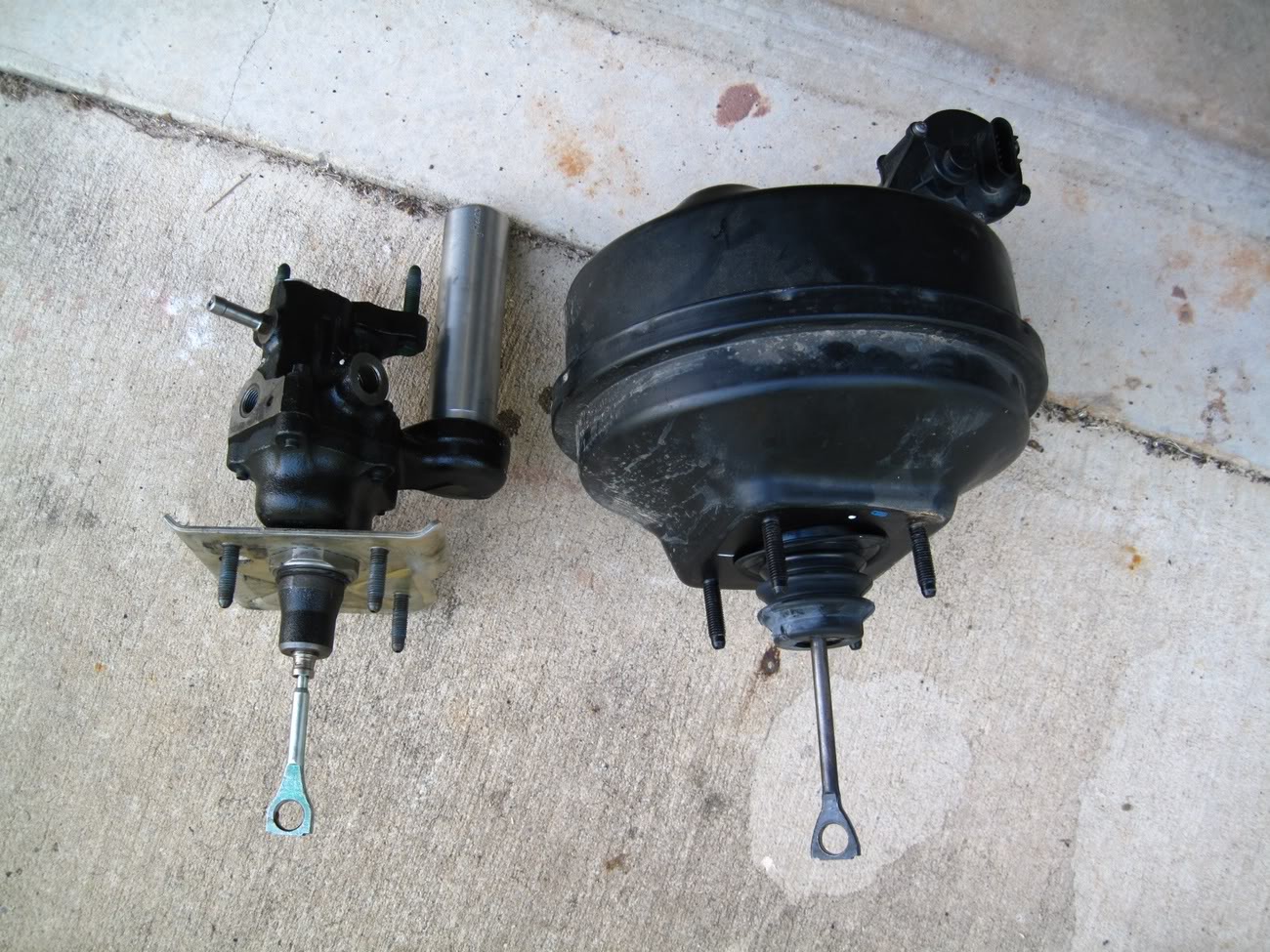

Remove vacuum booster and drill hole in firewall for the offset bolt of the hydrobooster.
-Once you remove the nuts from inside and disconnect the rod from the pedal, there is nothing holding the vacuum booster on so with some wiggling it will come right out. Put it aside and sell it on ebay, you will no longer need it.
-Now you may notice that your hydrobooster has one offset bolt from the other 3. You have two options: either drill a hole in the firewall where there is a dimple (see above pic), OR try to press out the offset bolt and drill your hydrobooster mounting plate. I tried to press the bolt out but wasnt having any success so I drilled the firewall. Either option works fine, except if you drill the firewall you will need to cut come rubber to place the nut over the bolt, or leave it un-nutted (ha), your choice.
Notice how much smaller the hydrobooster is, definately a space saver.

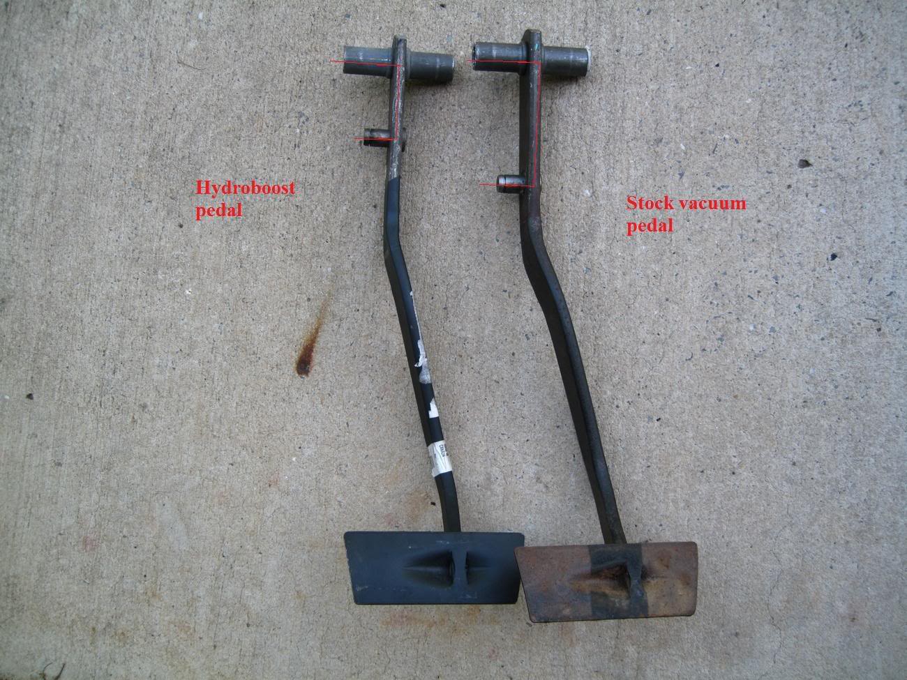

This is why you need the new pedal:
Notice the position of the rod stud in comparision with the top of the pedal. If you kept the stock pedal, your pedal would stick out past where it should be making it very uncomfortable and difficult to press. It is in your best interest to buy the pedal since modification of the rod will most likely destroy your booster.
-The mounting bolt for the pedal only goes in one way, right to left (nut on left side), so dont sit there for 10 minutes wondering wtf is going on before test fitting the bolt without the pedal in the way and realizing you had it backwards the whole time, mmk?
-Reinstall the brake sensor and rod to the pedal using the clip you removed earlier, except this time you press it over and slide down so its locked in place.

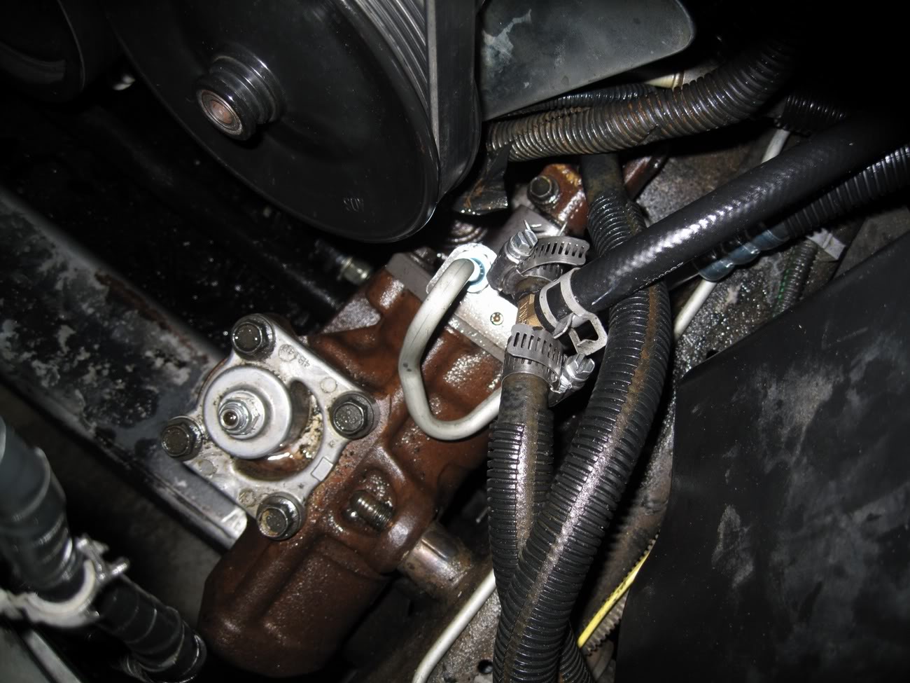

- Now the pump shouldnt be attached by anything but the lines. You now need to turn it over to get to the back since thats where the hose attaches. I found the easiest way to do this was finagle it upwards so its near the alternator. You will have to maneuver around electrical wires and hoses, but it is doable once you get that angle you need.
- Once you get it up, you will be looking at this:
You will need to remove the hose that comes out of the back and goes to the gear box.
- When that hose is removed, install hose number 6 from the parts picture at the top. The end with alot of bends goes to the pump. It will be obvious since these bends allow the hose to be routed safely around everything.
- Reinstall the pump the same way you took it off. Dont forget that ground wire on the side bolt or the bracket on the front. Press the pulley back on and reinstall the serp belt.

- This line is very low pressure, as in a few tablespoons when you let off the brakes and a slight drip whenever else, so this is why you can T this without a problem.
- You can either attach it right before the pump after the cooler, or right after the gear box before the cooler. I chose to do the later.
- I used a razor blade to cut the line (make sure you cut it straight!) about 6" from the gear box to give the fitting enough room, and attached my 3/8" T fitting in between the two halves I just made and secured it with clamps, making sure the perpendicular side of the T was facing the booster. The flow from the gear box to the cooler should be a straight line - use the offset prong for the booster return.
- I ran my low pressure return line to the open prong and secured it with a clamp.
At this point all lines should be connected and all bolts tightened, so it looks something like this:
