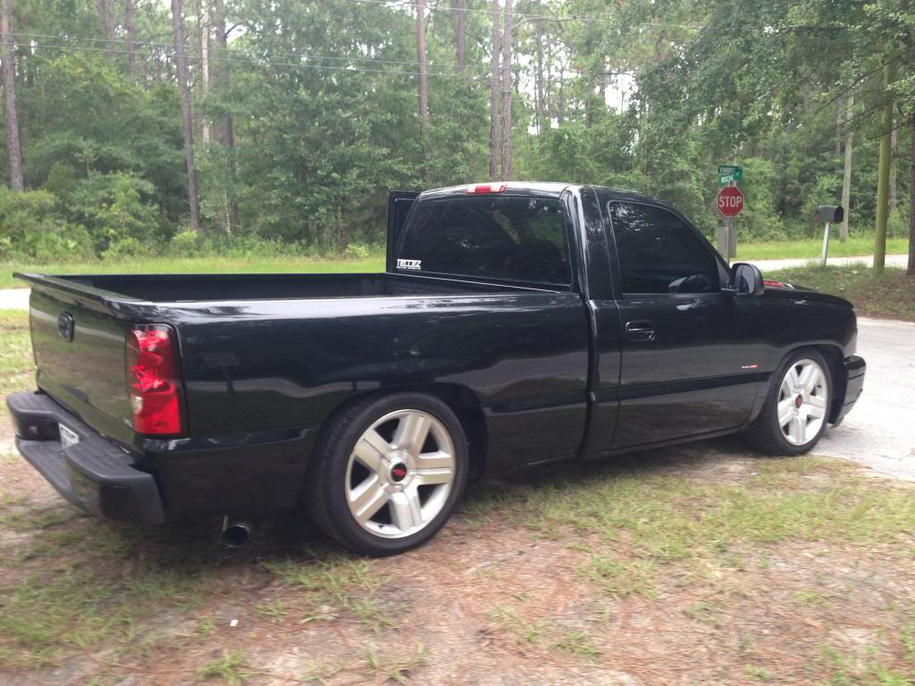

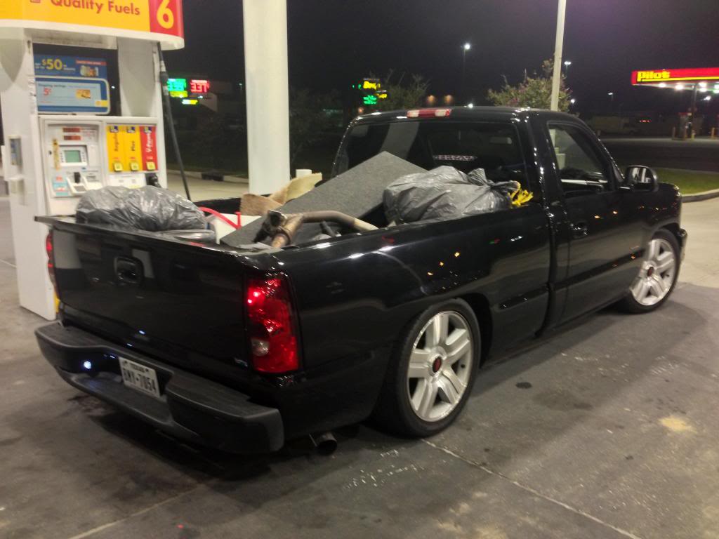

Bumping an old thread but here's what I did to mine it's lowered about 5.5/8
Front consists of: McGaughy's 2" Spindles, 3" keys decranked, and DJM UCA
Rear: Flip kit and 2" drop shackles. With 255/45/R20 tires up front It measures 28.5" from ground to Fender.
So far I've put about 3k miles this low, Only problems I've had Is that I had to remove the front bump stop and it'll still lay the cap on the LCA so I cut it off, and one of my Upper ball joints broke(that's when I went with DJM UCA)
I haven't taken a good look at my rear driveshaft about having to get shortened but I do get alot of wheel hop at WOT (guessing due to the crappy air shocks)
It gets the job done full of cargo with the airshock around 150psi.
W/ 80psi on shocks

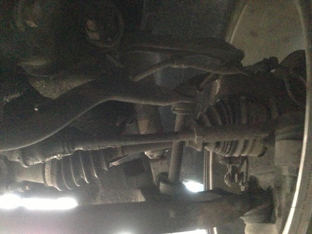

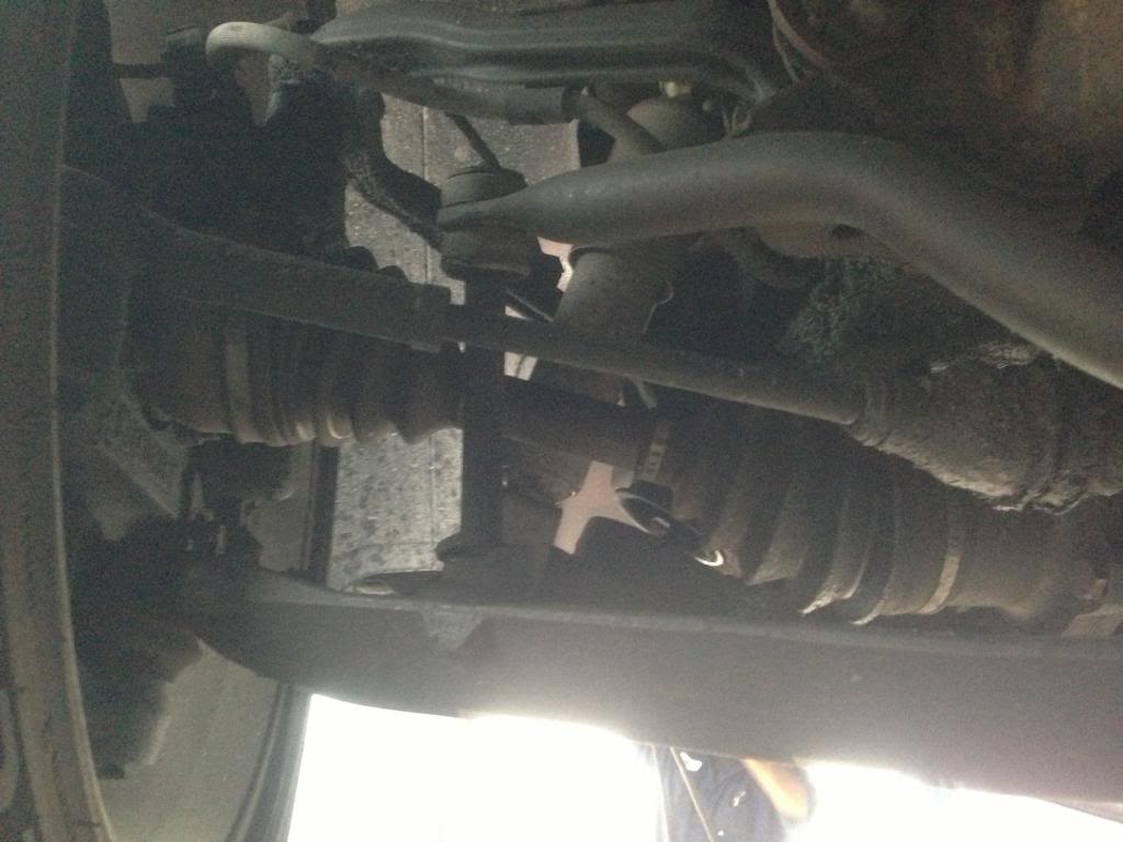

This is how my CV angles used to look before I went a full inch lower
Passenger side
Drivers side
