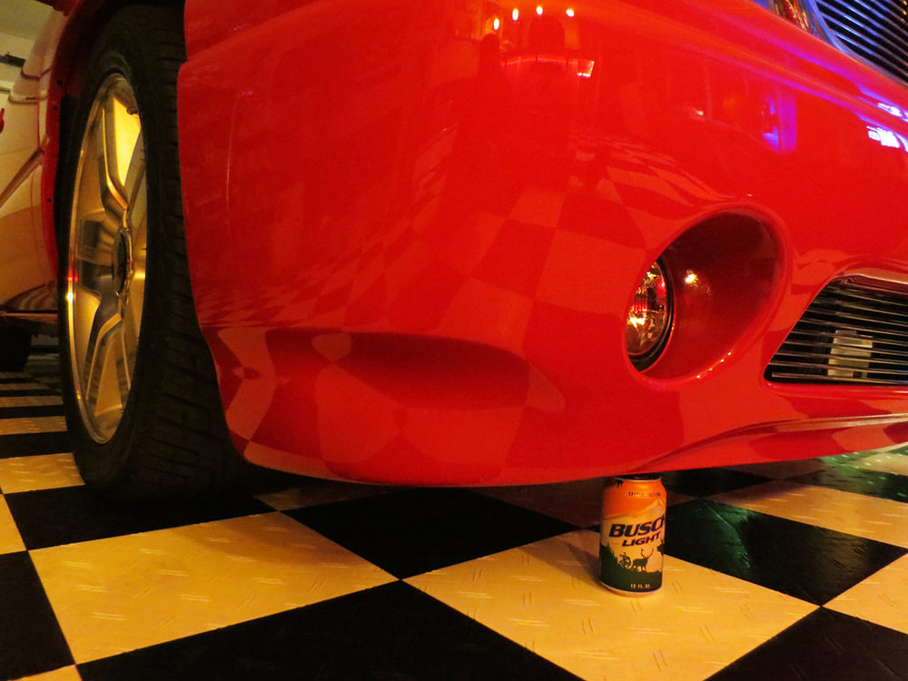

Trucks looking good and that is really low! If the Belltech front drop is 2" springs 2" spindles... you probably could have done one or the other and it would have sat perfect. It's that smaller diameter tire but I don't know if there are many 15" options for a larger diameter and the width you have. Parking stops become a challenge it's like parking a corvette lol. I haven't bottomed the crossmember or exhaust (yet) but with the Denali front bumper I installed it's pretty low. It's been on about five years and to be honest I can't believe I haven't fubar'd it on a parking stop yet
