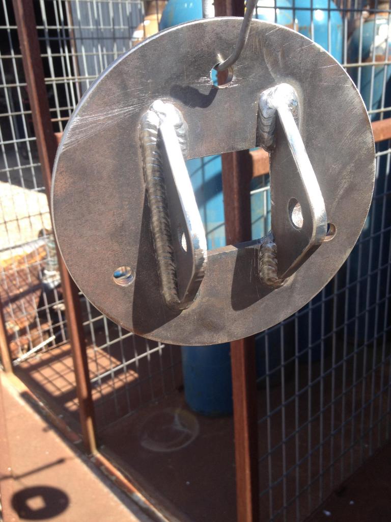

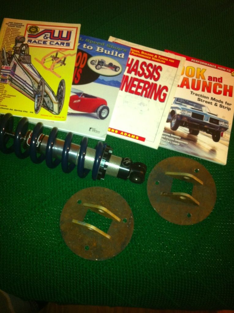

This is what im working on my truck but im also take the leafsprings off and building triangle link in the rear. Cut from a WaterJet

X2 you can buy them... I built my brackets because im in the process of redoing my suspension on my truck.
