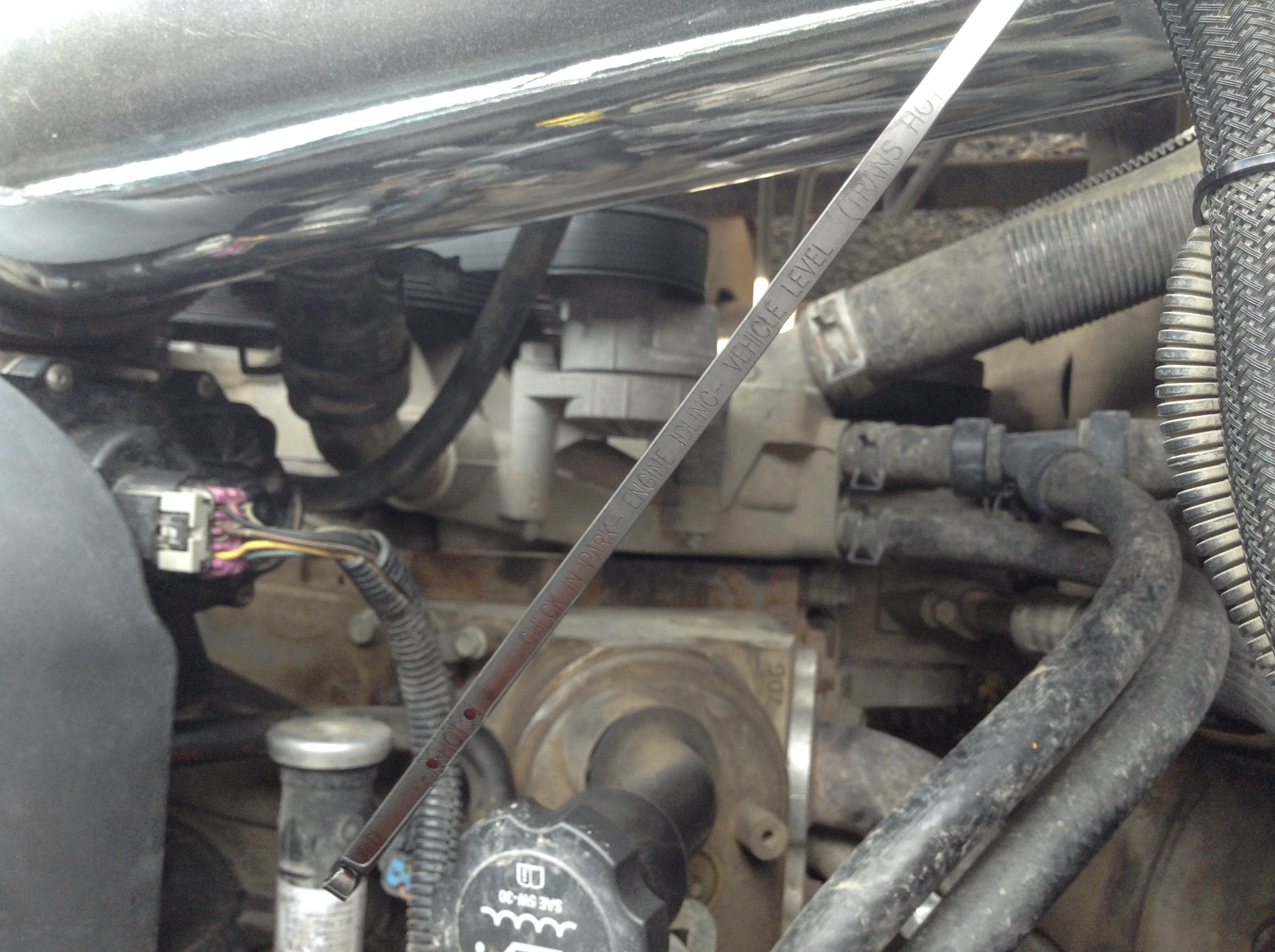

I haven't touched the transmission fluid, I bought it with a built transmission. Last owner said he put the tranny in around 7 months from when I bought it. I added the mods in the first 2 months I got it. I've had it for 4 months so I think it could need a change, let me go take a picture of the dipstick.
Old Apr 24, 2016 | 12:48 PM
Furdkiller's Avatar
Joined: Mar 2016
Posts: 143
Here it is.
