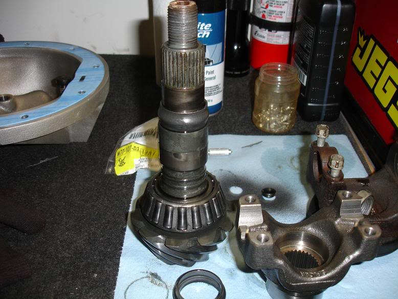

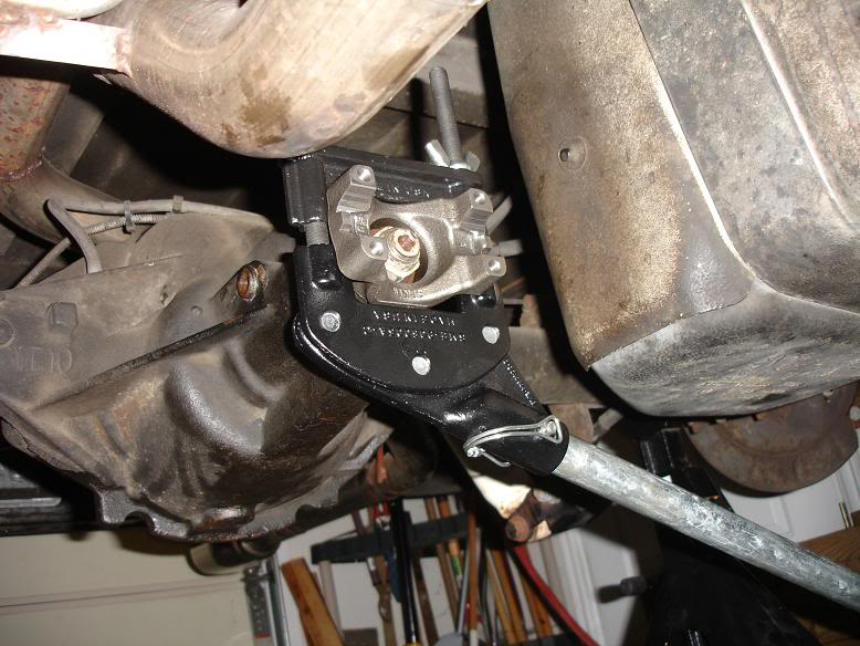

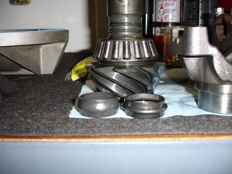

Getting impatient. I have crush sleeves on order. Didn't show up today so I went to the dealer and picked up a new sleeve.
GM Part # 8.6-10Bolt Crush Sleeve - 12479162 - $10.71
Install the new sleeve on the pinion and feed it back into the rear end from the rear. Install the the new pinion yoke and washer. I started the OLD nut and used an impact to pull the pinion and yoke together for a bit and then removed it. Lube the washer and install the new nut. I used the impact to slowly torque the nut down until there was no more play in the pinion. Drive the gun for a second, stop reach into the diff housing and the other hand on the yoke, push it back and forth to check for play. I stopped when I took up the play.
From here, when I get the proper torque wrench, I'll slowly torqe the nut little bits at a time and check the rotational torque until I get between 10 and 15 in/lb required to spin it.
Old crush sleeve right, new left.

New tool I picked up to help with this stage.
New crush sleeve on, new gasket on cover in background.
vary nice, i like that you are using all the proper tools and not riging everything, i just ordered the c-clamp for the torsion bars from me matco dealer today, expensive but a must have!

A tip I got was to crush the sleeve in a press just enough to get it started. It is damned hard to crush it from scratch with the diff in the truck.
You'll need a big bar on the socket wrench and it's a PIA because you have to crank, take that nice clamp off...check preload and repeat.....about 30 times. Go to far....new crush sleeve and start again.
Great tip. I'll remember that the next time. Yes just about anything you do from the floor would be much easier on a lift. This included. Long bars and no room to maneuver them. What I lack in equipment I make up for with persistance.
