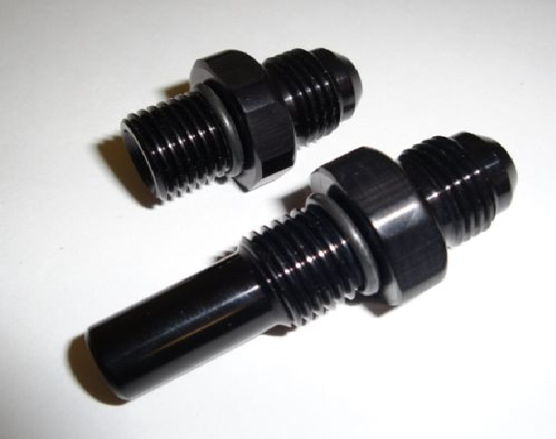

oh and i ordered the -6 fittings that everyone else is using but i noticed the rear return fitting has about an inch or so of tubing that comes off of it. the -6 fittings i got are both the same and match the front fitting. is this going to be an issue?

Yes, you need a matching long rear fitting like these: (if not you will burn up the trans)
I'm also gathering parts for an 80e swap in my ecsb, got those fittings off e-bay

some beach I thought it was wrong. I wonder if I can return the set I bought. ok I just ordered another set from tci. cost me 40 bucks but I want to get this installed this weekend so ebay is not an option. I can have it by Friday if I ordered from summit.

If your tranny is a 99 up it needs that nipple on it. If it is pre 99 it doesn't use that nipple. That nipple goes into the center support and lubricates the rear of the tranny. If you dont use it, chances are you will tear up some parts due to lack of lubrication. Ask me how I know. Lol. The transmission year can be distinguished by the location of the fittings on the case. Close together is earlier, farther apart is later.
