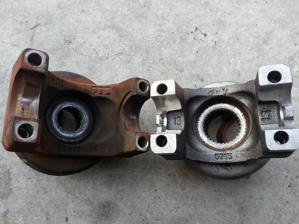

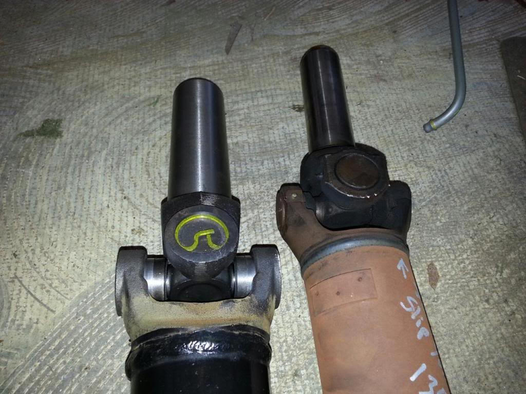

when i did my 4L80 Swap i went with the full 1350 Joints from a new 3/4 truck, here is the difference between what the yukons/tahoe have and what i upgraded too,
I think they could cut your drive shaft and put in a 1350 yoke. you could go that route or a Custom Drive shaft like mine
1350 vs 1330 Yokes

and i used the regular dip stick from a new HD 3/4 truck. Hope this works

As far as yoke, it depends on which year transmission you have and what application it came out of. You can get a bastard u joint that will convert it from your current shaft to 1350. You may need to get your shaft shortened.
