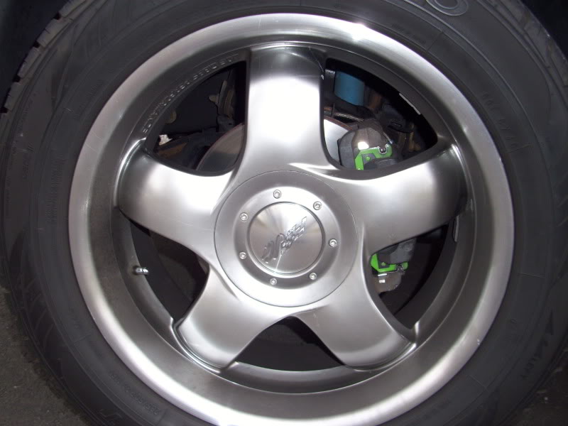

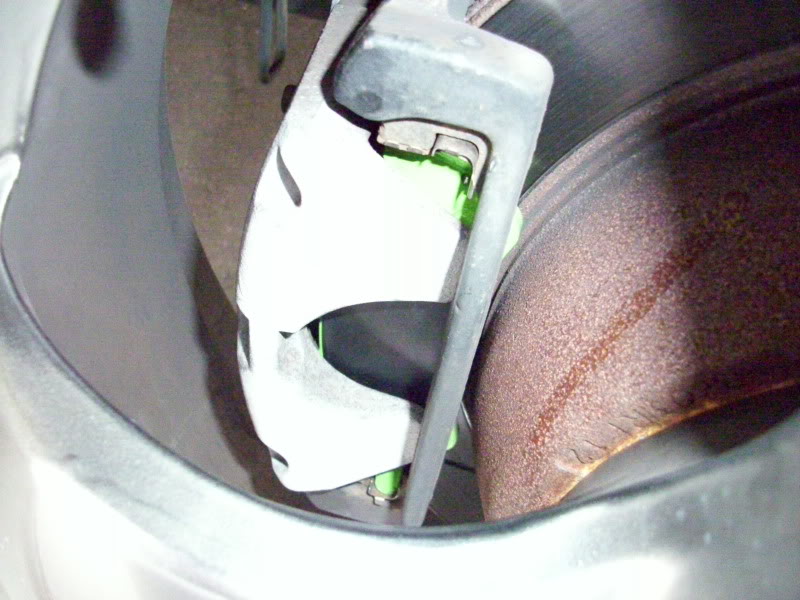

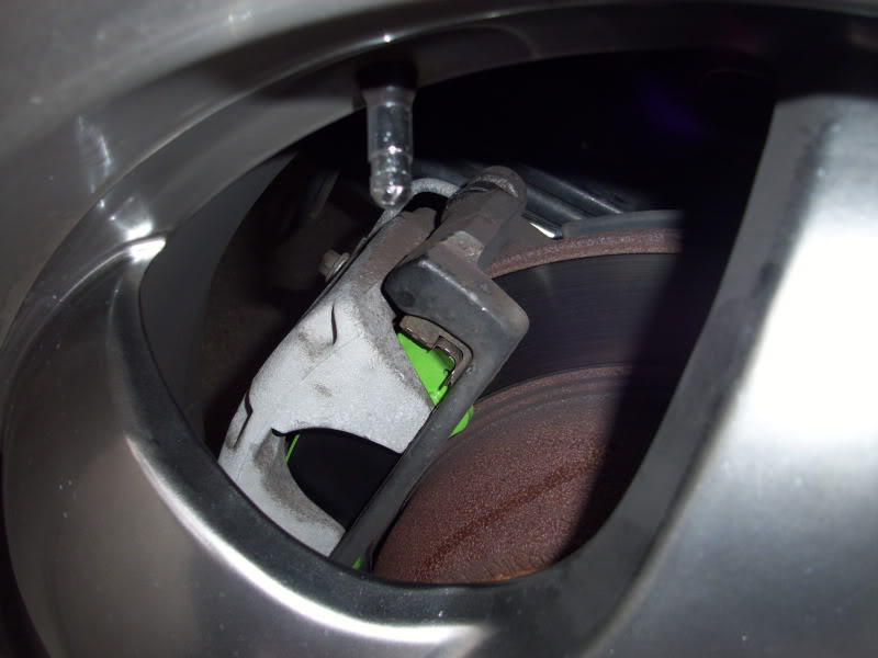

*EDIT* Added pics when I pulled the wheels back off and cleaned off the Permatex Nickel Anti-Seize and lubed the sliders with CRC Synthetic Brake and Caliper Grease instead:
