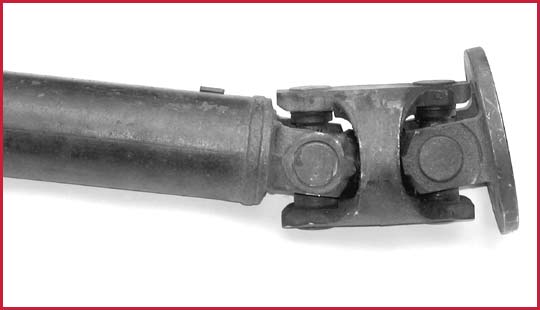

Look into double cardan driveshafts. They don't have vibration issues and aren't too picky about angles. Pretty neat.
wolftrk99 told me about em
