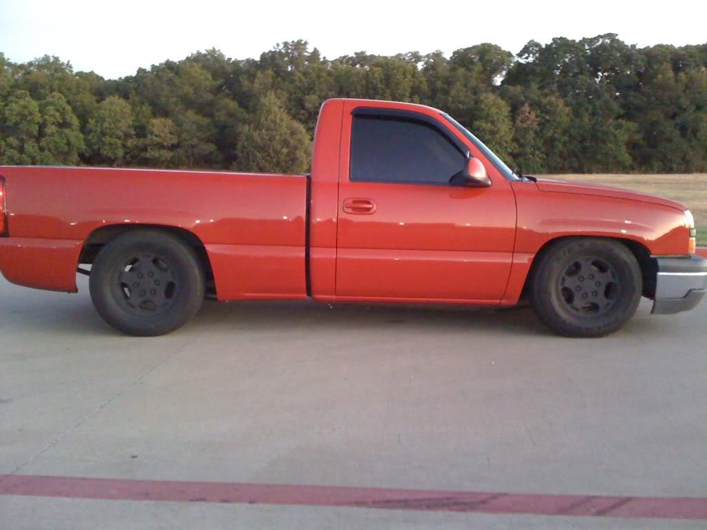

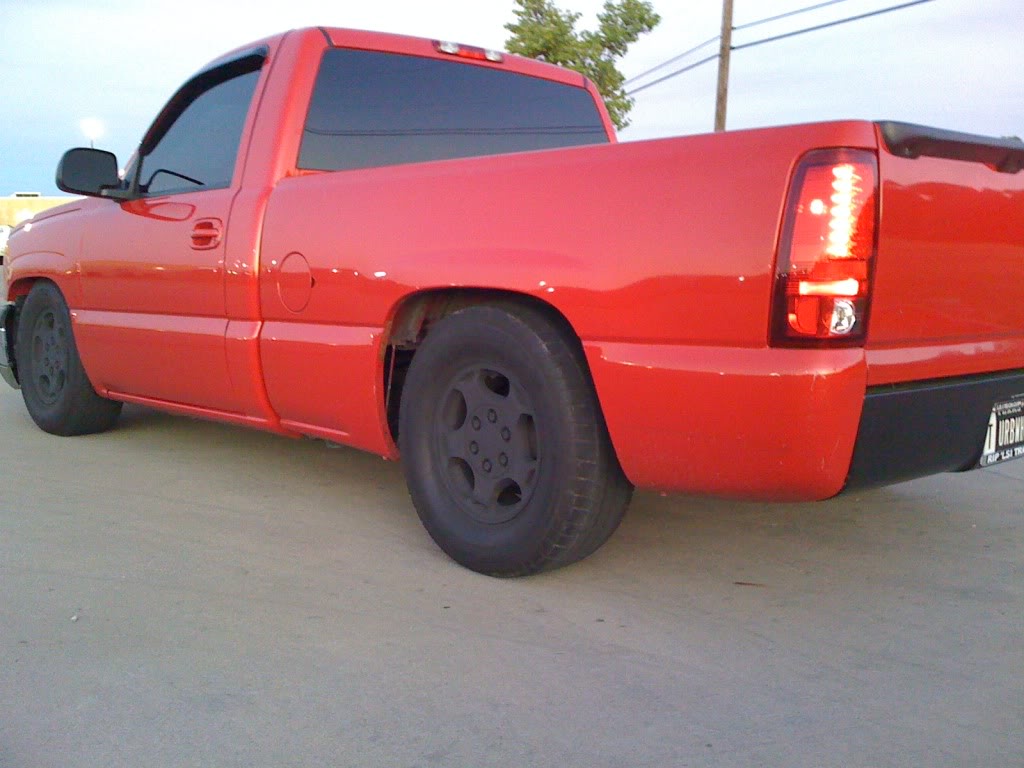

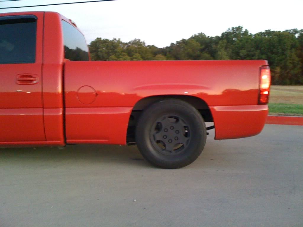

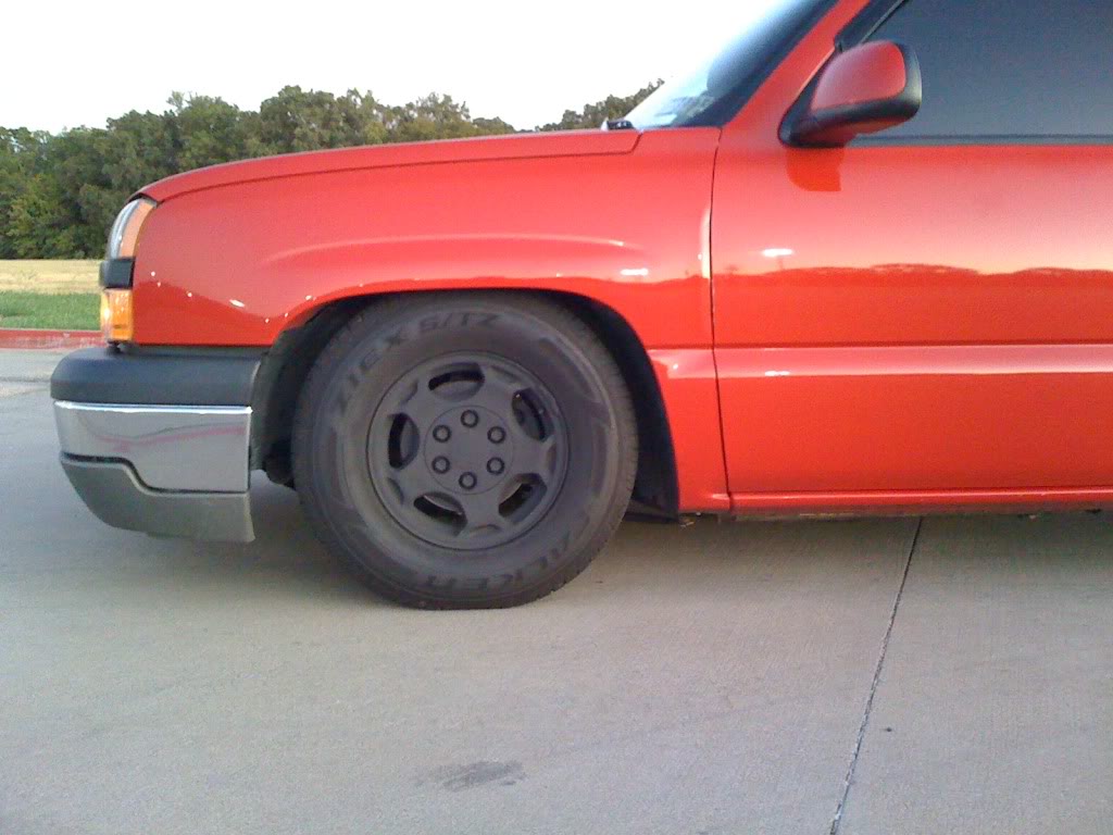

Update:
The control arms ended up being 5" lowering not 3" like I was told when I bought them.
I ended up replacing the upper and lower control arms with new stock ones. Then I installed DJM 2" lowering springs and McGaughy's 2" lowering spindles (the ones for 16" rims). I put in a polyurethane 1" coil spring spacer on the driver side to level it out. The truck now sits at 30.25" all around. It looks more like a 3/5 drop to me though. Didn't need to align the front end anymore either.
Overall, the ride is awesome! No more bottoming out as it feels much stiffer yet smooth enough for road bumps. Takes corners very well, even without the front sway bar!
