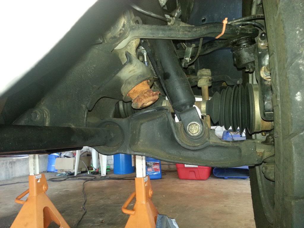

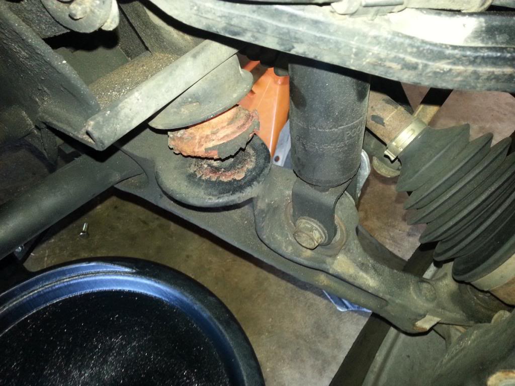

Not that bracket. I was referring to the factory bracket that bolts on to the 2500 arms. looks like these...
There is an HD at work, I took some pictures and will compare it to my other truck. I don't currently know if it is possible to modify a 1500 arm to accept that bracket. I also do not know if it is possible to swap to a 2500 lower arm yet...

Sure doesnt look like it will be that easy...
I might hit up oreilys and compare them directly on the counter
