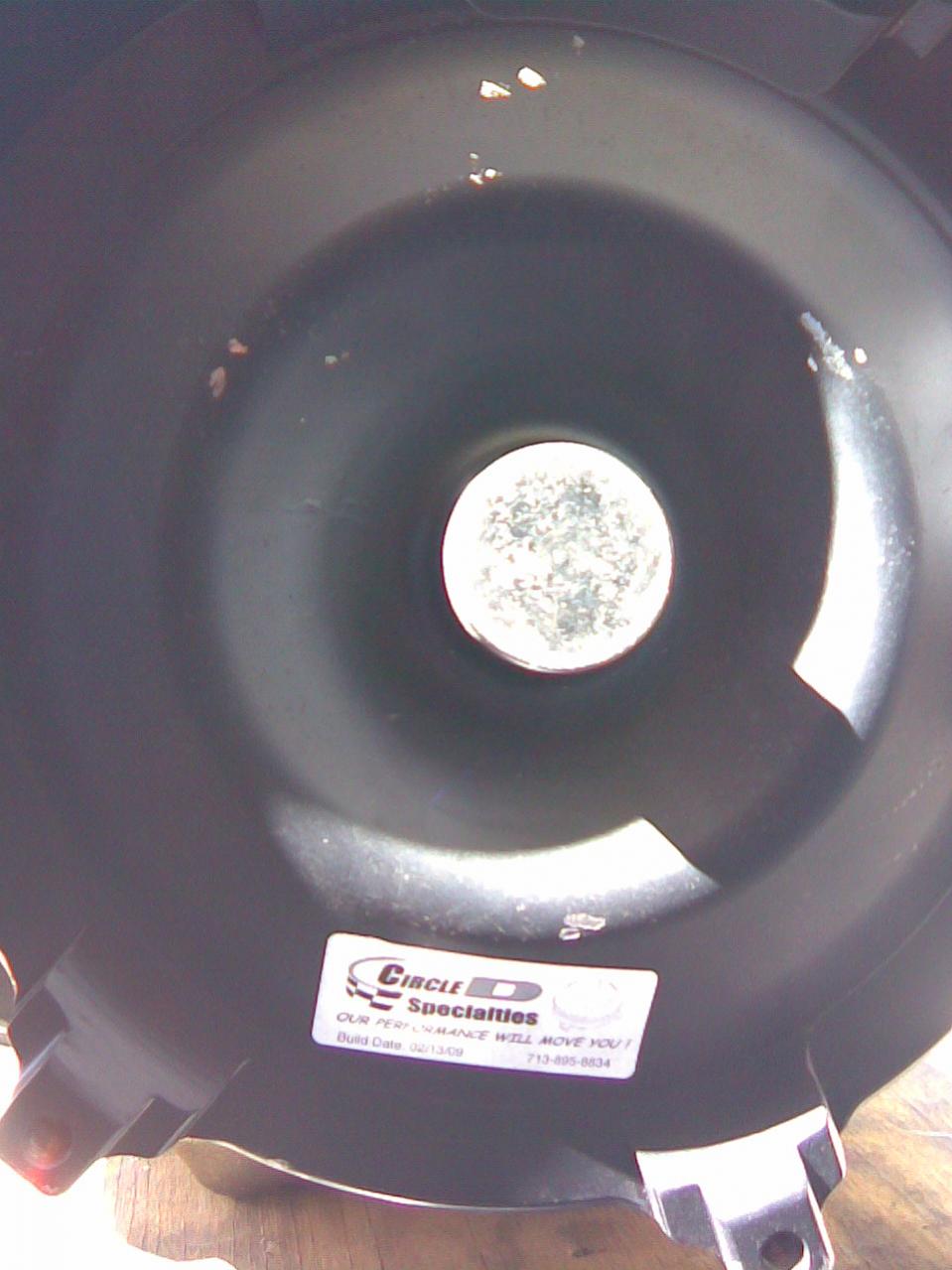

Went and picked my billet pro series up from him a couple weeks ago. Its in right now with the new 80E. I havent got it running yet due to other repairs but when I met with Chris and picked it up he showed me his whole operation. Looked like he puts a lot of thought and effort into what he does. By the way, He waited till about 9 or later on friday night just so I could pick it up from him when I had the time. So far they seem top notch to me..

More details on the stall please. The billlet pro should be the single disk. 245 or 258mm? The one Chris spec'd me out was the 258mm triple disk 3200-3400 for the 80e.

Thats the exact same one that I picked up. Billet 258mm triple disk 3200-3400 for the 80e.

maybe this will help get me about a second faster
