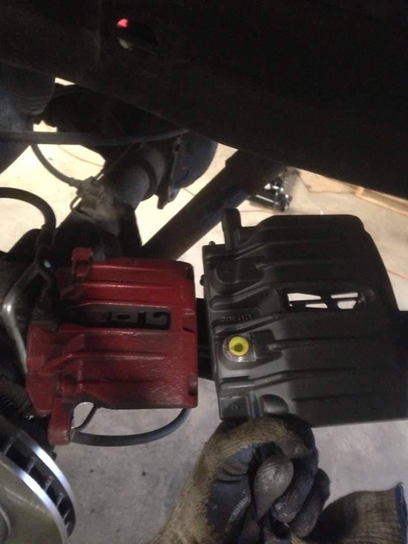

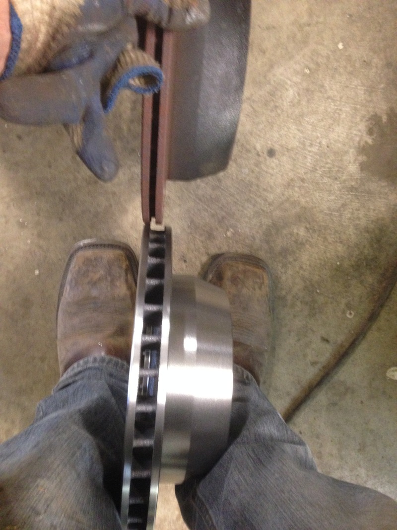

I just bought the 05 Tahoe ones for the rear on my 99. Big difference in everything haven't tested it yet. Cost 243.xx with core exchange for the rears.
( I know my stud is broken)
