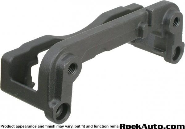

so what i gather from this thread is that in order to upgrade the 99-04 trucks to a front 05-06 rotors (13" ) you simply just need the factory calipers and rotors. in addition to these you need to be able to mount it, so the factory bracket is needed as well that comes on the 05-06. this bracket mounts to the factory bracket mounts on the 99-04?
is the bracket GM part numbers 89059118 (Front Left) and 89059122 (Front Right)?

If you order the loaded calipers they come with the bracket.
