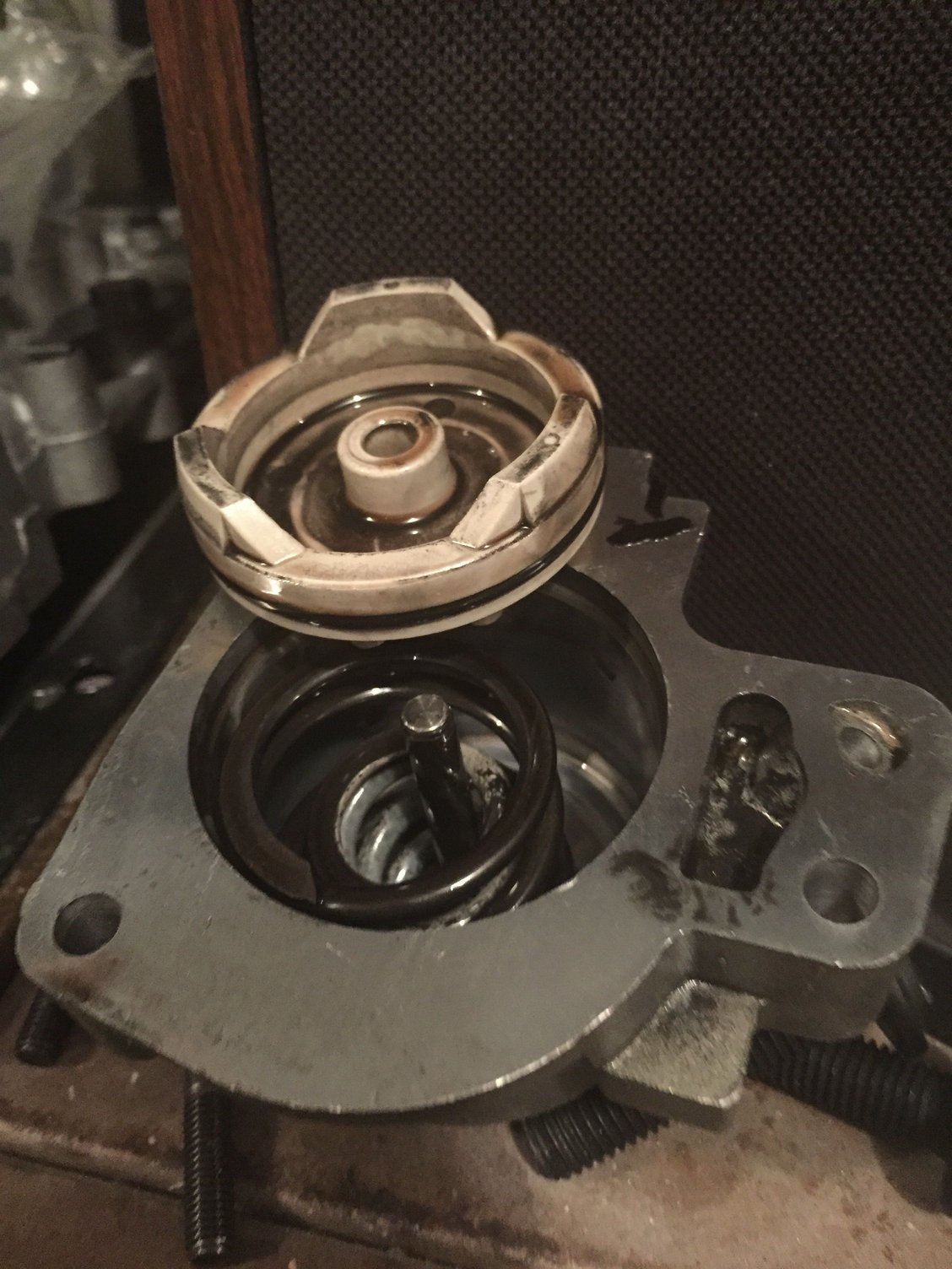

Old Oct 6, 2015 | 02:44 PM
Wolftrk99's Avatar
Joined: Jun 2013
Posts: 5,492
Likes: 48
From: Virginia Beach,VA
This is what the underside looks like when you yake it off just hopefully not so much metal in the fluid...
