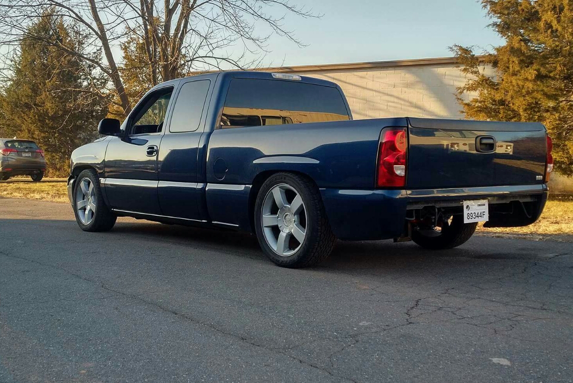

What type of top mount do you have? I wondered if a 303 would be that low with a stud top mount and 7" spring?
Currently using Atomic's top mount but will be switching to stud mount to either increase the travel of the DS303 or move to DS401 with 10" 800lb springs.
Actually, now that I think about it, you probably could get very close to your photo by using a DS303 with stud mount. Stud mount lowers 0.75" at the shock and 1.5" at the wheel.

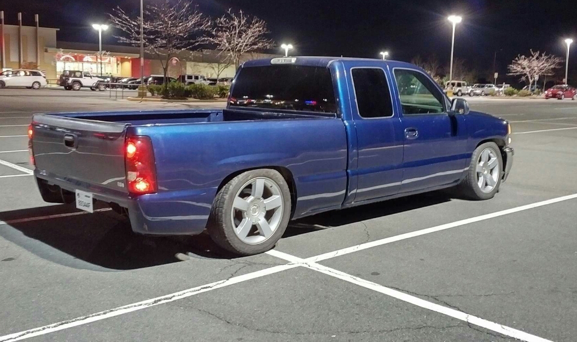

So believe this is a viking c201 with stock spindle and the stud top. The second pic is with the same shock but the procomp adapter.

That helps, that shock is almost the same as the ds301 according to the specs.
I think I have a plan now, but I'm still going to have to lower the truck to the ride height I want before I can measure. Having three options for top mounting and 2 options for shocks I think I can find the perfect setup. Once I have my shock height I can choose the combo that's best. Whether that is stud top, procomp adapter or your new upper bracket, I think I can find the perfect height that keeps the shock at the 60/40 sweet spot you mentioned.
I think I would prefer the 303 for the larger spring selection between 7-9"
