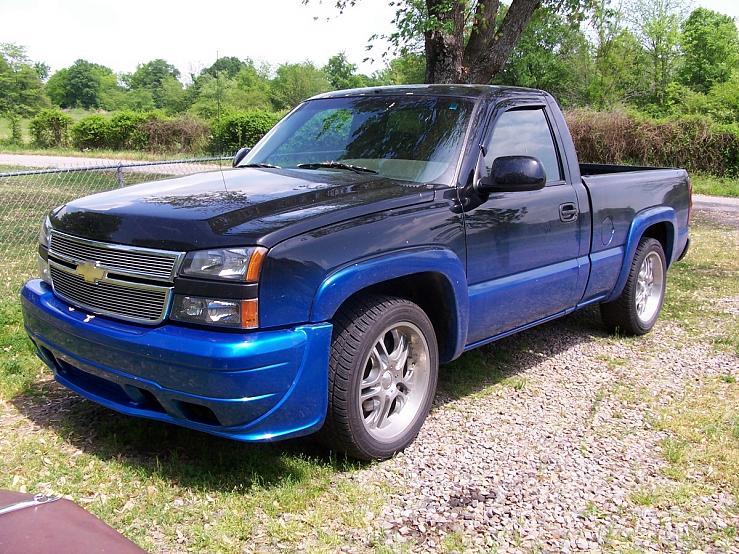

what do i have to do to get my truck this low. do i have to mess with the drive shaft? and could i run 22"s without rubbing?

there are couple of ways to go about this in the front. 1" coil/4"lca or 2" spindle/3" coil... for the back, you are gonna need a flip kit/c notch

i've got a DJM 4/6 on my truck and run 285/60/18 tires. with lower profile tires you could easily run 22 inch or maybe 24 inch wheels if you wanted to. IMO, anything bigger than 22 is ugly.
my truck has spindles, lowering springs, axle flip, and c-notch to get me to 4/6

You wouldn't need to change the lenght of the D-shaft...you may need to change the pinion angle...thats just shims though...and the flip kit would likely take the pinion angle into account...as long as you get a good one.
Edit:
Oh...depending on how ghetto you wanna get with this...I have seen guys take out the body isolators and cut the rubber down to get the body to sit lower...you can gain 1-1.5 inches drop doing this.
makes a 2/4 almost look like a 4/6...
Oh and yeah you will need lowered shocks...

I'd recommend just doing the drop the right way.
I'd do a spindle/drop coil in front and flip kit and notch in the rear. I like the look of a flip kit and drop shackle in the rear
