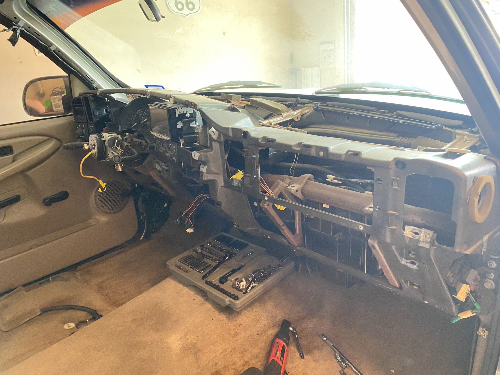

Fixing the Heater Core

More PICS please !
That Heater core R&R is a Beeeotch.... 9 hours...

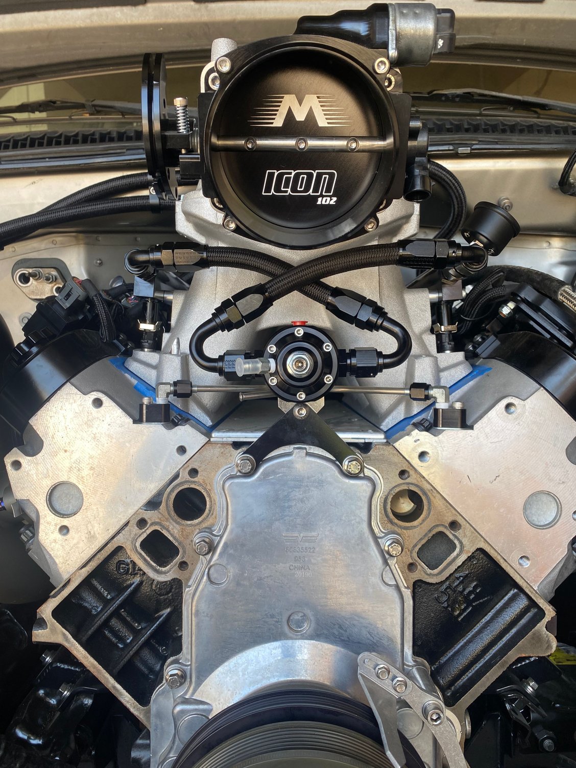

Thanks guys more random pics cheers.

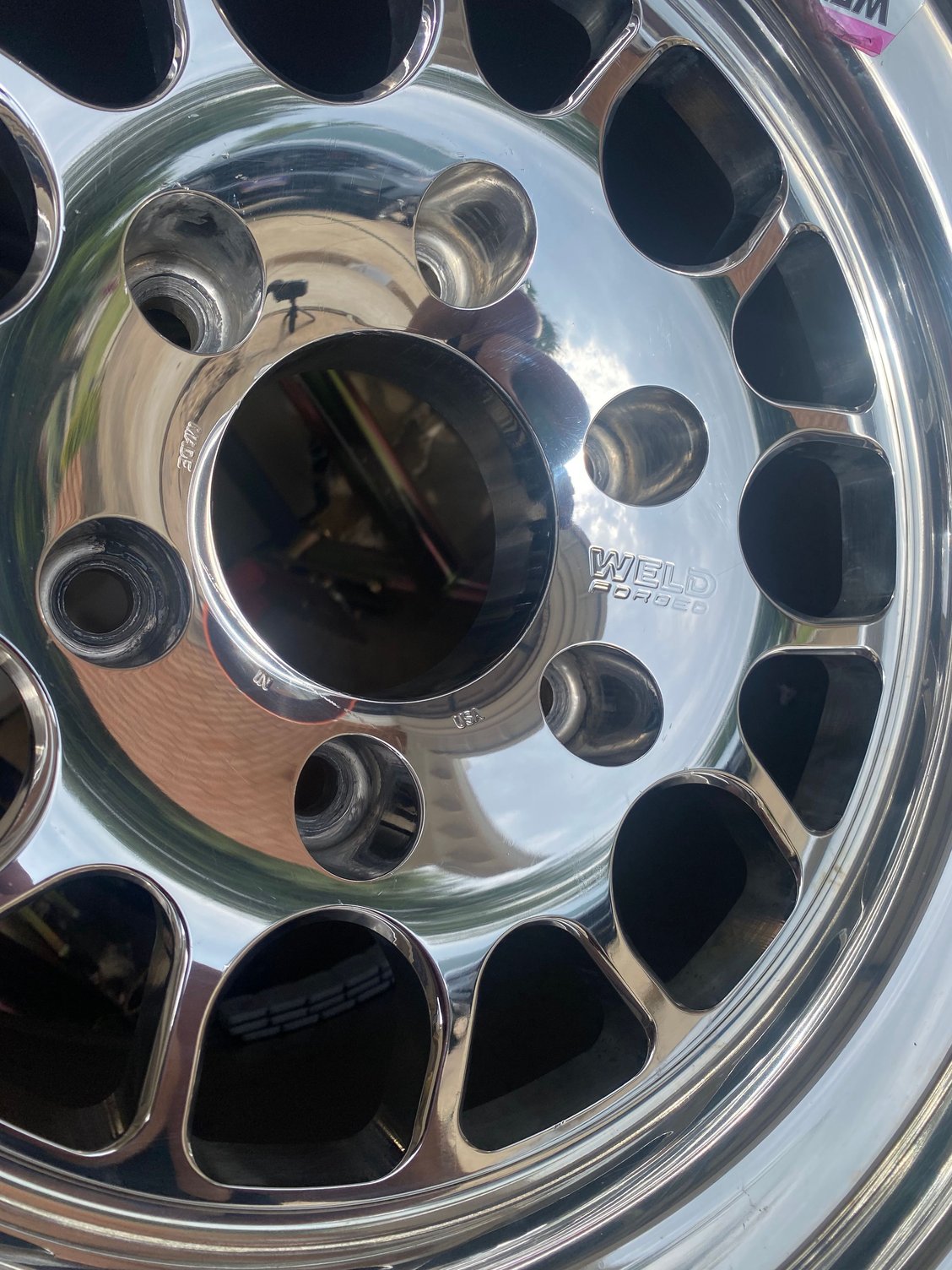

New welds look so sick always wanted a set.
It wasn’t fun but not as bad as I expected. Pulling the seats out made it 1000x more easy.

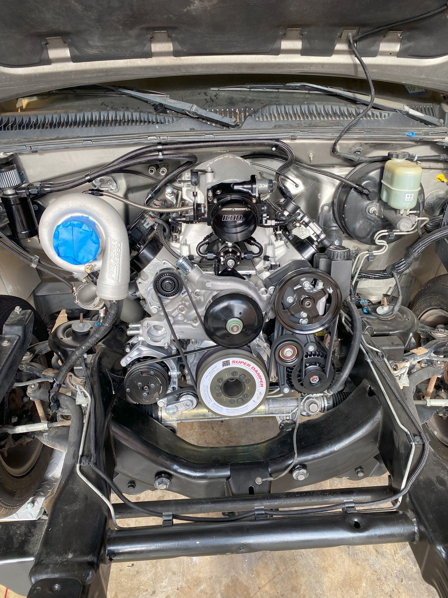

Looks good! What accessory bracket is that? Still truck spacing?
Thanks. Yes still truck spacing all the brackets are from Holley Low Mount Accsorie Drive Kit. If I had to do it again I’d probbly go with ICT. The kit took forever to get only the driver side bracket was black and it cost an *** ton for what it is. That being said fit was exceptional and belt alignment looks **** on so hopefully no slinging belts. It’s Texas and I’m Fat so I need AC

Nice...I like how it cleans up the driver side. If I thought the PS res would clear my headers I'd do that also. I won't judge too hard for not using AFP motor mounts since you have my coilover kit
