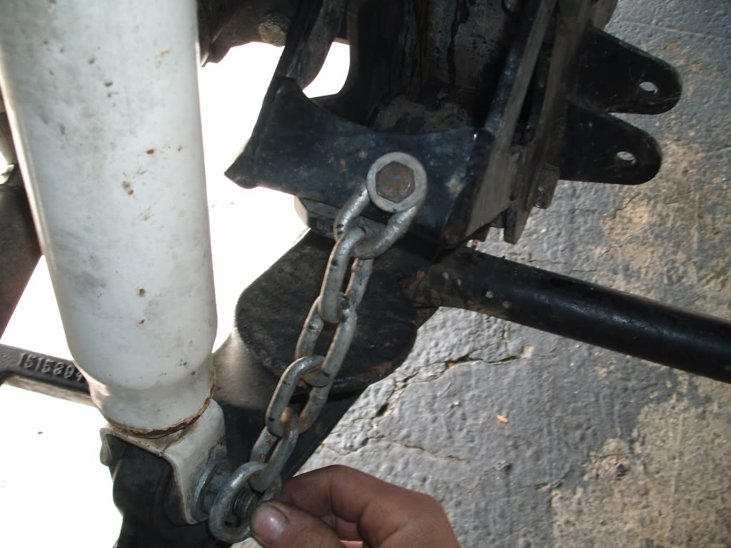

first of all id like to ask if any of yall could please post how youve made/ routed your limiting strap on the front end to prevent wheel hop...i 4wd launched my truck for the first time with the new gears the other day n im pretty sure my front tire came off the ground from the severe wheel hop...secondly i need a new pitman n idler since mine are so worn, after a launch n stopping my tires were toed in like no other, then aftera few mi. of driving somehow they managed to go back straight? ive got full 1"dom cognito tie rods but cognito doesnt carry HD pitman/idler arms do they make heavy duty ones at all? all i can find is stock replacement ones and the congito brace kits. if anyone could help me out itd be greatly appreciated!

Here's a pic of my limiting chains. They work wonders when they're tightened up without slack.
