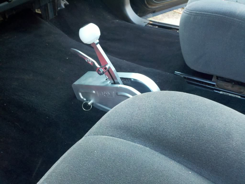

I have a manual valve body 4l80 behind my carb'd motor. I love it

do you shift from the floor or the column? do you just have a switch to lock the converter? i'm interested in how it's done...

I have a B&M Pro-Stick floor shifter. I could have used the column shifter no problem, but I've always wanted the floor shift. I just have a toggle switch to lock and unlock the converter. Super simple.
