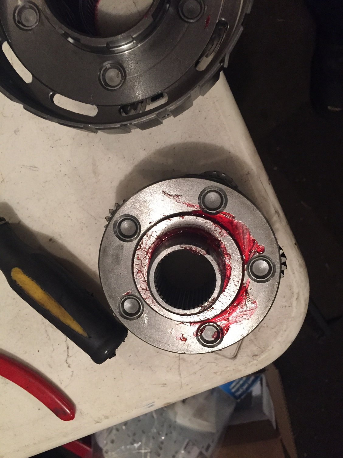

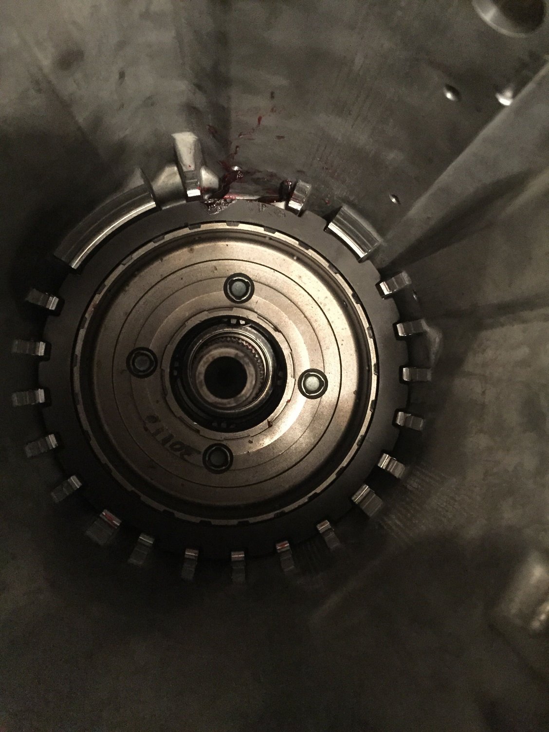

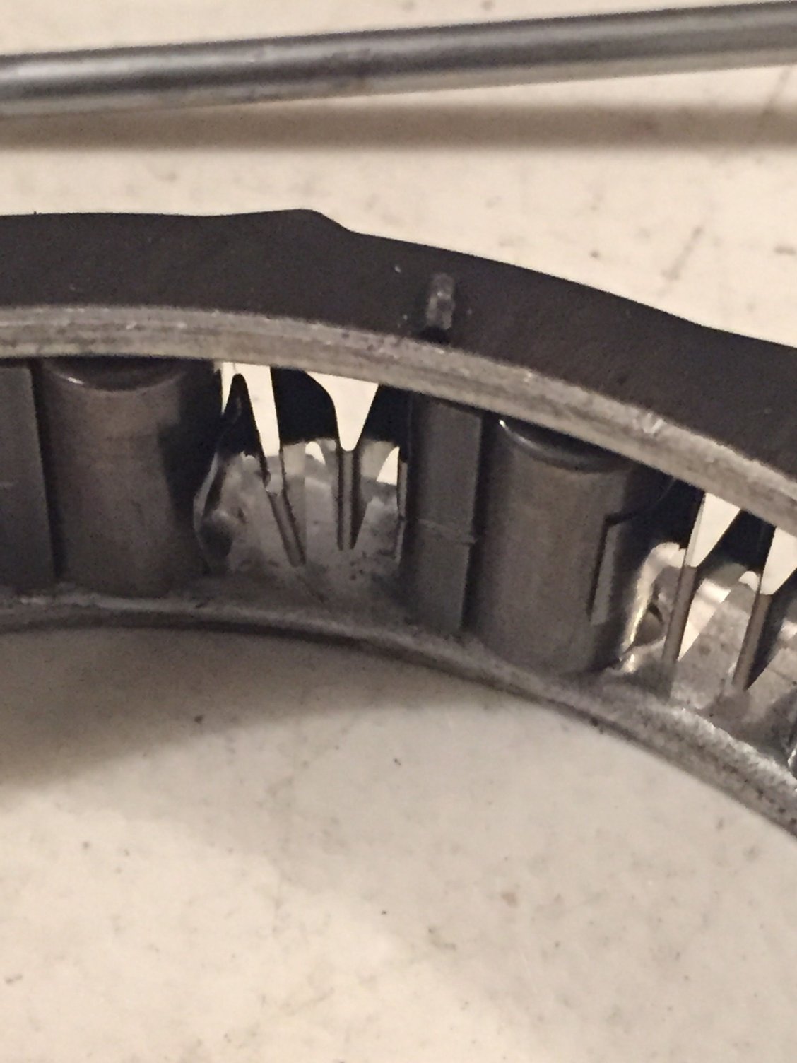

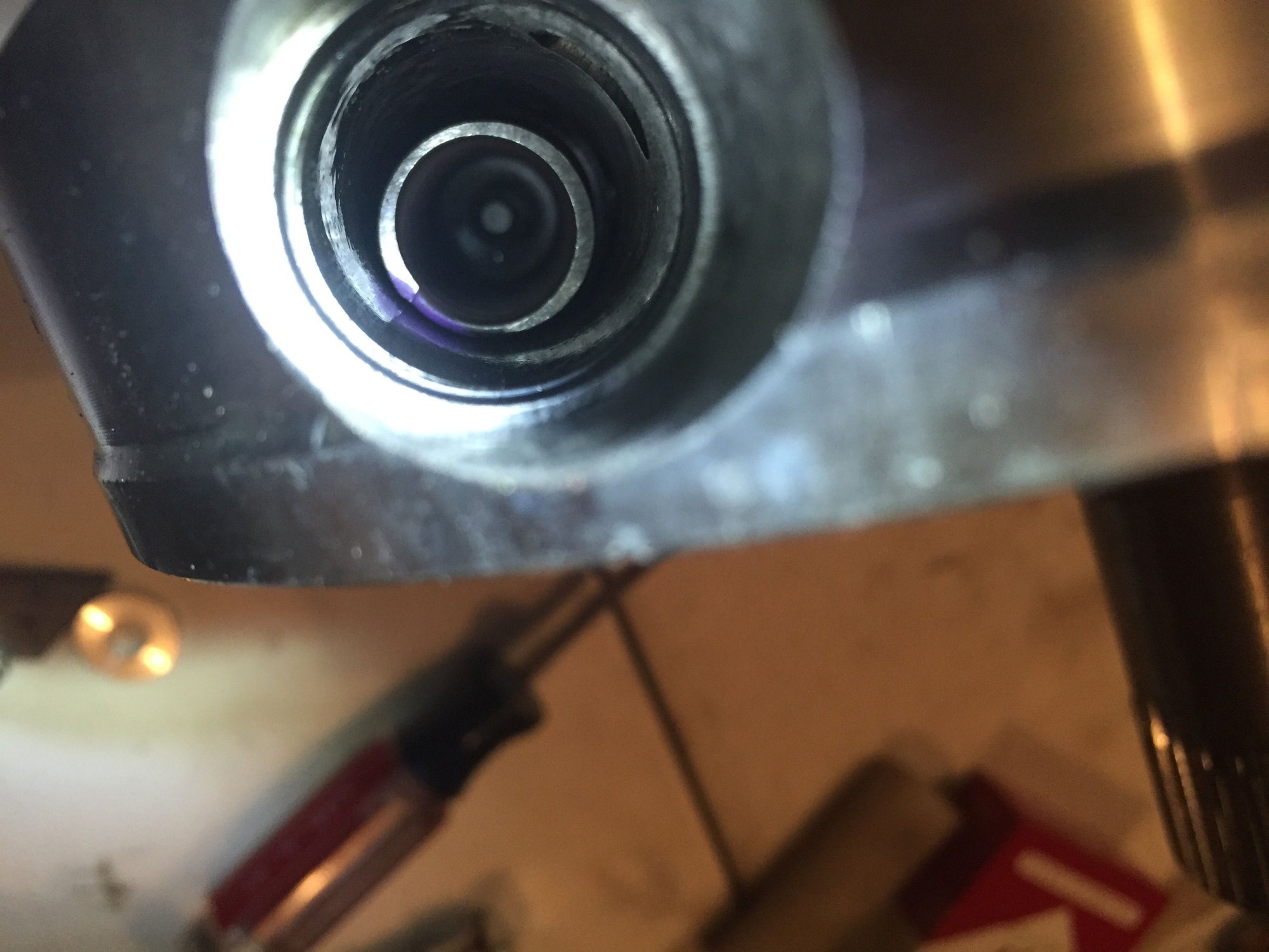

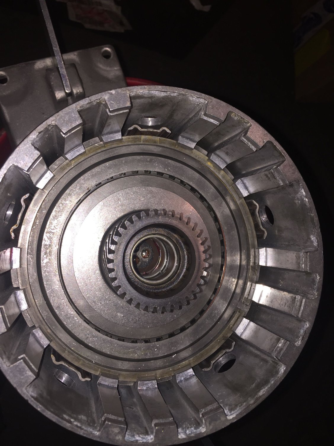

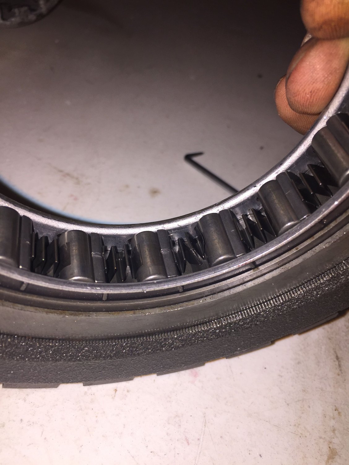

Got to the low/reverse sprag finally!!!
Glad i went back in after that!!! Was worse than i thought

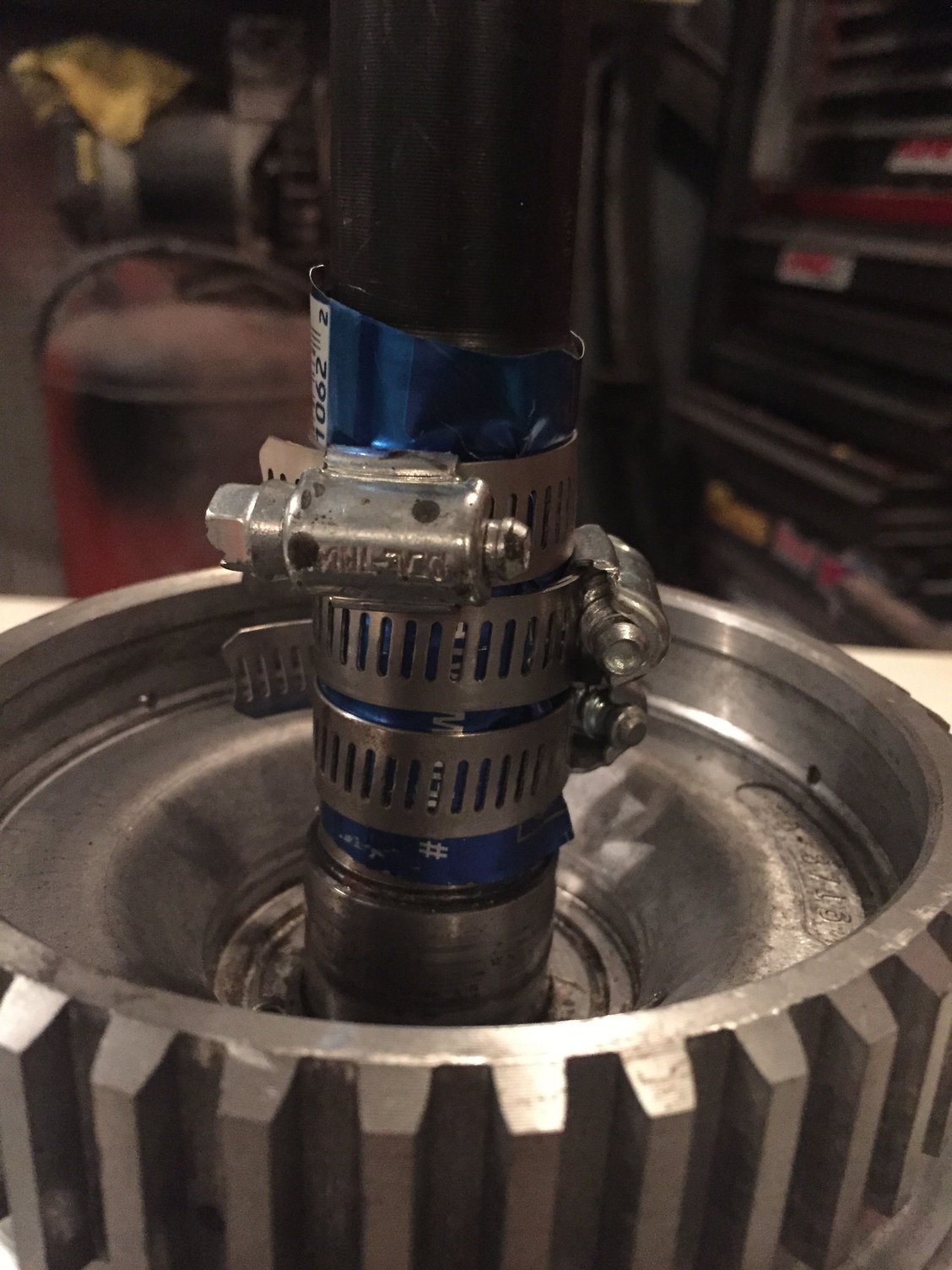

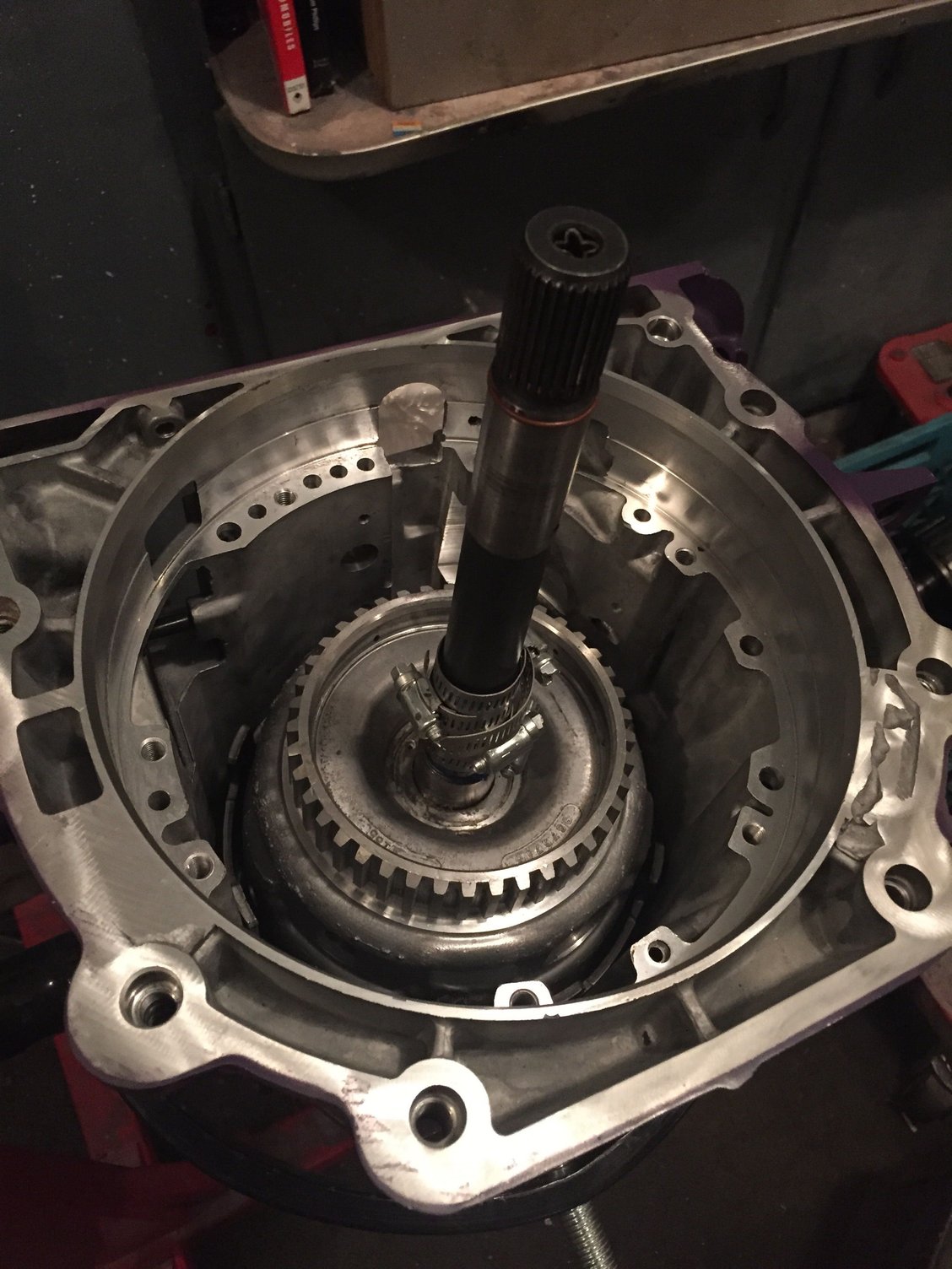

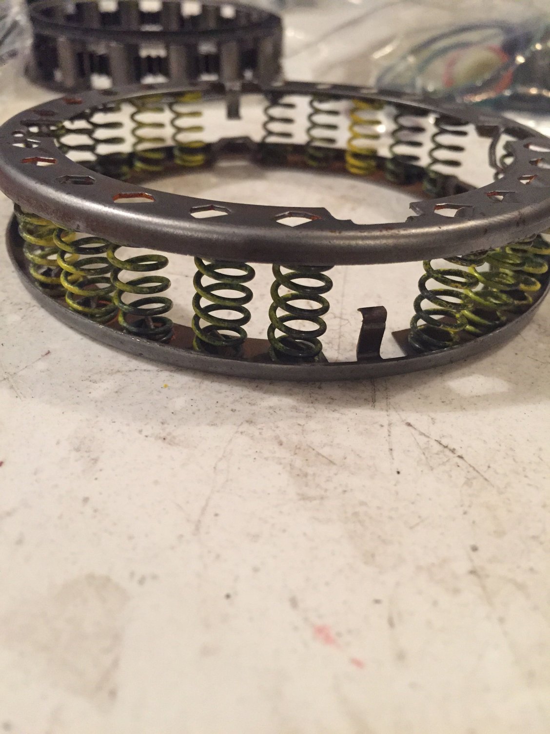

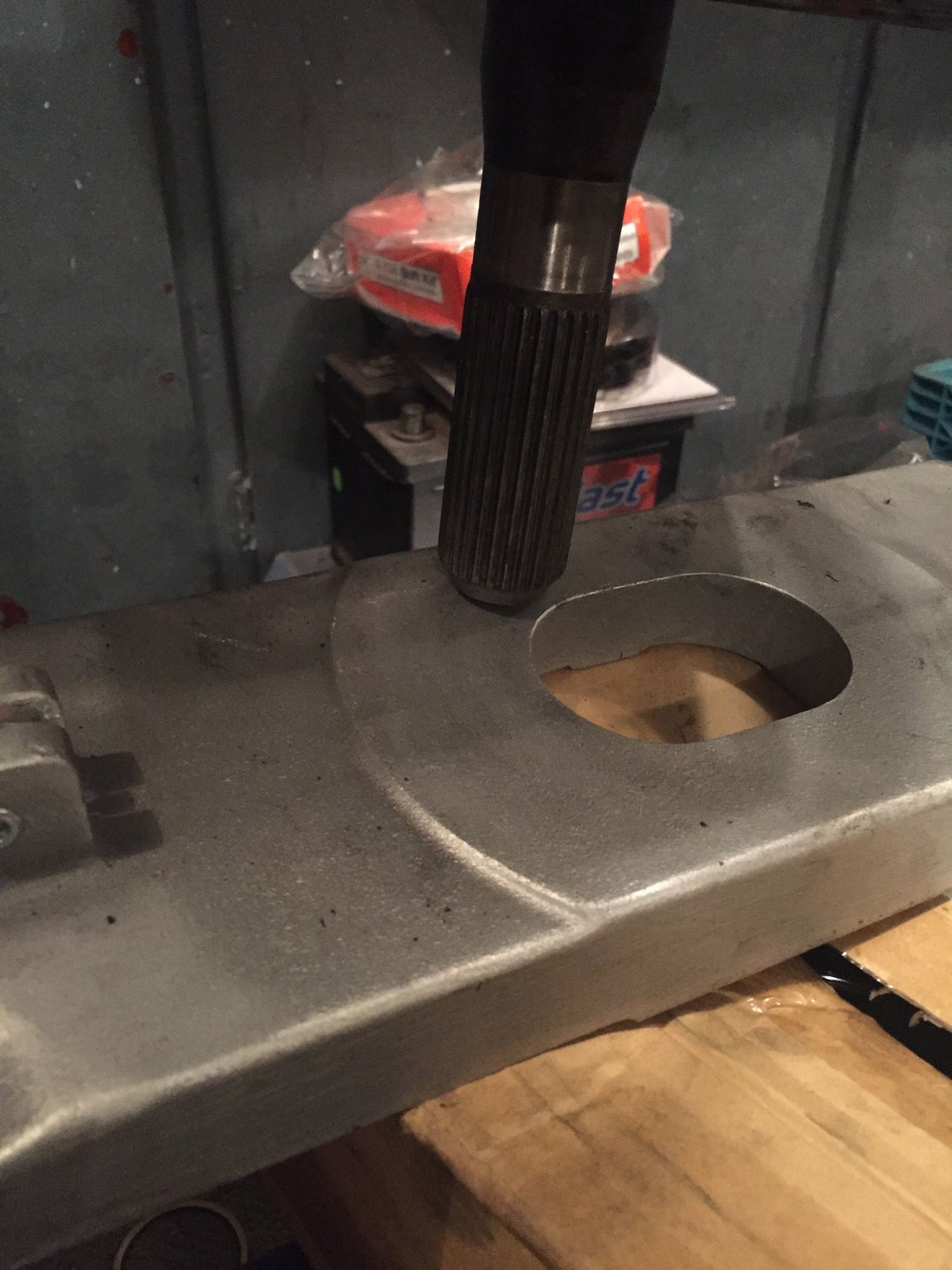

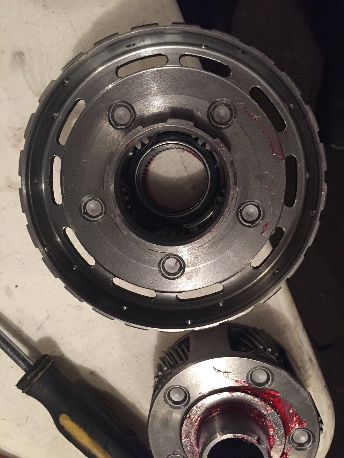

And back together we go......

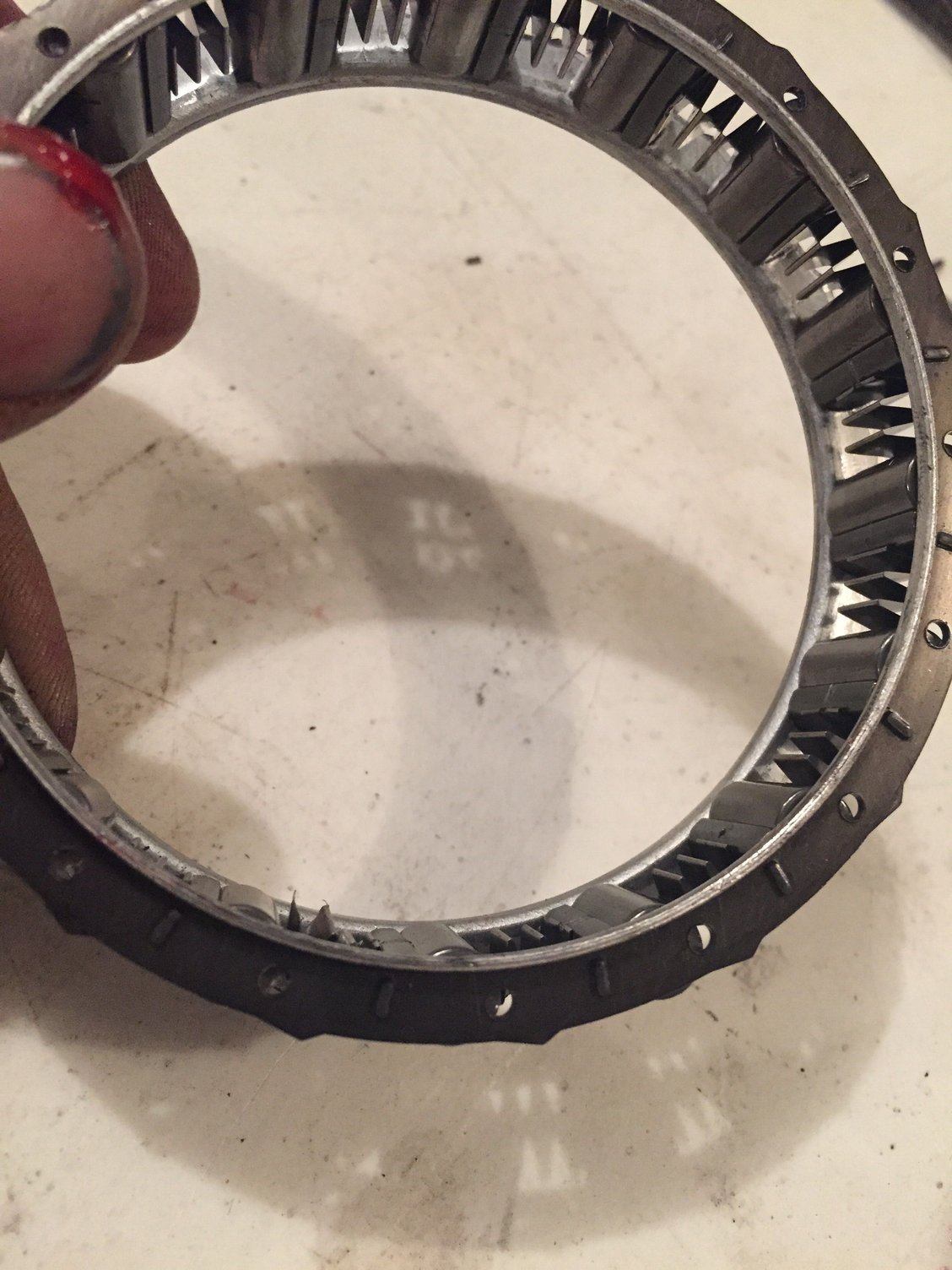

Replaced the rear planetary with the 4 pin
New sprag installed and lubed up
My tailshaft support tool
Front 4 pinion planetary
taken out
Front too!!!

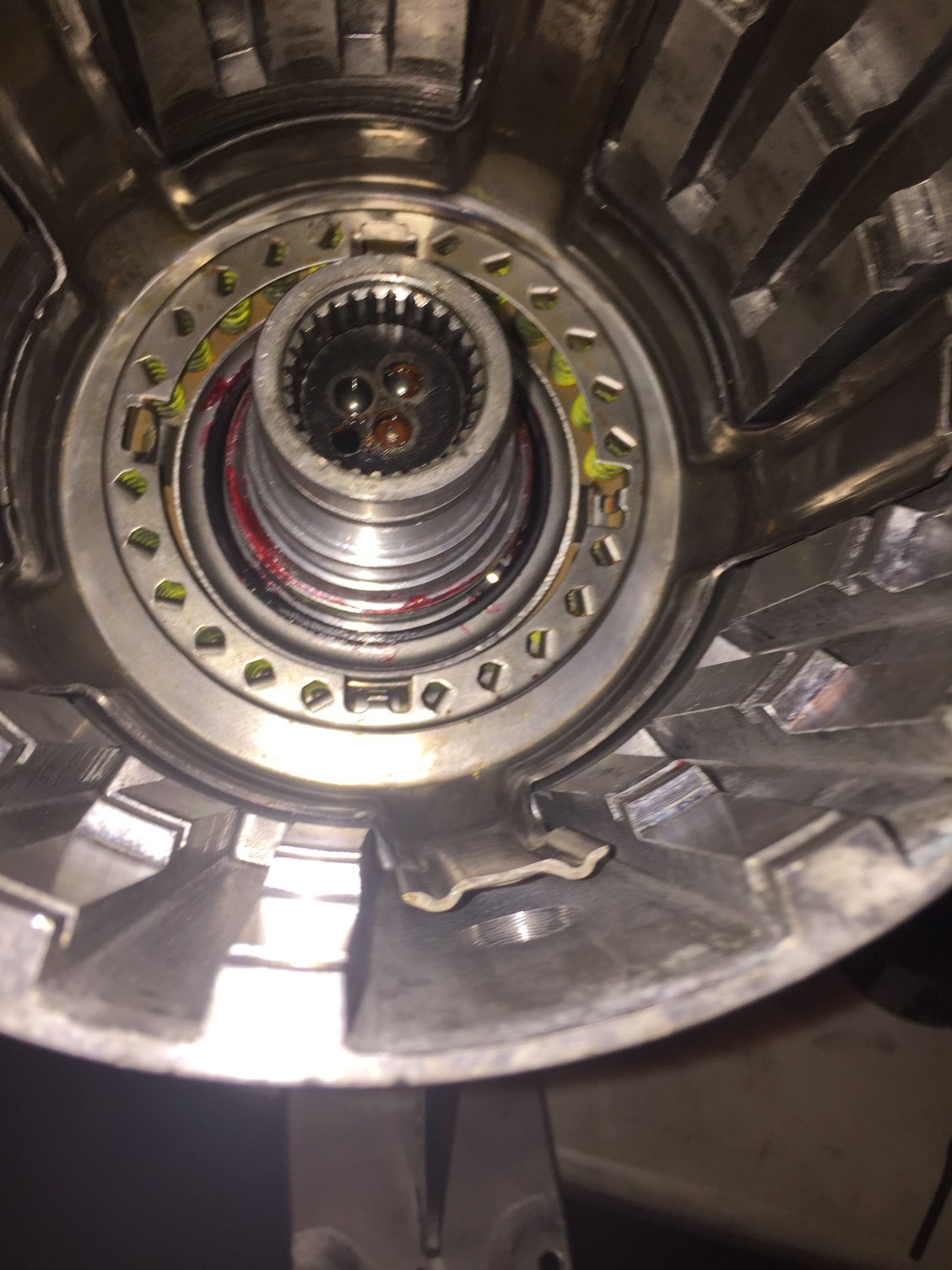

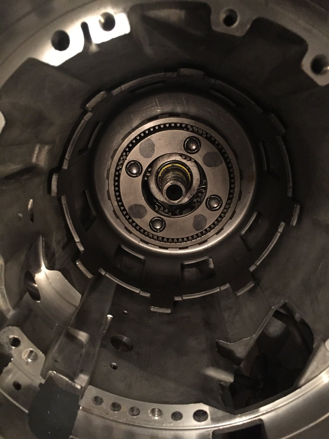

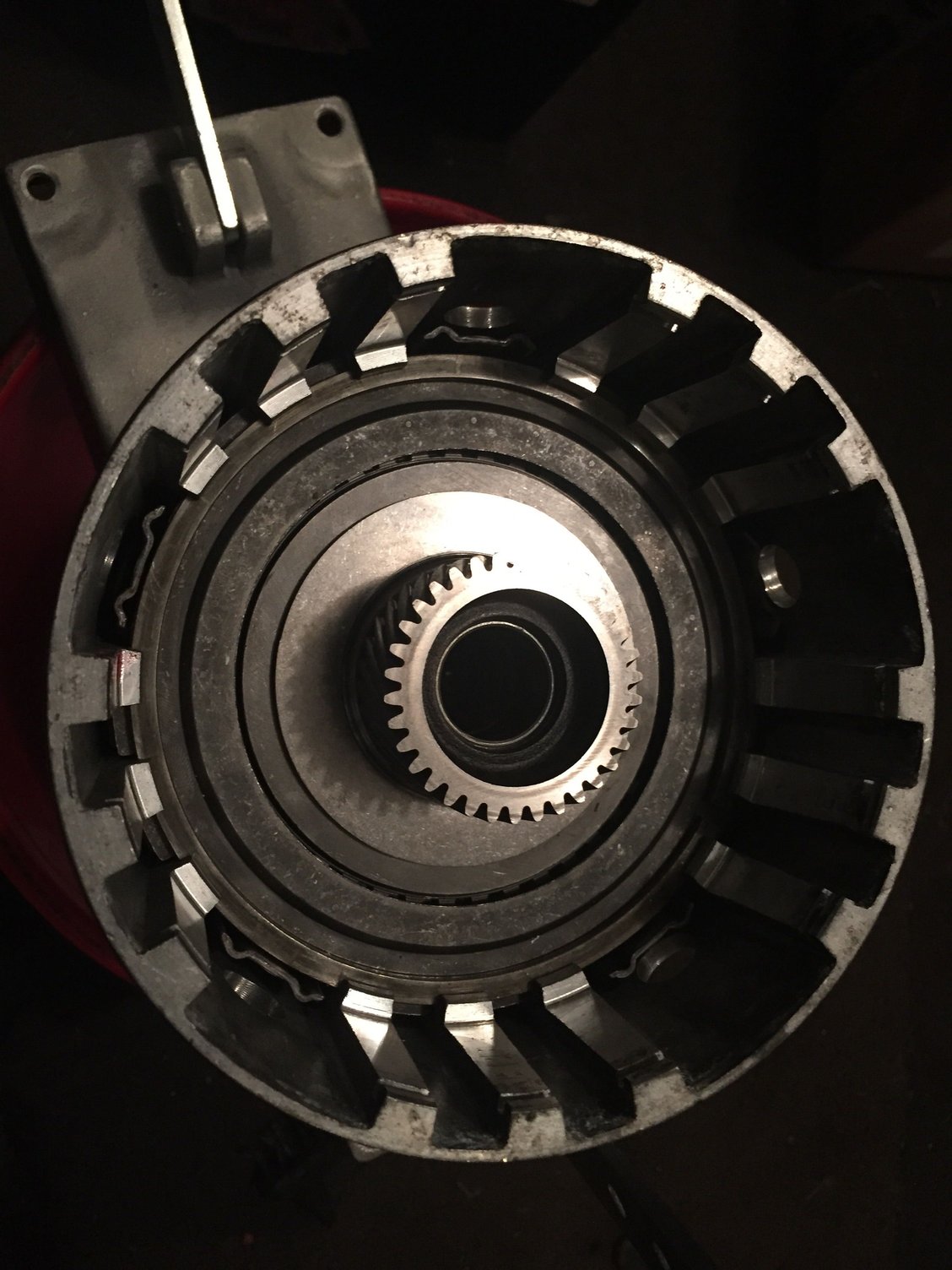

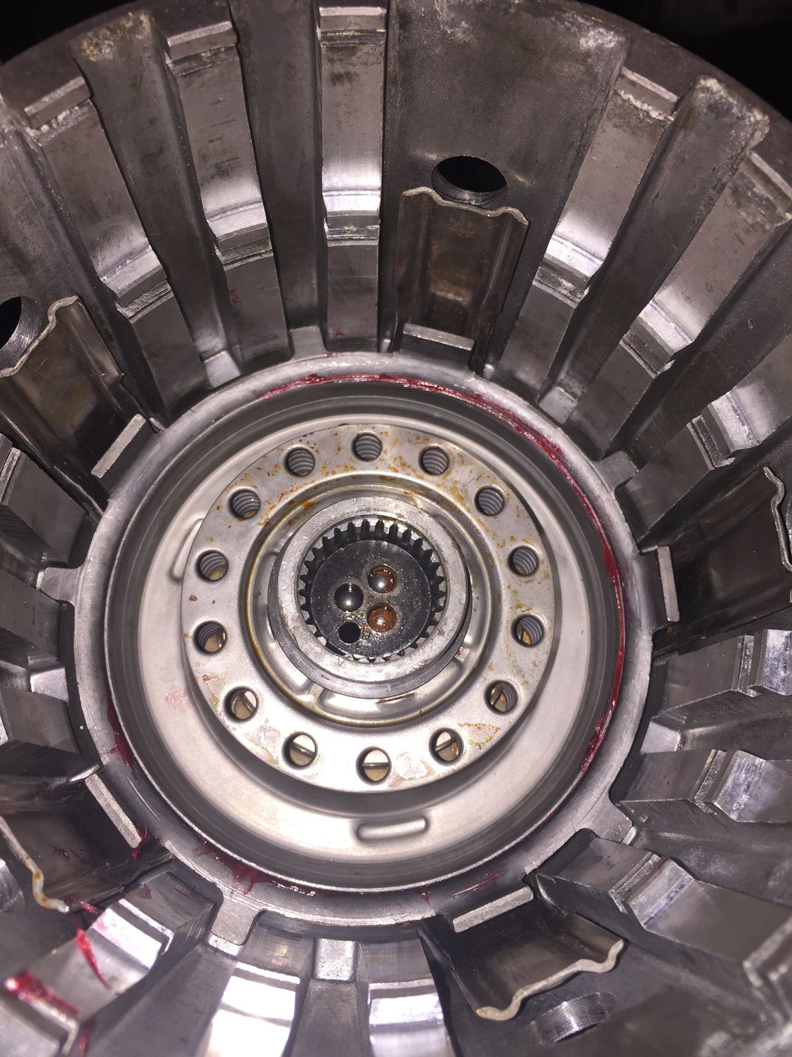

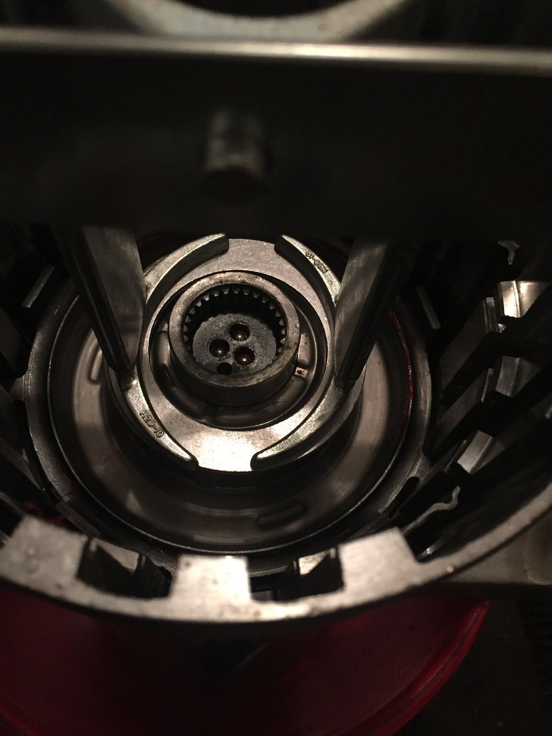

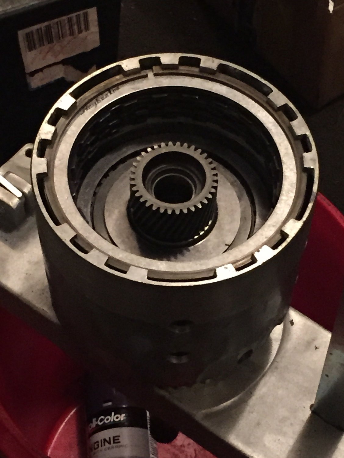

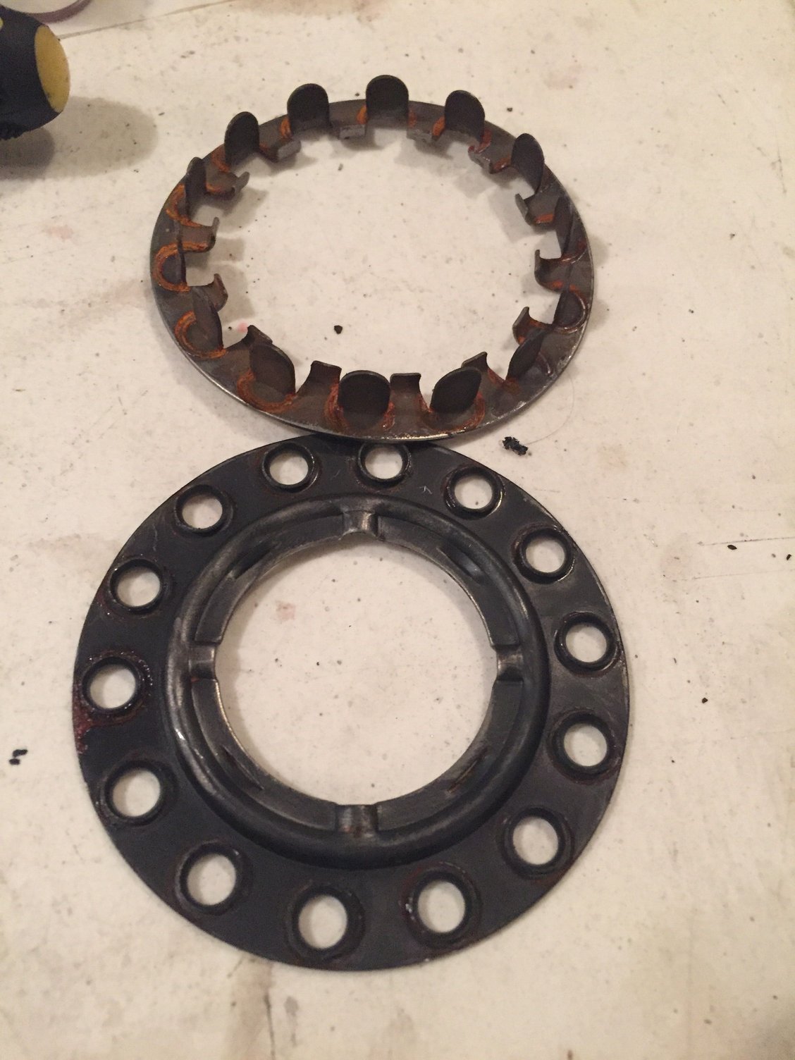

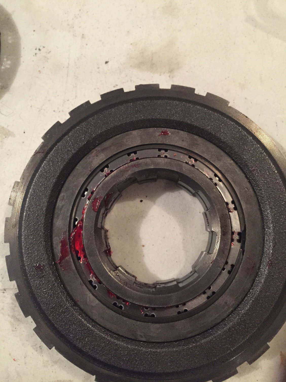

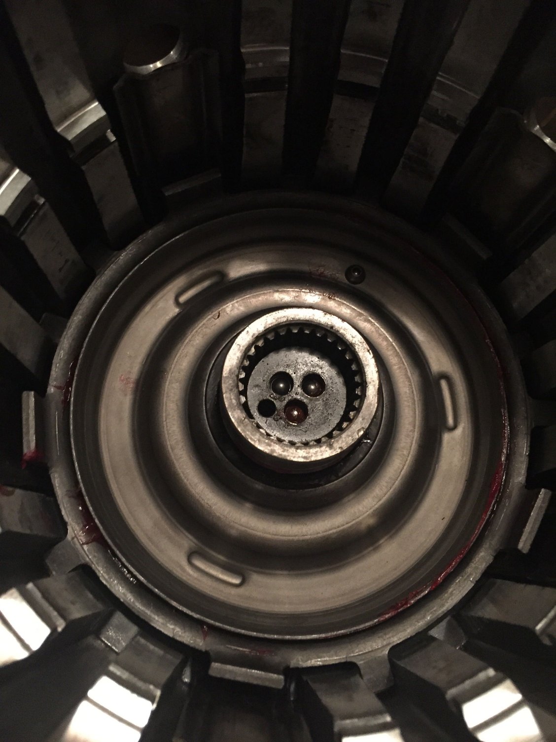

And now for the input drum.....

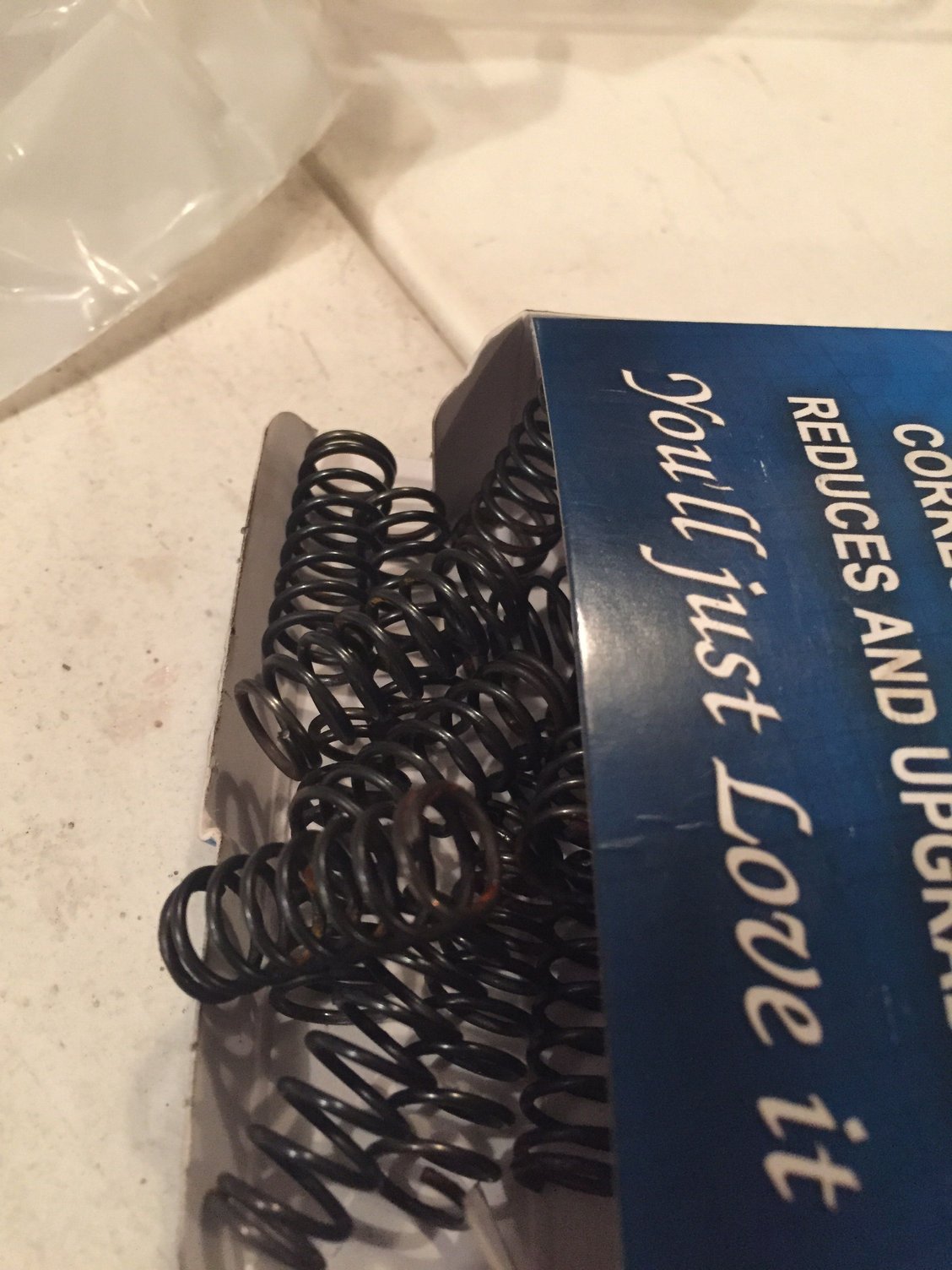

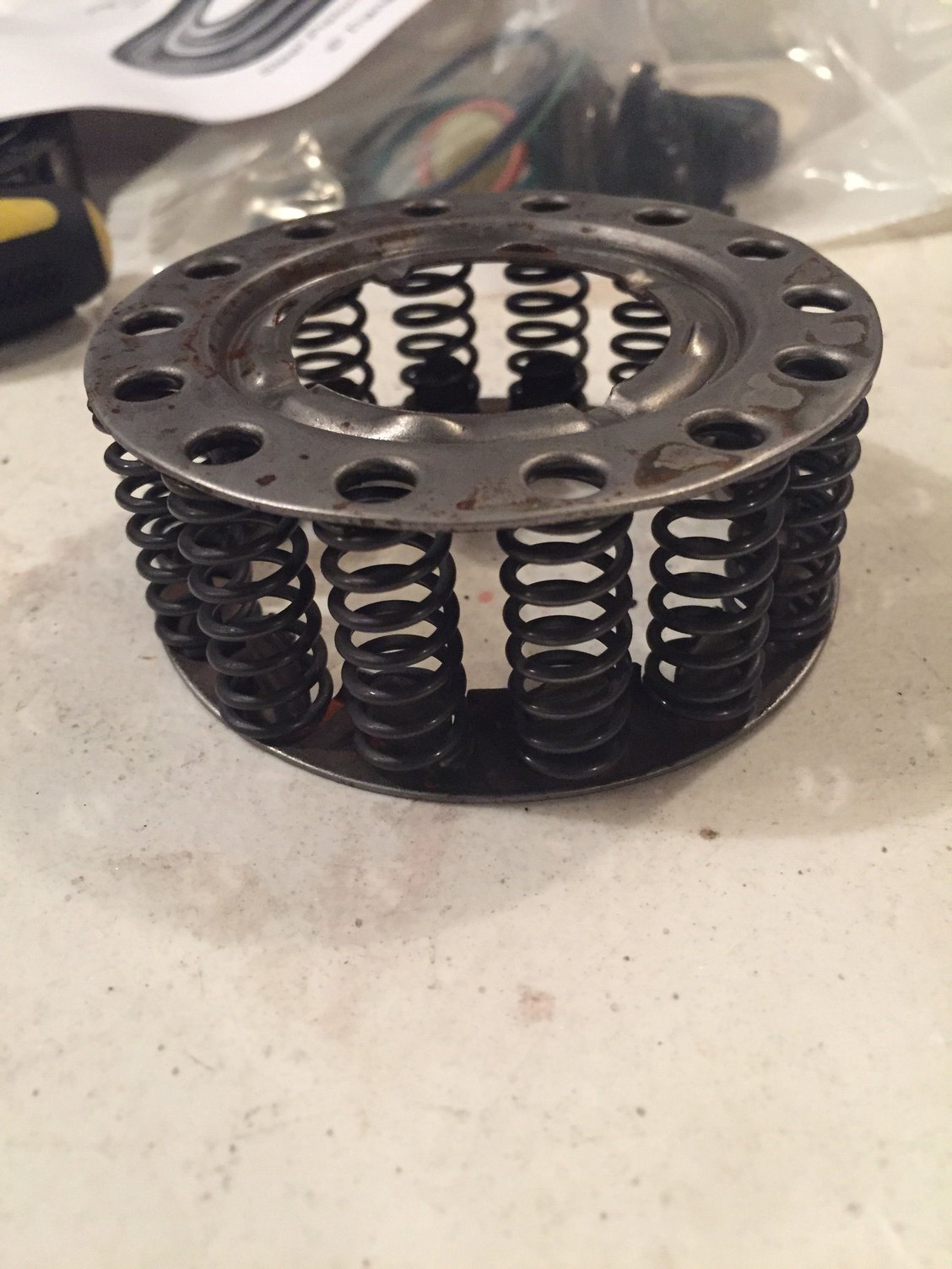

Ready for transgo springs!!!
Spring installed
Old springs
Springs in!!!
Orifice plug out
Transgo in
My fancy ring sizer
Glad i remembered to grab these when i left work!!!
Snap ring in...
Over run and forward clutches in along with for sprag!!!
All done.... Went little tighter on clearance than recommended.... .035
Drum in.... I'll take my special sizer off tomorrow, or whenever i happen to get back over to work on it again....

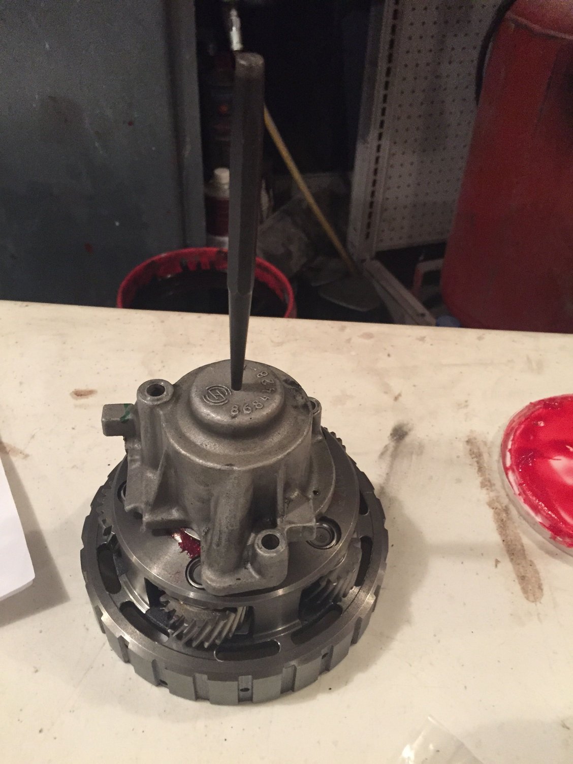

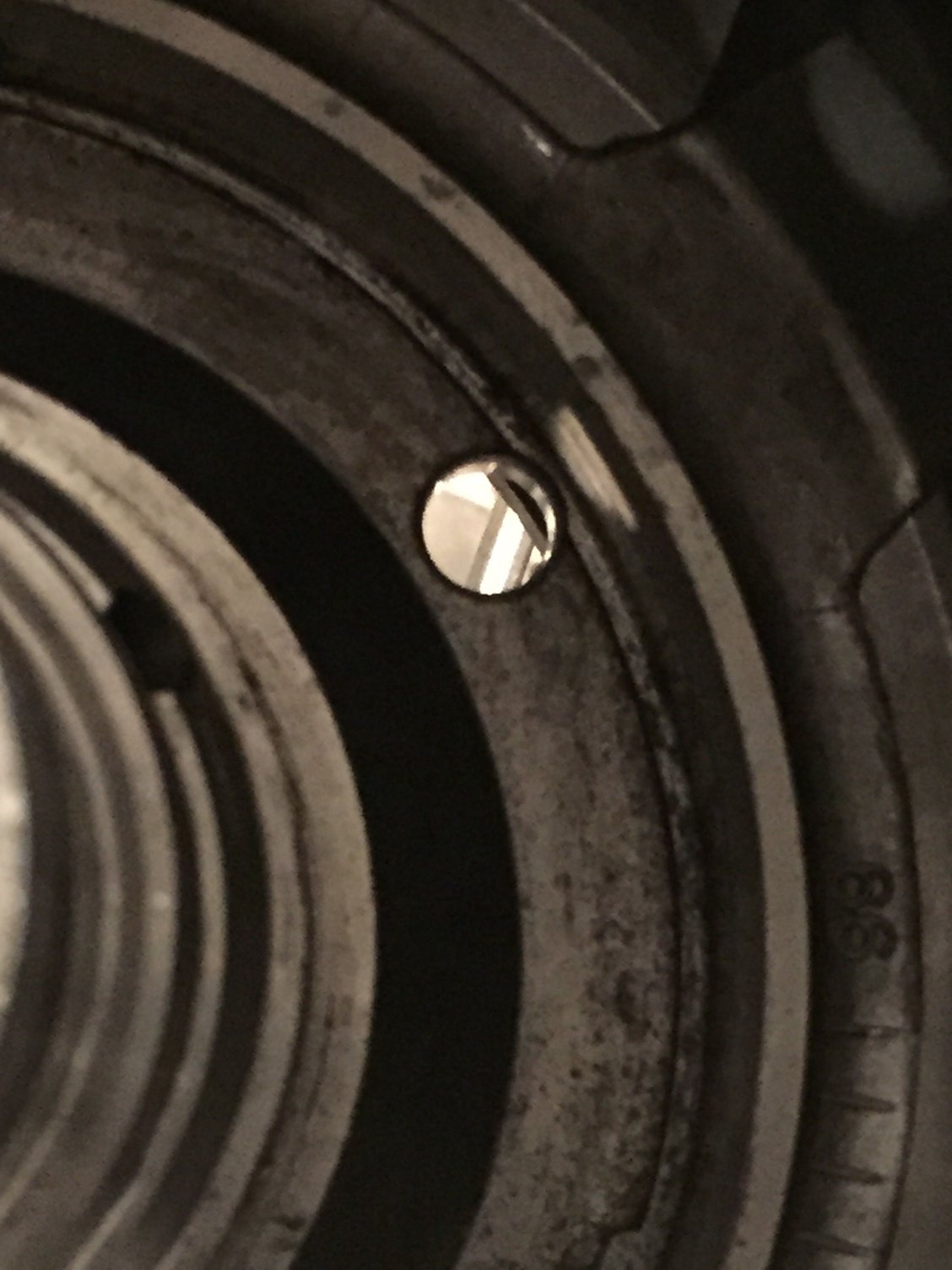

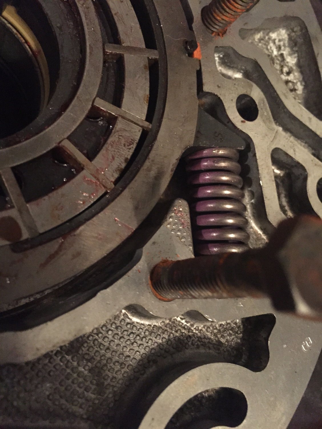

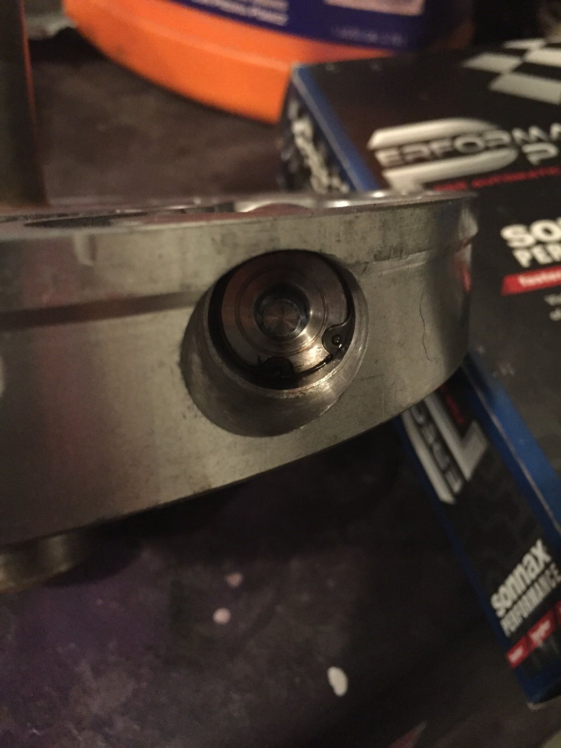

And now for the pump..... And accumulator housing

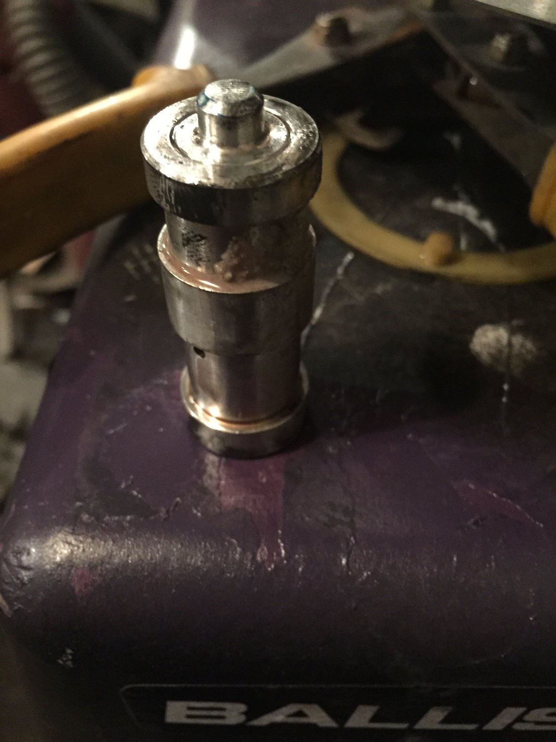

Knocked pin out of 1-2 accumulator housing so i can clean it up at work and get the sonnax ***** driven into it....

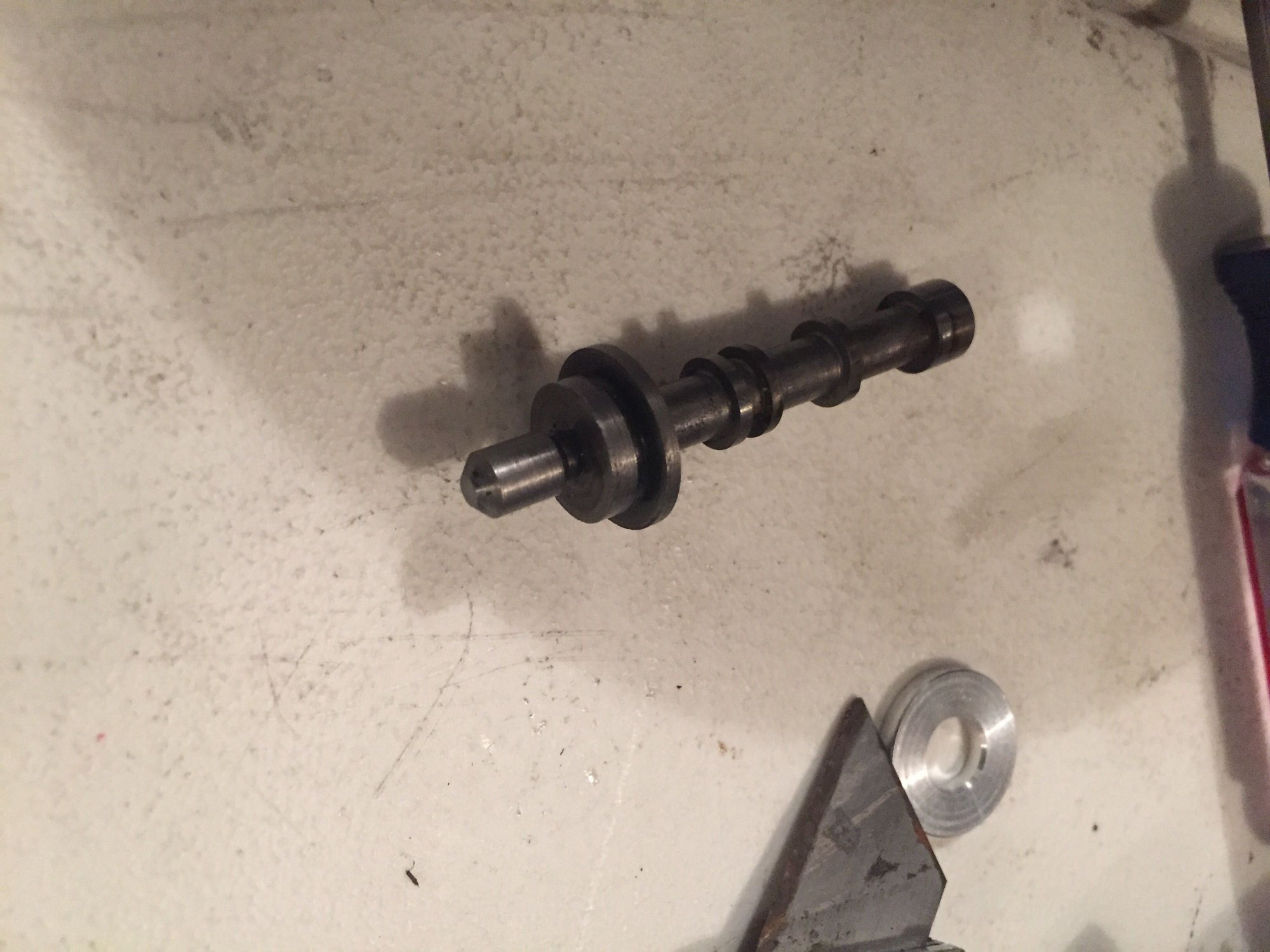

Original valve...
Glad i pulled that!!!!
Pulled it all out!!! Wanted to make sure there was no more watery trans fluid in there!!!
New spring in
Sonnax purple pump spring
