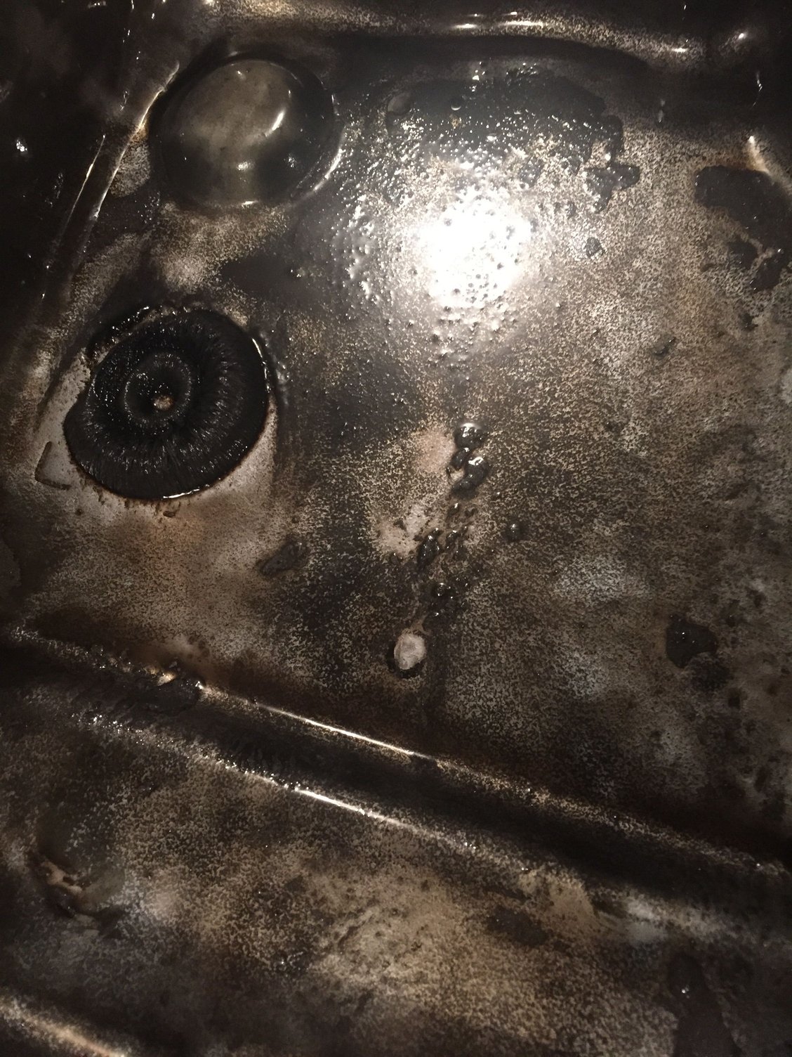

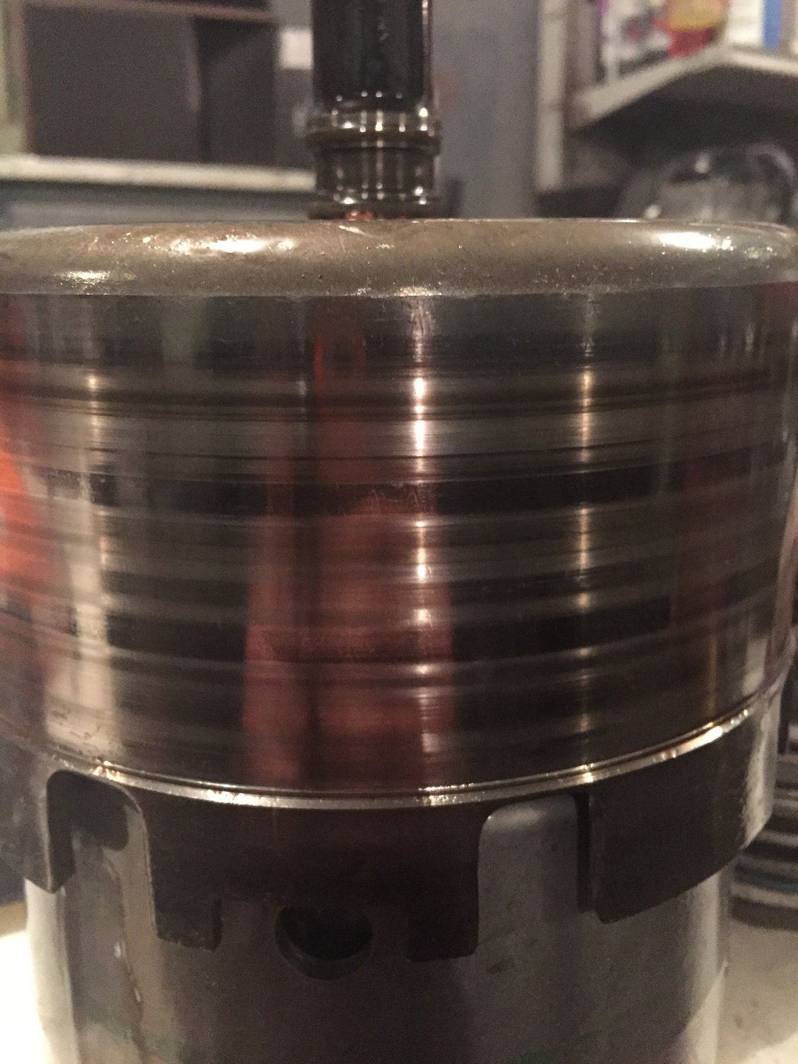

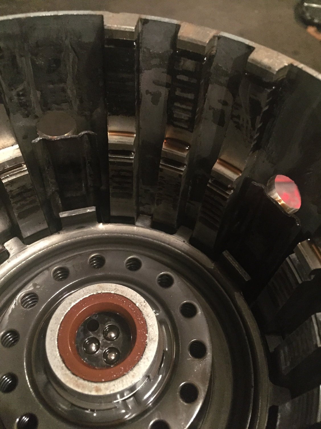

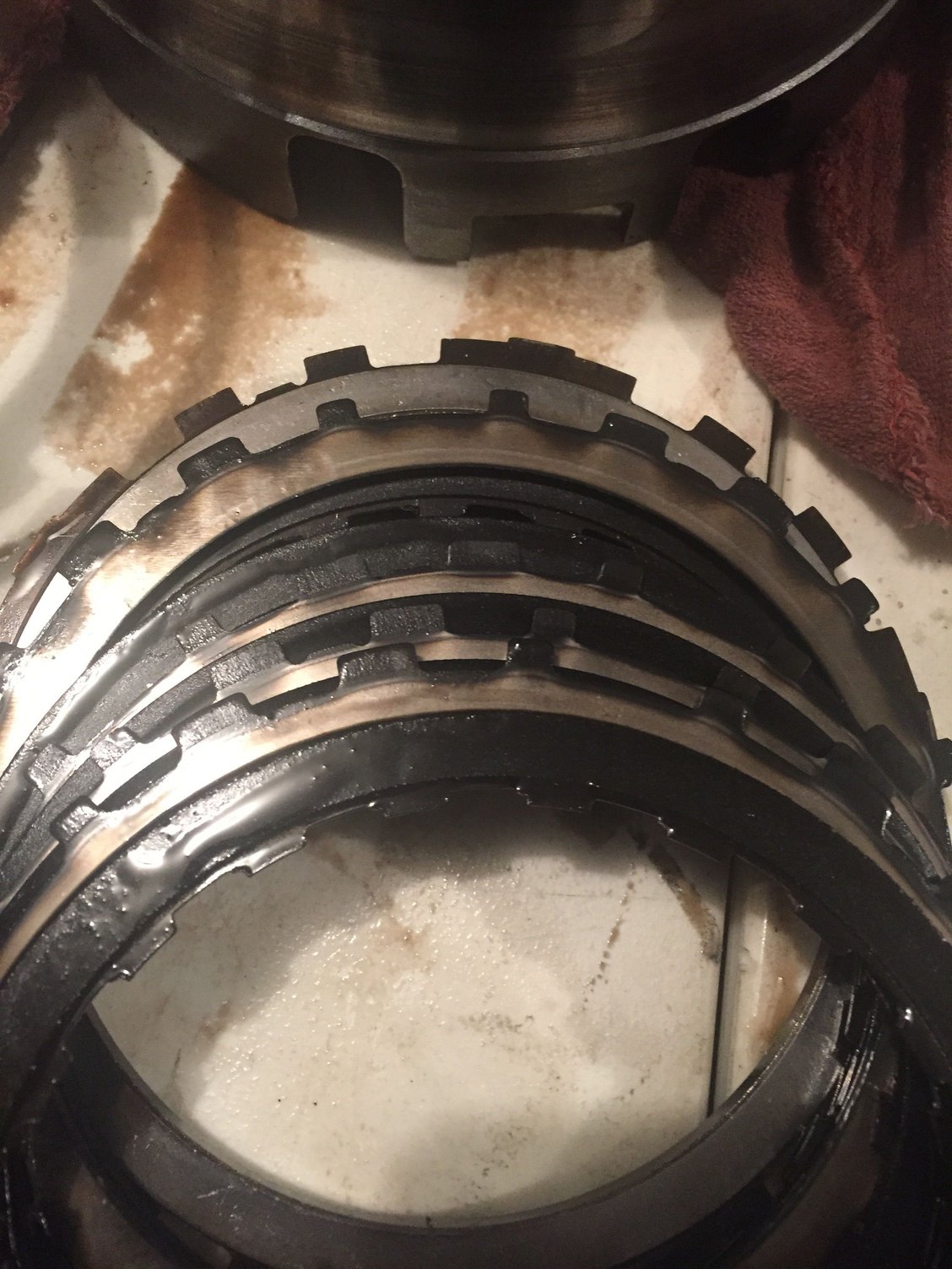

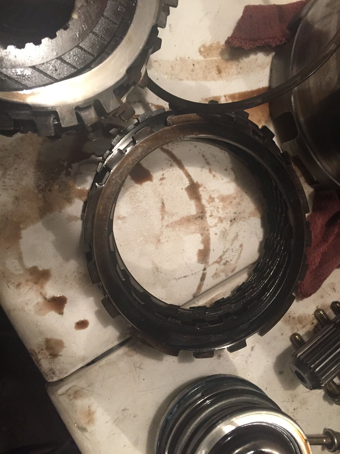

So, got another trans build going on at moment bit of sidework to help me get caught up from my old full time job (which is now my part time job) being slow and feeding the screw up..... Anyway, this is out of an 05 trailblazer, guy said its drives fine until you get on it, then it slips like a champ... No upgrades unless it needs it he just wants a stock rebuild, so not goin to get too far into it just wanted to share a few pics of what i found.....
Trash in pan no chunks
Wasted reverse input drum, gotta get new one monday
Thought input drum was galled turns out it was just caked on burnt fluid and friction material, cleaned right up....
Burnt 3/4 clutch plate
Burnt 3/4 clutch pack
Rest was pretty uneventful, nothing even close to what my original core wa just a lot of nasty *** burnt brown fluid..... I should have it just about done tomorrow, remembered the reverse input drum out of my second core doesnt even look like the band got applied to it, so i will use that one to get this one gone, dude kinda in a rush for it!!!!
