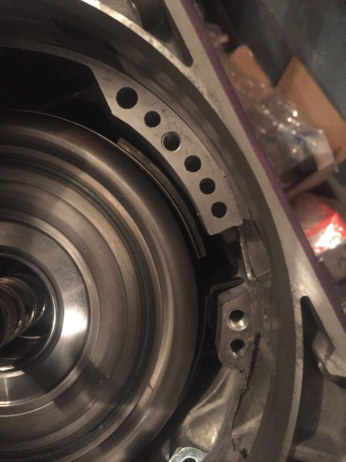

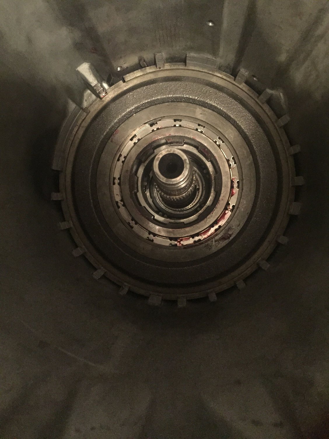

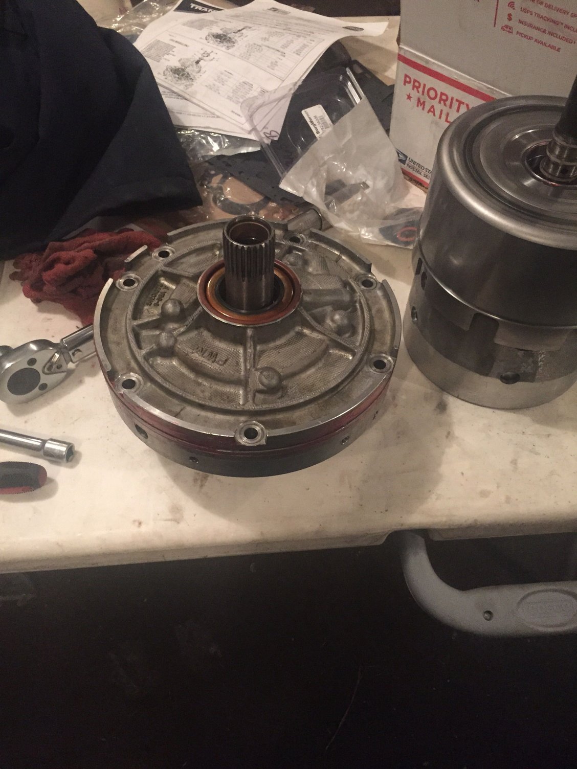

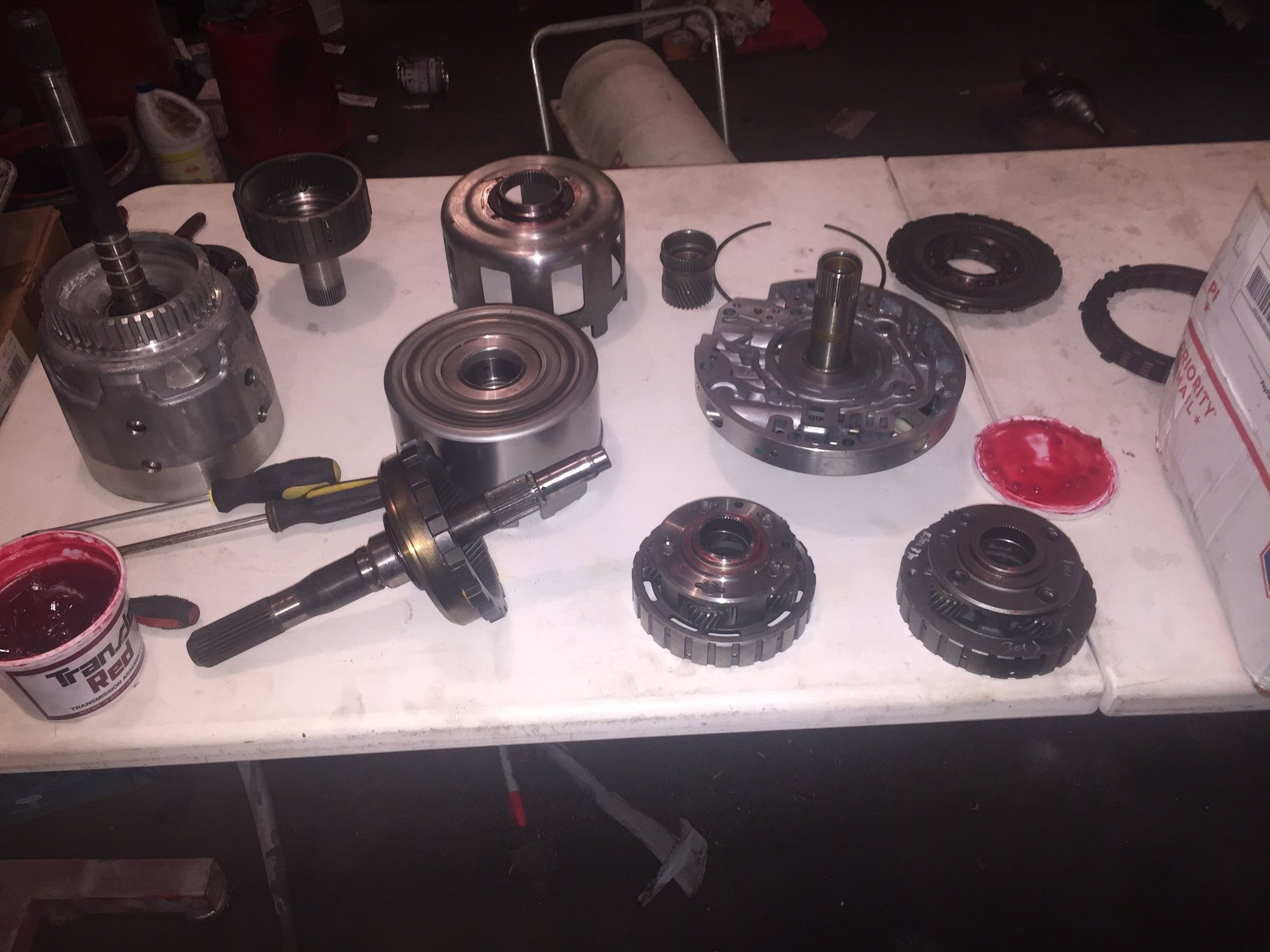

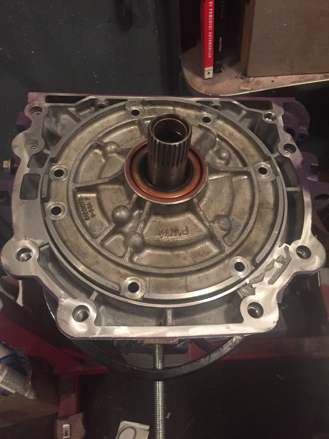

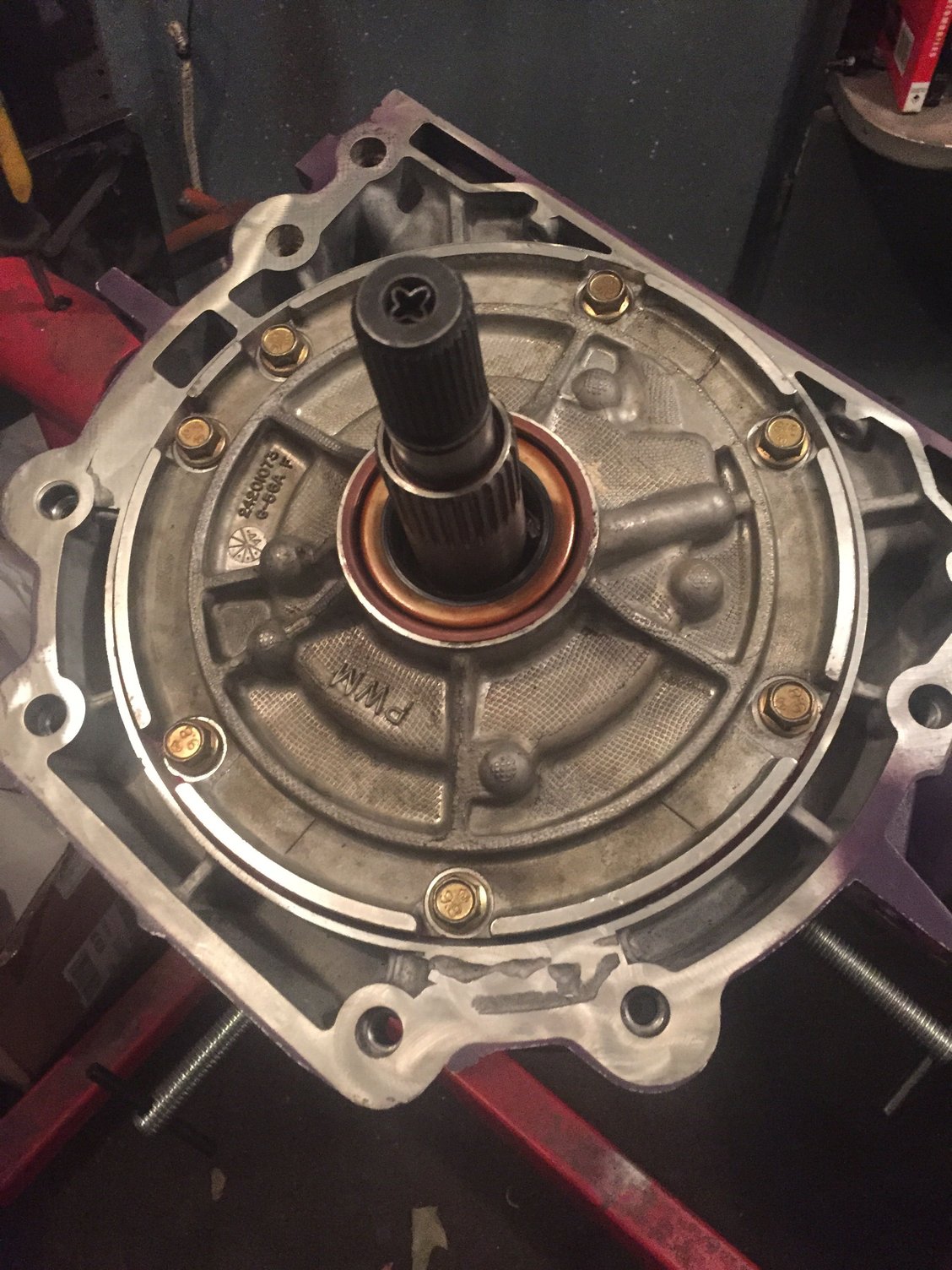

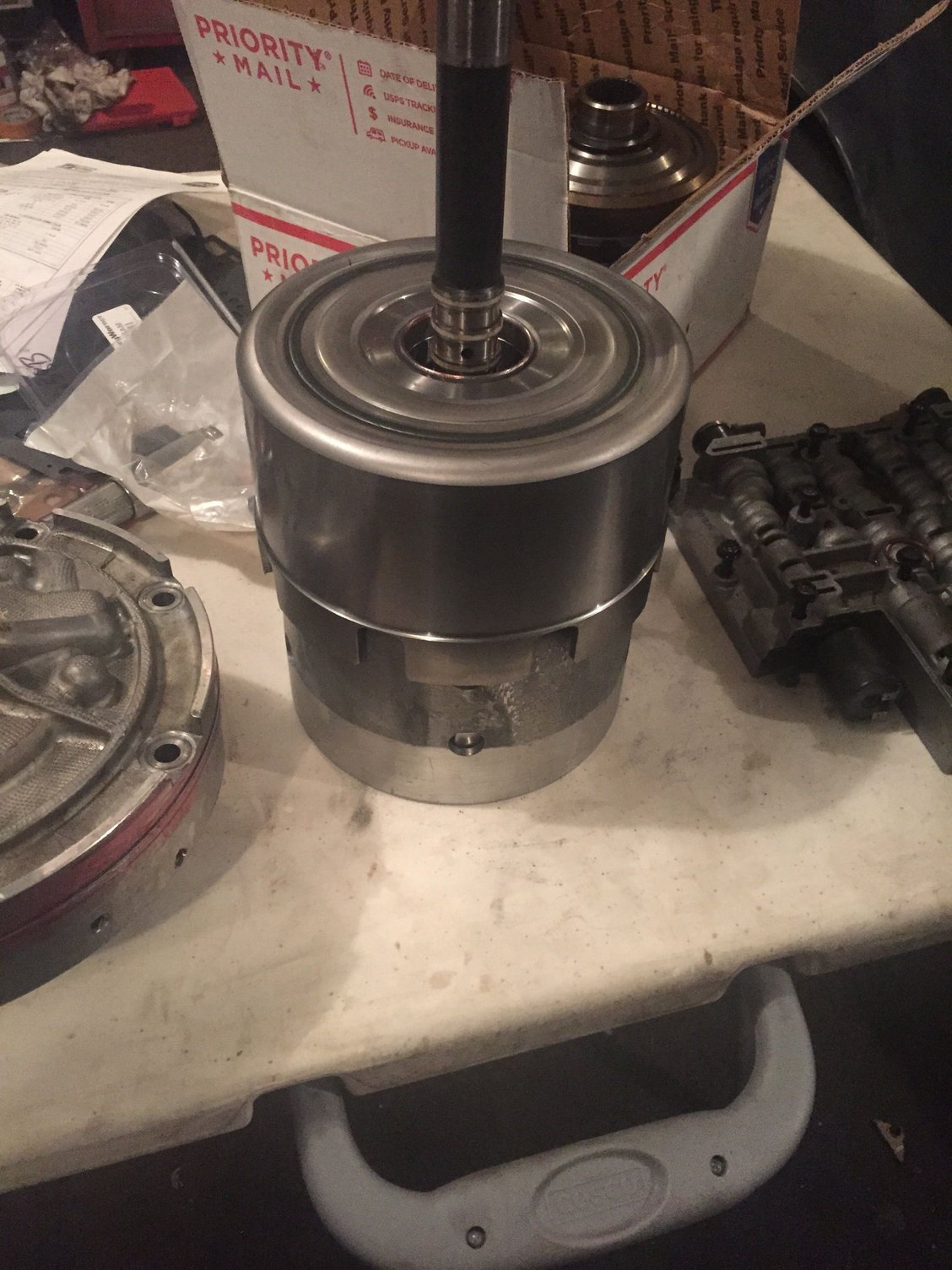

Everything back out, last time!!!

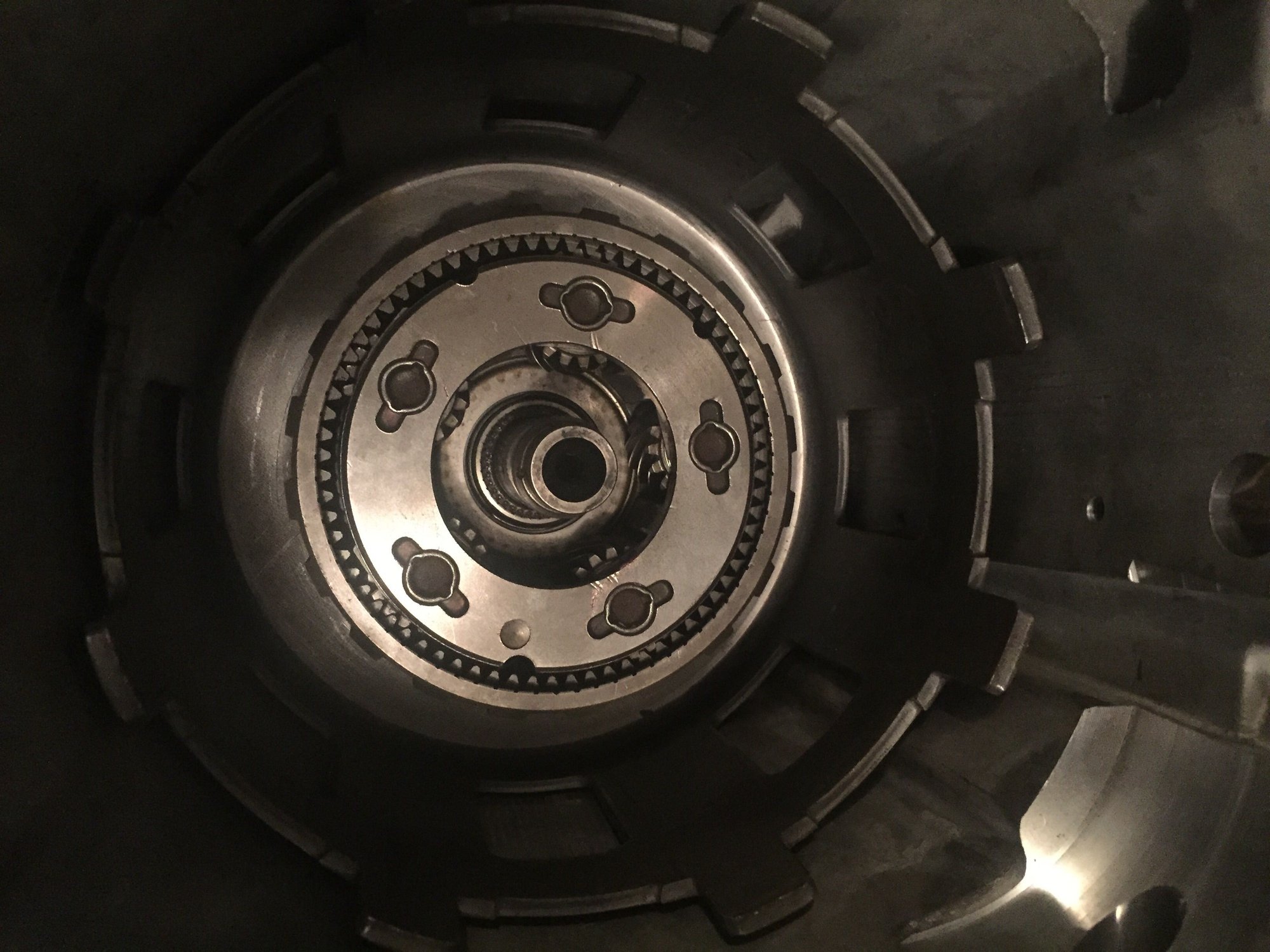

Goin back together lost pic of the rear planetary somewhere..... Oops
Front planetary...... Gm 5 pinions this time!!!!
My fancy pump alignment tool
Out of order, but.... Band in place
Input drum and reverse input drum about to go back in!!!
Pump awaiting installation

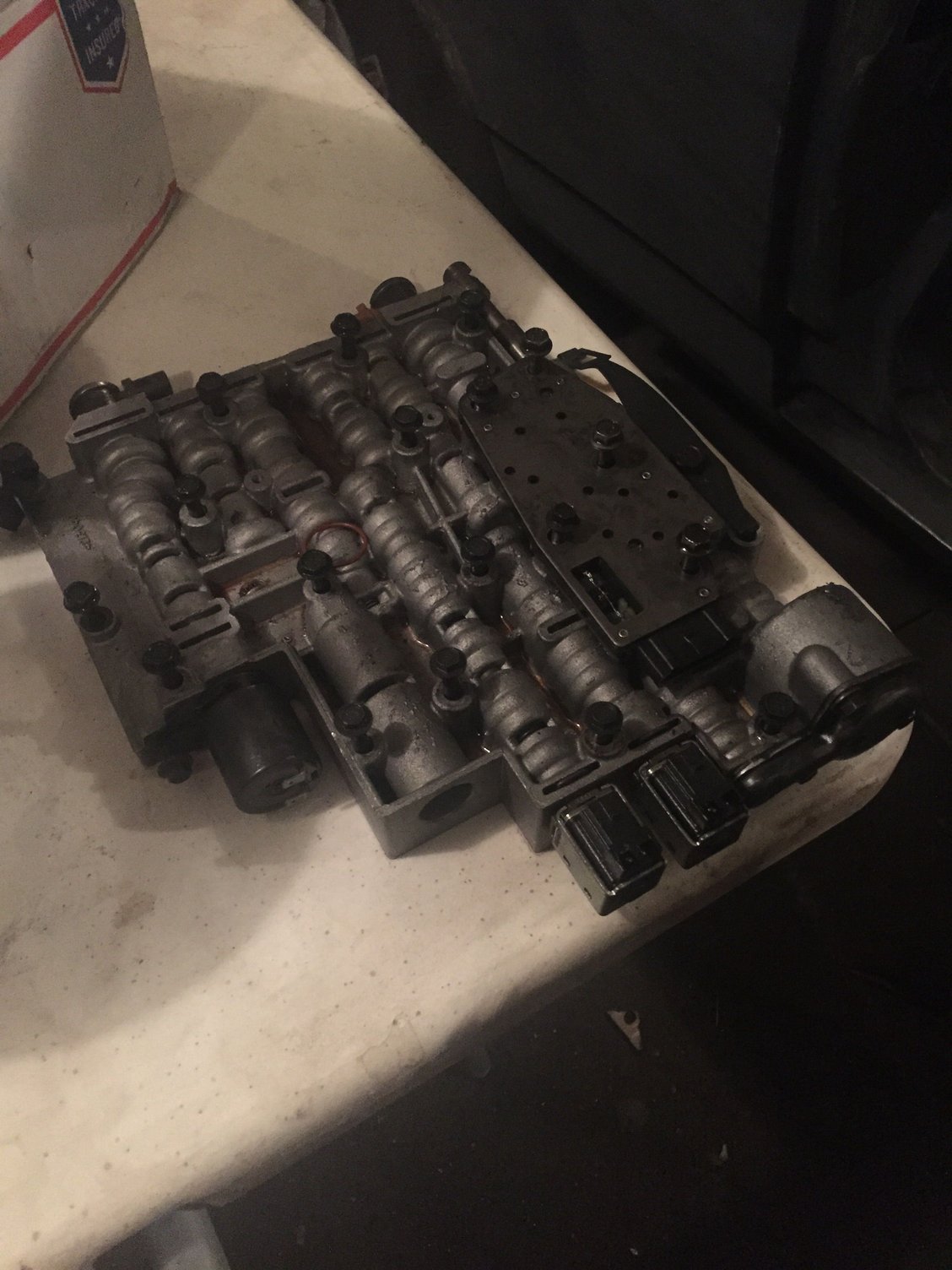

Old dirty nasty valve body...
Pump in and torqued to spec.... Best i can gather without proper $750 tool about .012-015 end play....
Ok so i got the internals back together and started TRYING to replace the 3rd accumulator capsule, with the #4 screw extractor as is recommended, but one i have bottoms out on the ball, at thsi point i am thinking long tap and slide hammer with a threaded adaptor( debt puller type slide hammer) unless someone else has a better idea!!! I am all ears at thsi point!!!!!!

Ebay for the planetaries or through your local trans parts warehouse?
I believe I used the old screw type slide hammer on mine.
