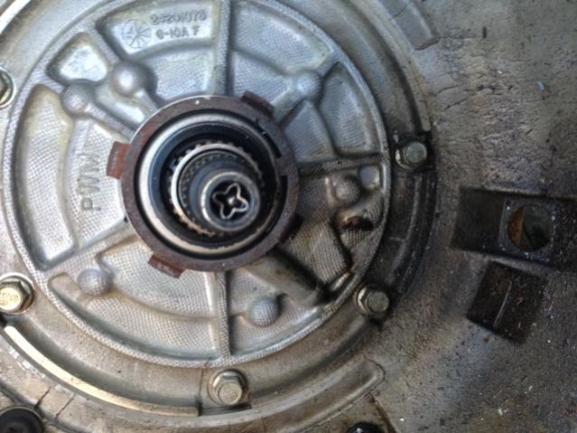

Post up a picture of the input shaft
hope those are good enough, i can make them bigger if need be.

That input shaft is not the correct one for a LS platform, to the best of my knowledge. I am not a expert but if my memory serves me correct the LS does not use the Pilot on the end. I also believe the one pictured is a 298mm and the LS is a 300mm, if any of this is incorrect then someone please correct me.

alright, so to get the input shaft switched over from the old trans to the new one, I'd have to dismantle the pump right? Or can i just switch the whole pump and shaft as one assembly over to the rebuilt one? Because i know the pump in the old trans is still good.

As mentioned the input shafts are both different. The front shaft is pressed into the direct drum so it's not just as simple as un-bolt and re-bolt back together. You would actually need to press the shaft out to swap them. If your original trans had a failure I would not recommend reusing the front drum from the failed unit with out going through it and checking your clutch packs. I would also recommend cleaning out the Lube passages in the shaft as there may be debris in there. The torque converter can also be contaminated so it would not hurt to replace it or to have it cut and cleaned so the newer trans does not fail.

Yeah, I might as well just resell the transmission since I bought it for a real good price anyways. I found a trans out of an 03 that'll have everything I need, and hold me over until I can get my current trans rebuilt to handle torque better
