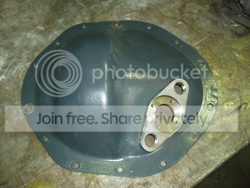

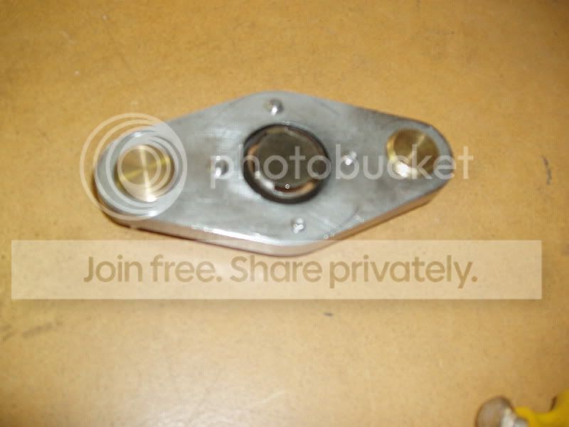

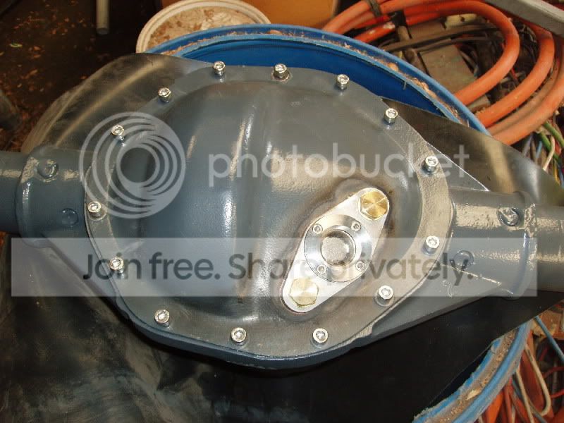

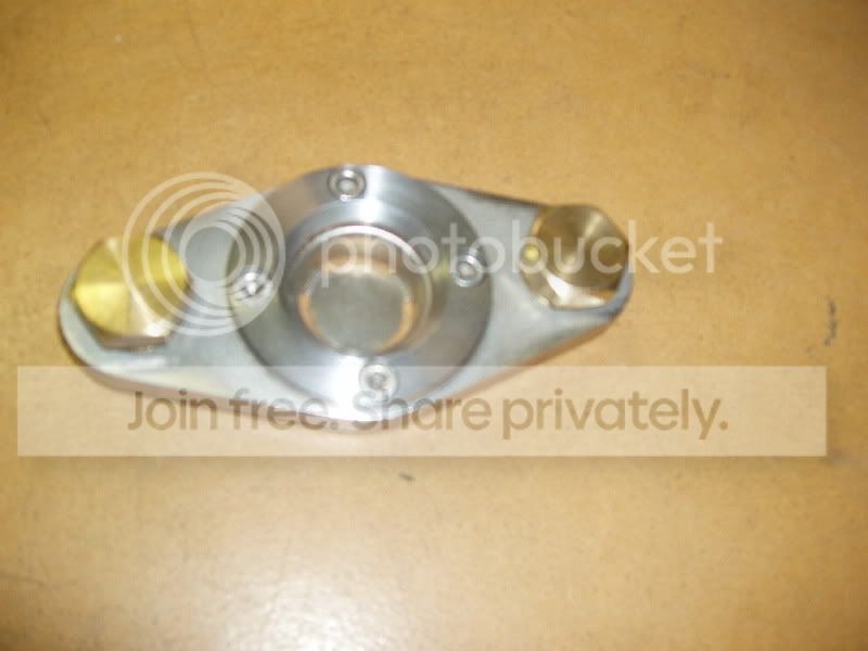

Made and welded in a stainless sight glass unit with drain and fill plug.
Finally got my 14bolt SF sandblasted and epoxy coated.
Had the drums blasted and then painted them with drum and caliper high temp paint.

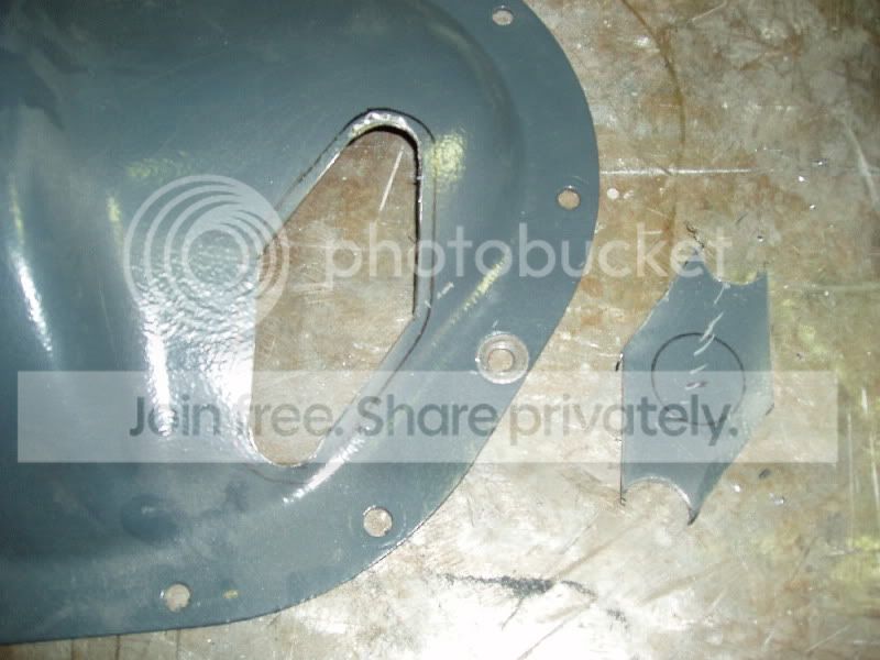

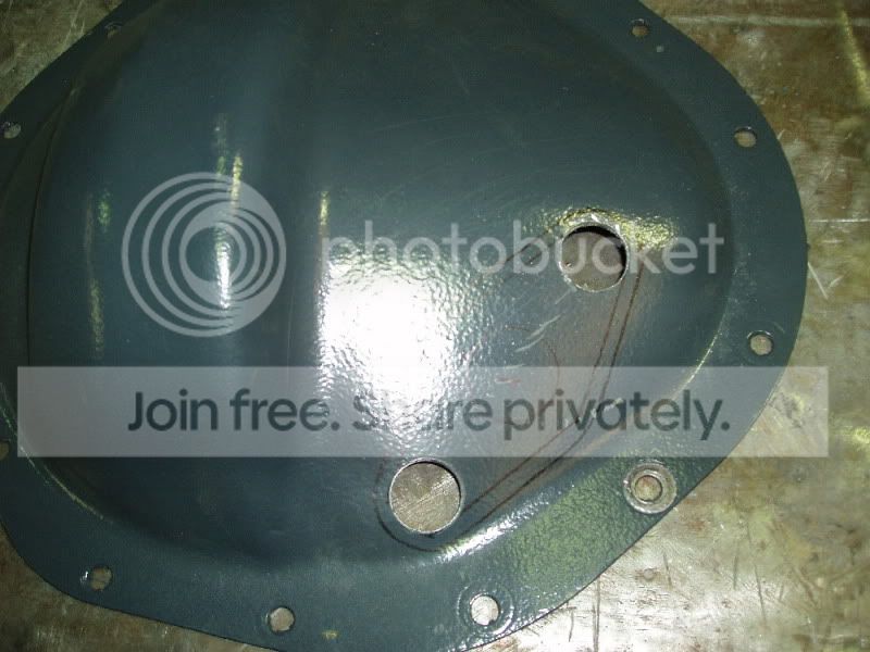

Having a stainless plate made at present which will be welded into the cover. It'll contain fill, drain plugs along with a sight glass.

Got the plate welded in and tested for leaks (using CRC....any pin hole in a weld...CRC will find it).
Now need to get the cover re-epoxied.
