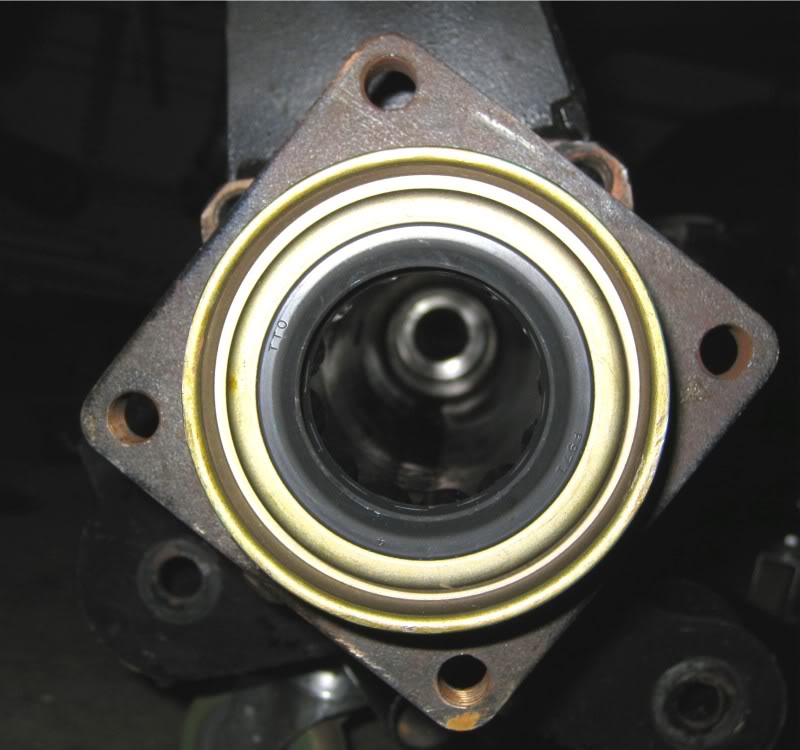

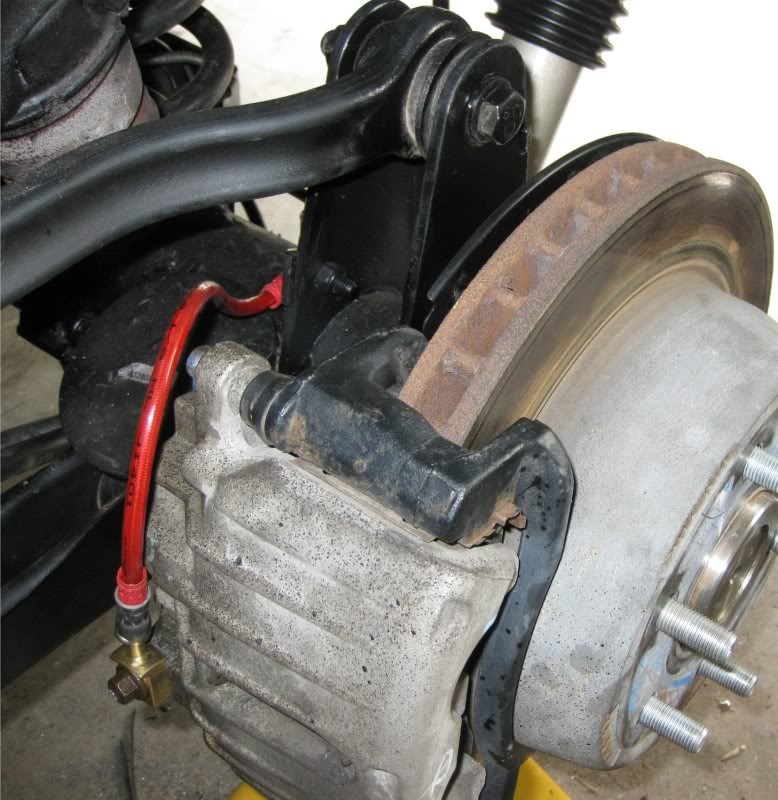

Although I will likely upgrade, my OE 13" rotors and dual piston calipers are bolted to my custom 9.5 14 bolt for now. Of course I drilled and tapped the mounting flanges exactly the same as the original OE 8.6 rear. Not sure if the flanges on the newer 14 bolt shafts will fit inside your OE rotors without machining. I would think they would just bolt up as the new ones are designed for even smaller disc brakes. I think mine were cut down a little, but they were designed for a drum setup. I have a set of Yukons in there now. Not even sure if the newer 9.5's use the same size shafts as the older ones.

It will bolt up fine, the holes on the mounting flange on the axle are the same size and pitch as the 10b. The only difference between the single pistion and the dual piston is the rotor is slightly wider for the dual piston.
