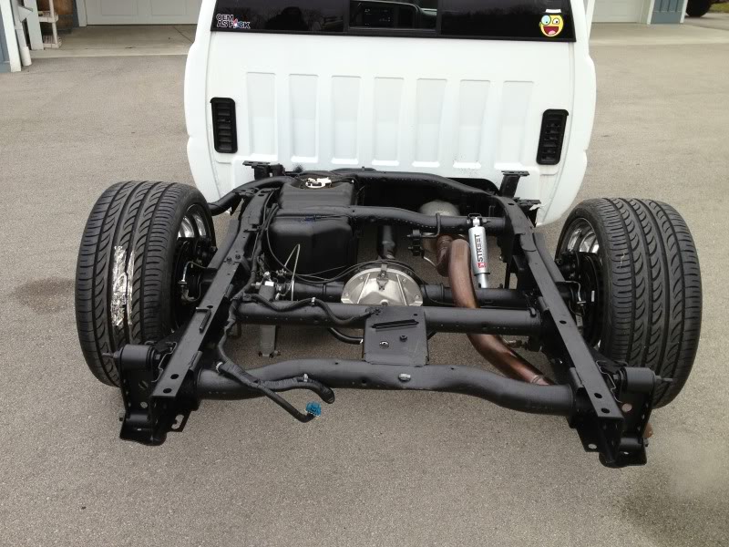

I can comment on rear diff.
You are building what I have, except mine was 5" overall cut. I have Yukon Gears, They make some noise, but the whole trucks a bit of a noise maker so I don't mind. I dont drag race my truck, but I do beat the hell out of it when i drive it
Diffs are the same width

Damn that looks nice! Yeah mine will be 4" total, forgot to put 2" each side. You running 4.10s? Have you done the 4l80e swap? After I did was when I realized how much I hate the 3.42s lol.

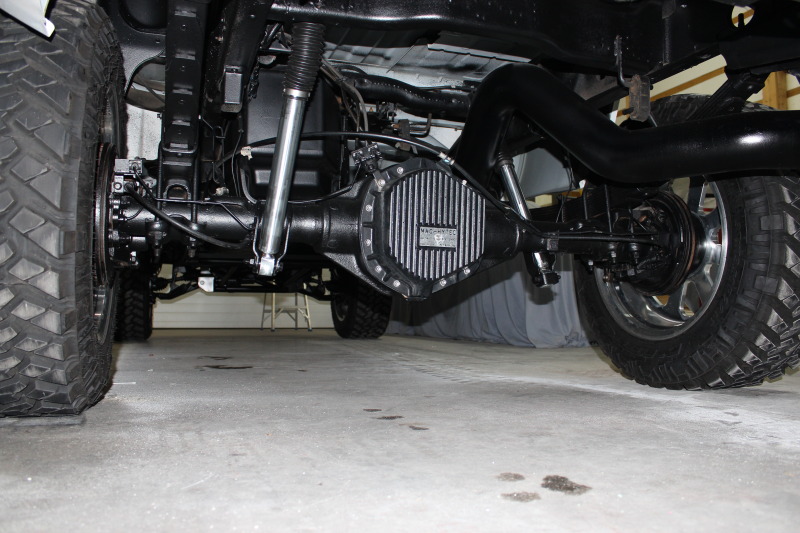

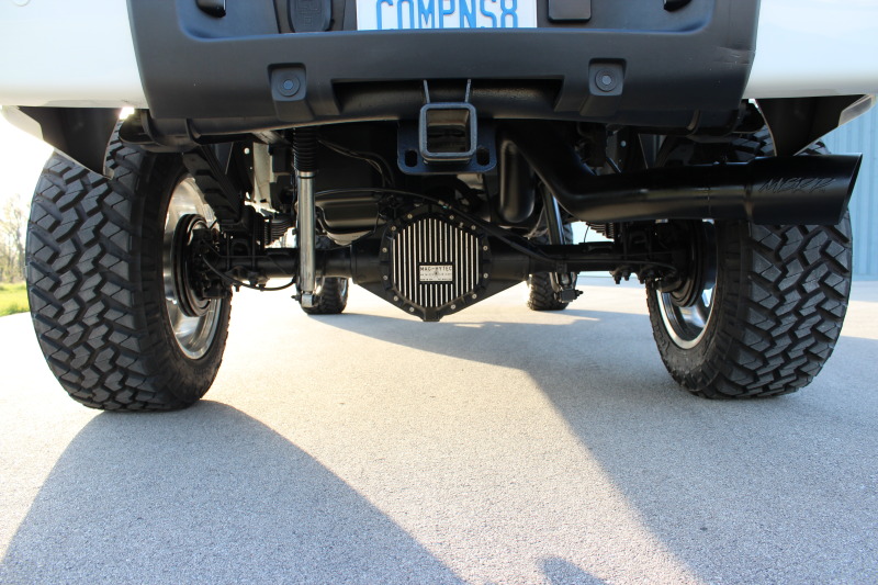

my lmm had the same treatment
