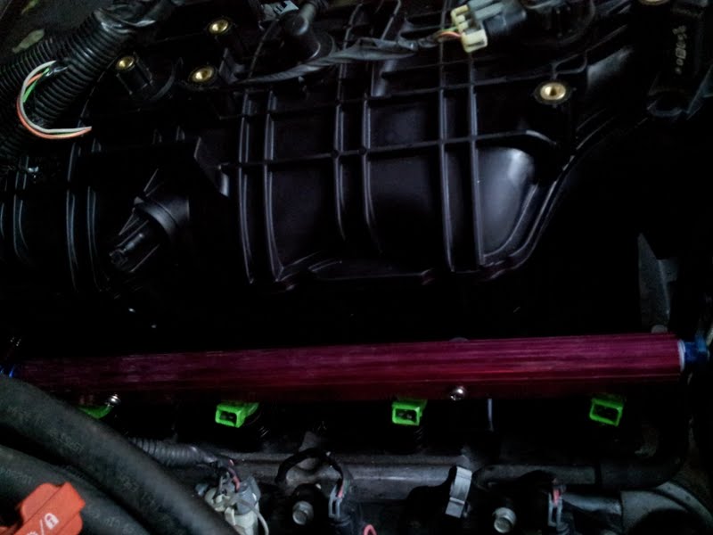

I got a new tbss intake that is going on my 05 silverado. I also got a new set of fuel rail from summit racing but they were for ls2. Now that i installed it it is leaking gas from the top of the injecter where it connects to the fuel rail. And it is not only one leaking its all. What did i do wrong.

Did you put some vasoline on the orings prior to installing the rails? How did you attach the rails to the intake. Post up some pics

Default pic
sorry only got one it started raining try to get some in the morning

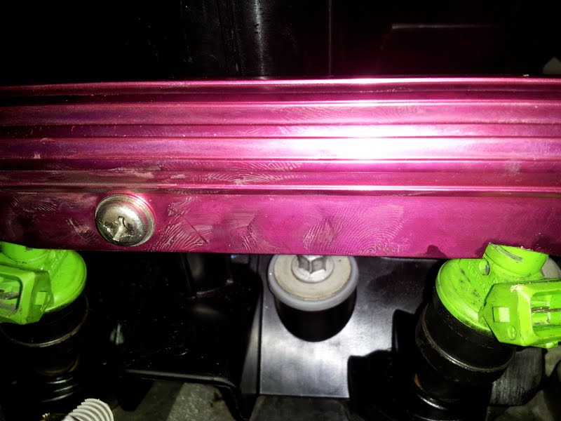

Default pics

They dont look completely seated..... Are the injectors to short for your mounts?
