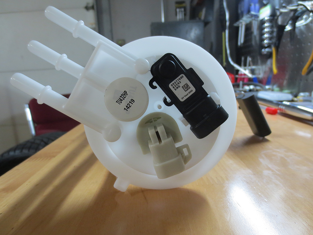

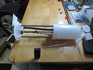

Not sure why you want to convert to a return system. The returnless system regulates the pressure at the pump making everything much simpler with less parts and less $$$. If you're set on making a return system you'll need a return type fuel pump. I just did a Walbro 255lph (drop in) return type pump. You can see it has the connections for supply, return and EVAP.
TU432HP-2
