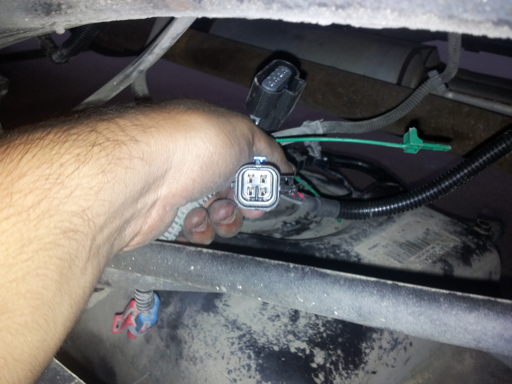

The hot wire kit is connected to the pump, and this connector(picture) was suppose to plug in to the factory connector, but had different bulk heads so I took off the pins and matched them to the factory connector. It worked last night when I tried to prime it but left it as is to continue this morning to mount the tank and I gave it another try before I reassembled everything but now its not working. I checked to see if the pump unplugged from the intank(no) and every single fuse, switched relays and still no. The thing that really has me questioned is why my truck doesn't crank.
Removed the pins and matched them to the factory connectors off this plug.
