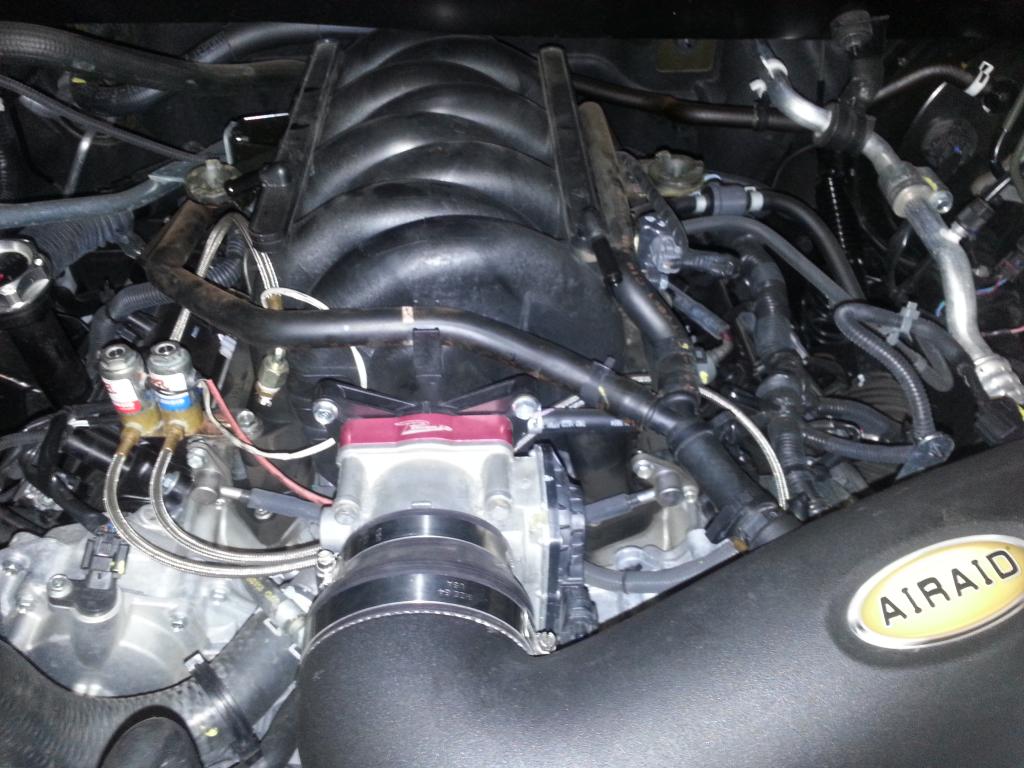

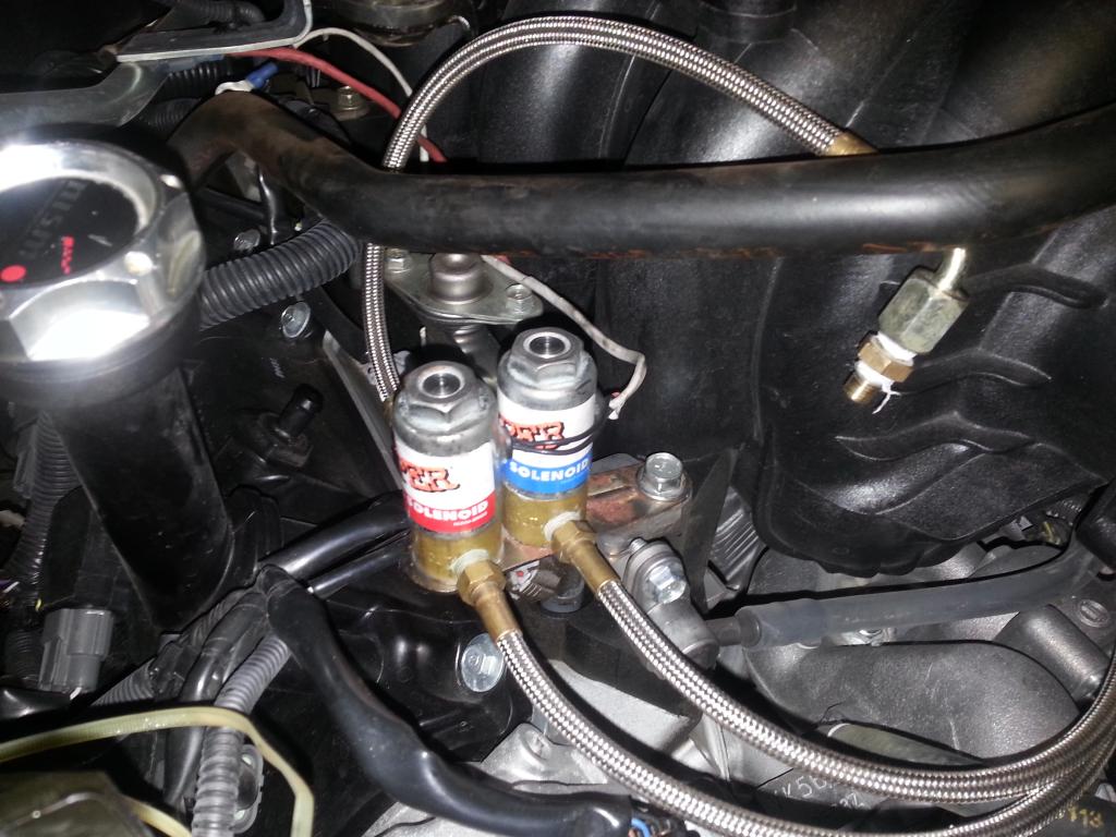

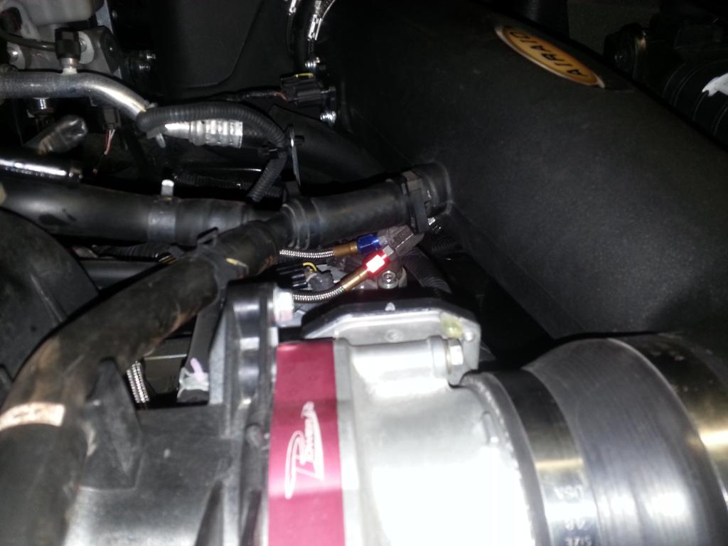

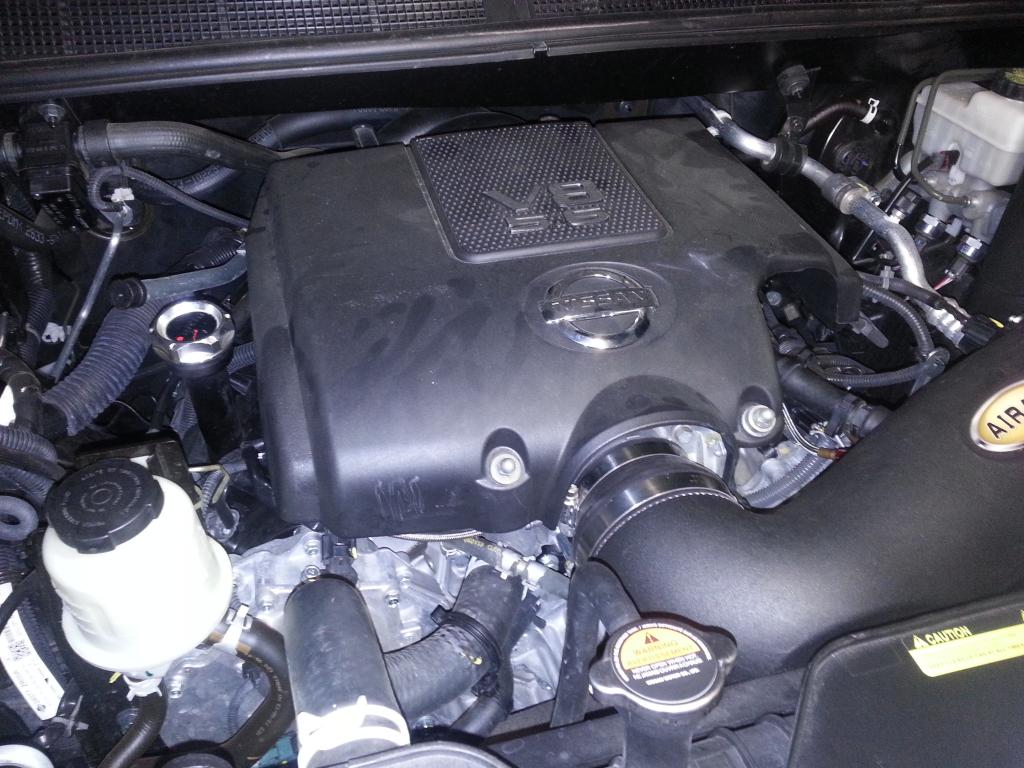

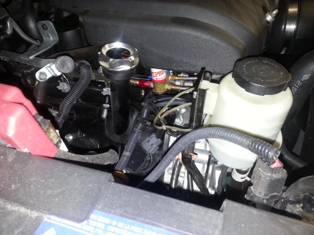

I had it on a Dynojet this morning. Put down 332 HP / 388 TQ N/A. On the 75 shot, put down 399 HP / 515 TQ on a richly jetted tune with 2* of timing removed from 3,000-6,000 rpm. Using a window switch that kicks on a 2,800 rpm and off at 5,400. Will be installing a transgo kit and colder plugs soon so I can try the 100+ hp pills. Last track outing running N/A was a 9.20 @ 74 on a 2.02s 60' time in 1,800 DA. I expect to pickup atleast 1/2 second on the 75 shot. Traction in my 5,800 lbs 4x4 beast with 305/50R20s on all 4 is not really a problem at the track.

When I took the pictures I had not yet mounted the lines or tank and had to install the new fuel pressure adapter.
